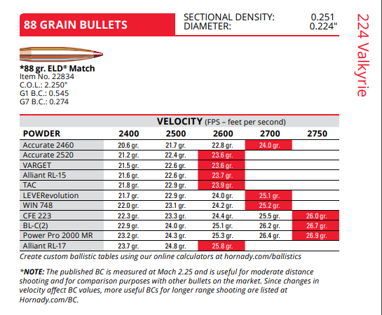

I just shot factory hornady eld match 88 and federal 90 today in a brand new MPA 224ba. The hornady is about 0.5 moa at 100 yard, 3 different 5 shot groups. The federal shot weird. 3 rounds at 0.2” group then the next two expanded group to 1.5”. I don’t like to call them flyers — every shot counts, just like in a match. MV on the hornady was a little over 2700, federal 90 had a wide range from 2680 - 2780. The MV on the federal had no direct correlation with the POI.
I got rid of all my Federal and switched to Hornady. My groups are all under .5 MOA now! Federal still has a huge issue!
