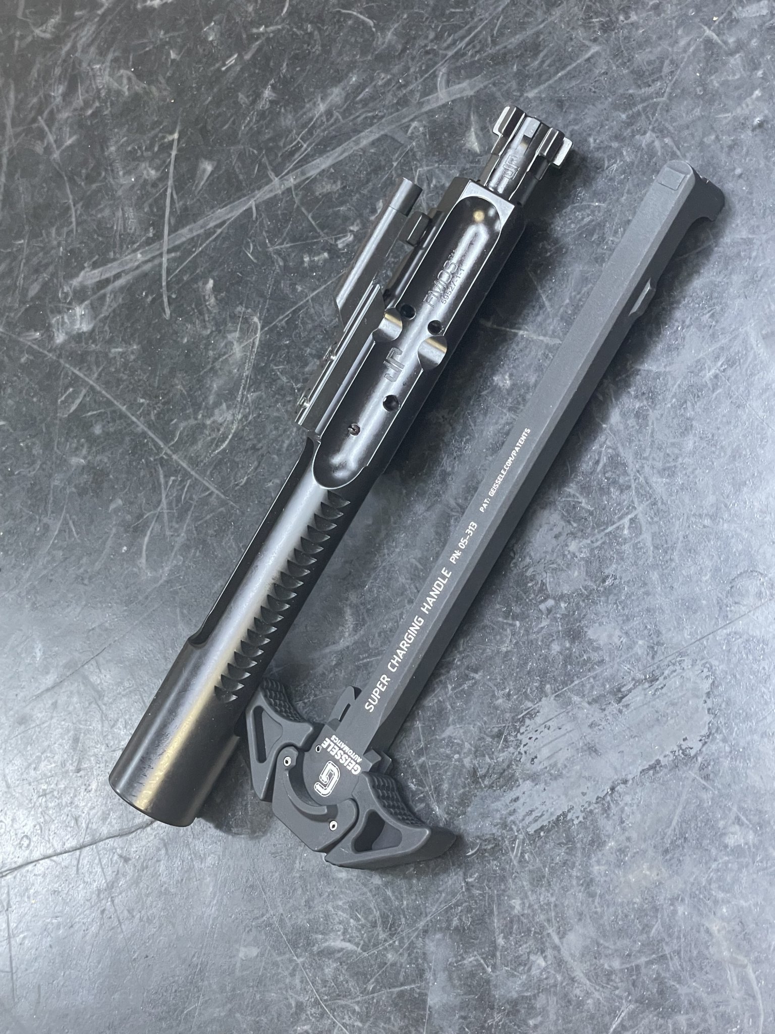

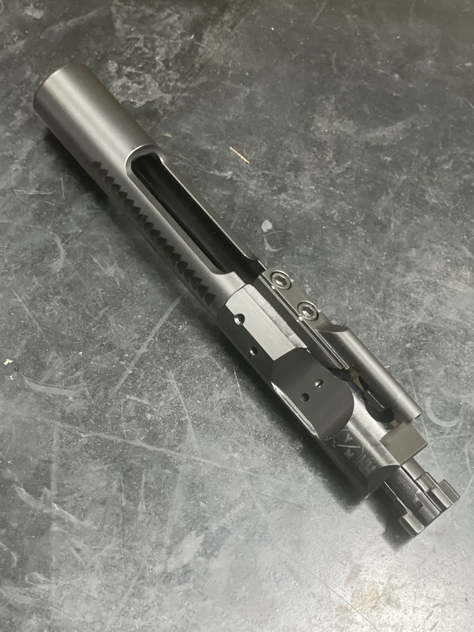

The old Young National Match bolt carrier was literally fantastic - Forged, then centerless ground, then chrome plated. Not being inclined to stop there, I've been sending them to Ionbond for DLC coating since 2004:
Wish they still made them like that! Yes, that's a JP bolt in there, also now Ionbond DLC coated, saving me that step.
The Young N/M bolt carrier outside diameter is the largest I've encountered. They never would work in all uppers. The JP FMOS bolt carriers - currently the best available, I believe - is a close second in outside diameter:
