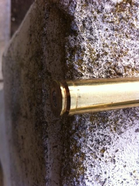

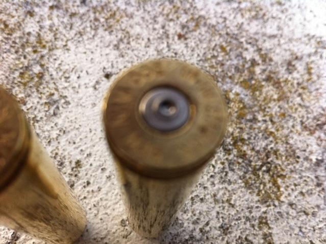

I got some pics with my phone this was HMR factory with 190 gr SMK HPBTs

Buy a .30 cal Unithroater from PTG and you can fix in 30 seconds. I wouldn't send a belted magnum back to Remington. Number one, if you send it to a repair center like Sport's World in Tulsa you won't get your gun back for a dog's age. Number two, when they do repair it they don't test fire it...so how can they know they fixed your problem? Half of all new belted magnums do this...including the 2010 when fired with 220 smk's.
I appreciate your assistance, please excuse my ignorance, but what is a Unithroater. Would you care to explain what you believe the problem is?
Huang
That sounds logical, it got worse with the 190gr HPBT but the 180 Federal HydroShock loads did the same thing. Would a short throat cause brass shavings to be inside the bolt face too. You know what sucks is this rifle was a safe queen for about four years ( never again) now it's prime desert season I am faced with Remington taking forever to possibly fix the problem or popping for at least $100 to make it right myself. You can tell by my questions I'm new to a lot of this.
Brass in the bolt face is either the extractor or improper headspace...
Bullet grip should not be enough to shave brass off the head.
Checking the headspace takes only 5 seconds if you have the gauges...and should be pretty cheap to get a smith to do it if you don't.
