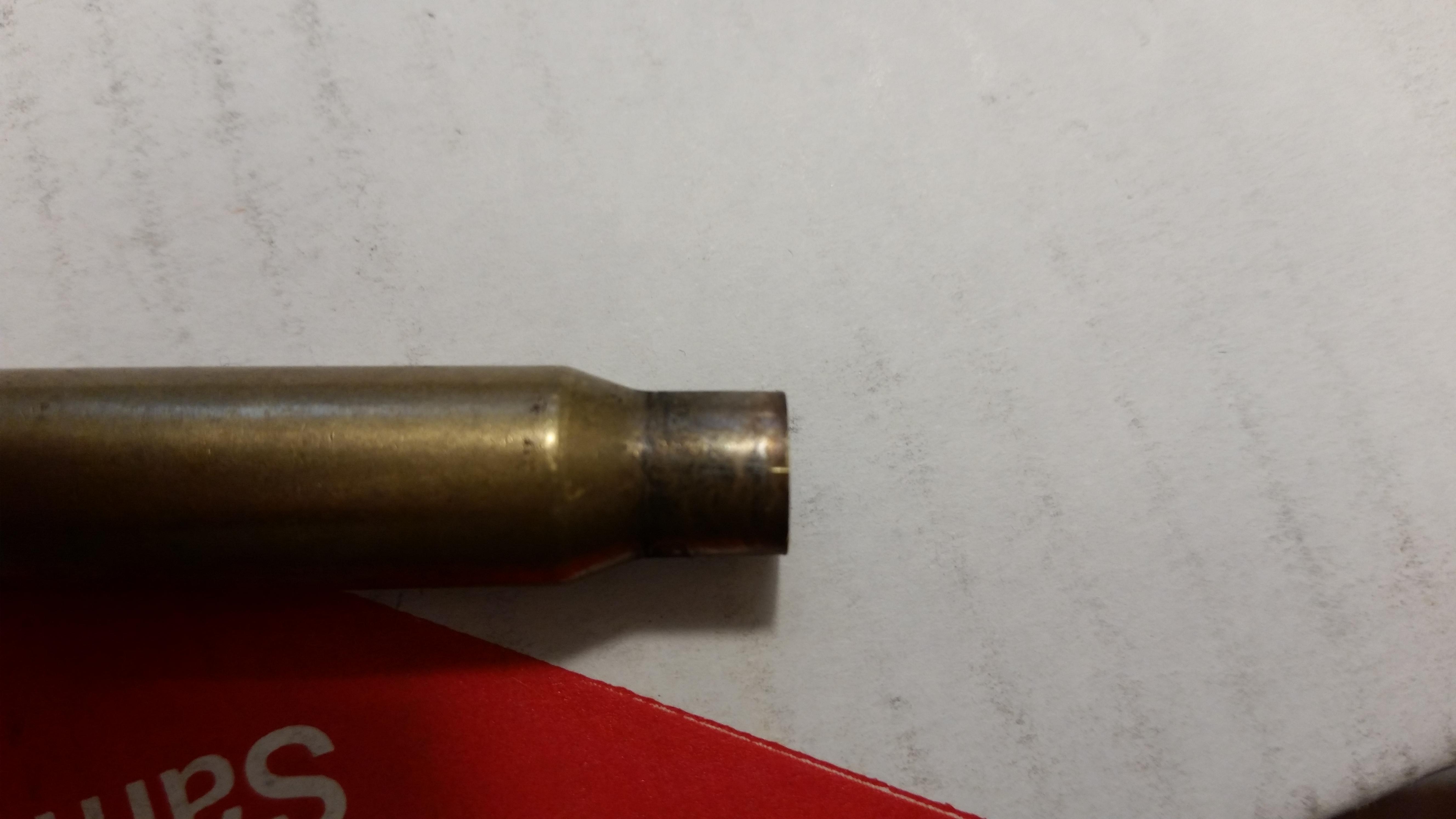

I recently purchased a brand new Remington 700P, in 308. After >100 shots I began having issues with the bolt extracting properly. The bolt would remain stuck in the chamber and wouldn't slide out to eject the spent brass. I tried to see if perhaps it was just that round, but have continued to have issues with the rifle since. This issue seems to only happen with rounds that have been fired, unfired rounds, seem to extract out perfectly fine. I have tried putting fired brass back into the chamber to test, and have a hell of a time trying to get it to extract back out. For some of the tries I had to get a rubber mallet to knock the bolt back to get it to eject the brass again. Just a note, I have tried 2 different types of brass, and both seem to have the same issues. IMI match brass, and also Lake City Military Brass.
I have already sent the rifle back to Remington for repair once for this issue, and will be sending it back again since my rifle is affected by the current trigger recall. After the first "repair," it was said that my extractor was replaced, headspace was checked, and then fired for function test. Since getting it back I was able to take it to the range once. The problem seems to still persist. Not with every round, but there were some that were difficult to extract. It was an improvement over what happened when the problem first started, but for a brand new gun I really don't think that it should be having these issues. I had a buddy look it over and he said it might have something to do with my lugs, almost as if the lugs don't seem to clear the recesses on the receiver, thus being unable to retract the bolt to remove the round. I am really in the dark hear, I don't know much about bolt actions, considering this is my first one. If anyone has advice, or can clue me into what the problem may be, please let me know, it would be much appreciated. Thank you!

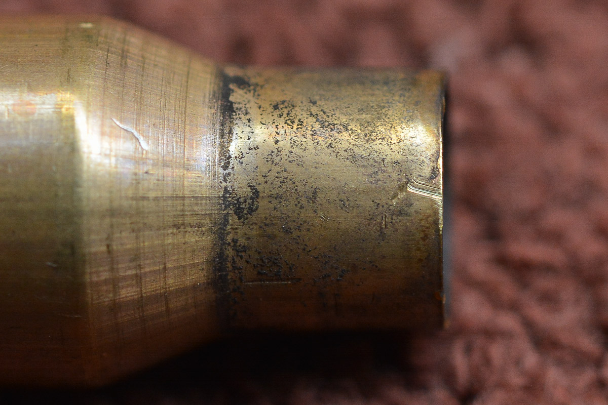

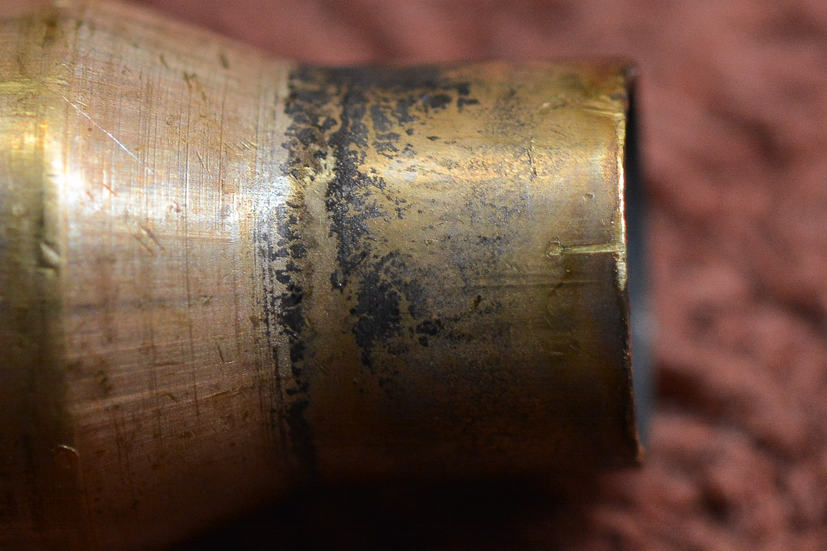

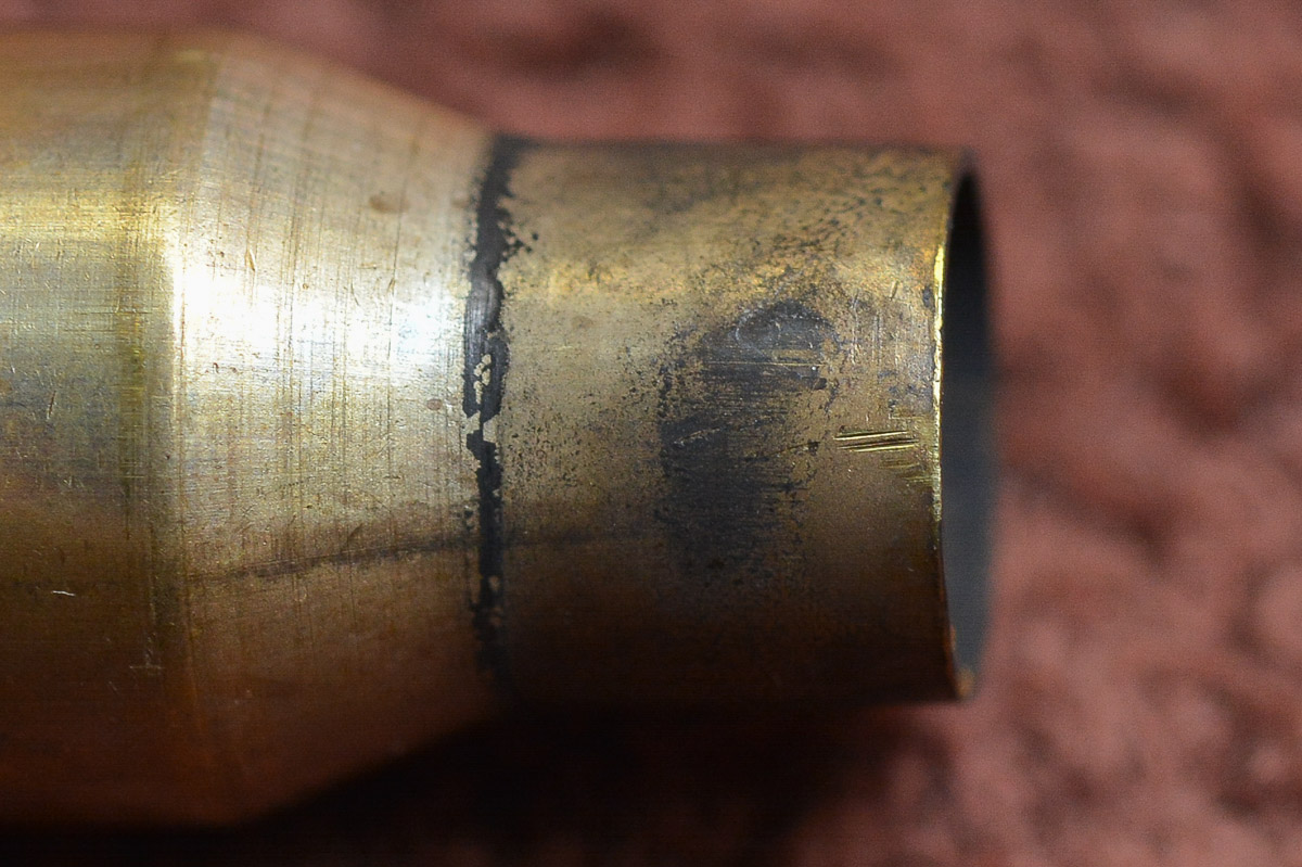

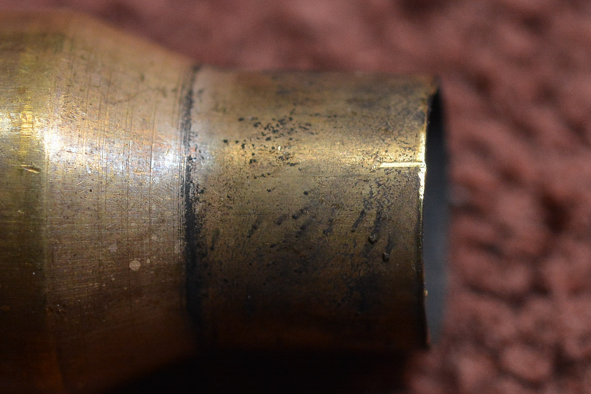

One thing I have noticed is that more than half of my fired cases have a small gouge mark (maybe 0.050" long) at the end of the neck. There's also a small "bevel" scraped onto the very front of the neck. See the photos below for examples.
If I do a controlled extraction, the gouge mark always shows up at the 3 o'clock position (i.e. towards the ejection port).
I'm using once-fired Lake City brass and I've noticed that it is a bit long -- typically 1.756-1.758" vs. a book maximum of 1.760 and a trim-to length of 1.750.
I've inserted some virgin Lapua cases (OAL 1.748") into the chamber and they came out gouged as well, though not as deeply. Haven't fired any of these yet, though, so I can't say if they also have extraction problems.

Rem_5R_223_Extraction_Problem.DSC_0817.jpg Rem_5R_223_Extraction_Problem.DSC_0818.jpg Rem_5R_223_Extraction_Problem.DSC_0822.jpg Rem_5R_223_Extraction_Problem.DSC_0825.jpg
Actually, now that you mention it, I have noticed similar gouging marks in some of my brass. I'll try to get some pictures when I get home later. Not quite as obvious as from your pictures but it is there on a few of the cases. Hopefully I can get to the range again soon, I plan to try testing with factory ammunition, to see if I get similar results. I am pretty sure my loads were in spec and also well below maximum. Plus the IMI brass that was loaded was done by my uncle who shoots competition, and I'm pretty sure he knew what he was doing when making the loads. All of the loads both his and mine should have been below specs because I was just trying to fire-form the brass for creating a custom load for the rifle. Thanks again for the any suggestions or advice anyone can provide.

View attachment 38177 View attachment 38178 View attachment 38179 View attachment 38180

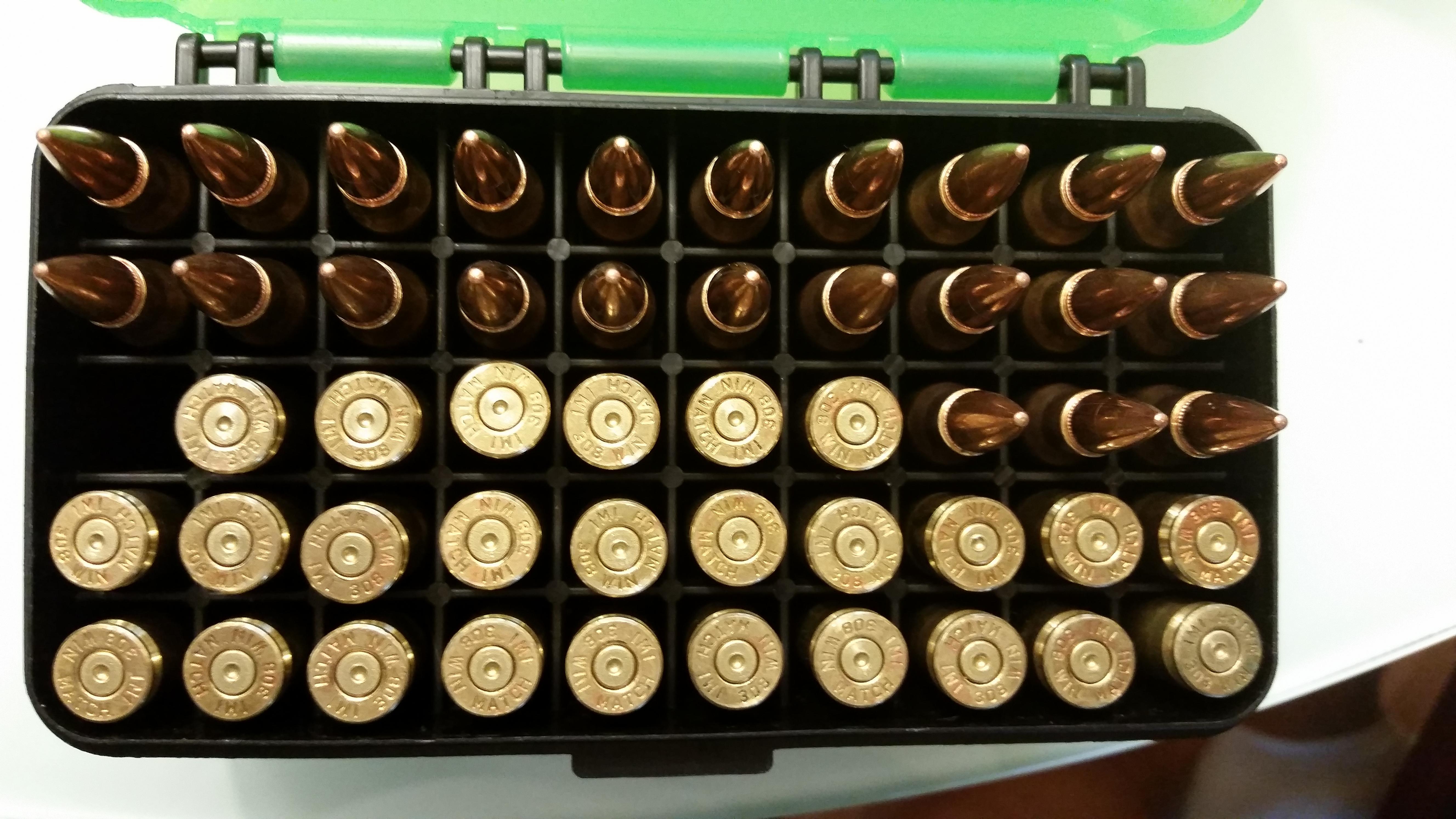

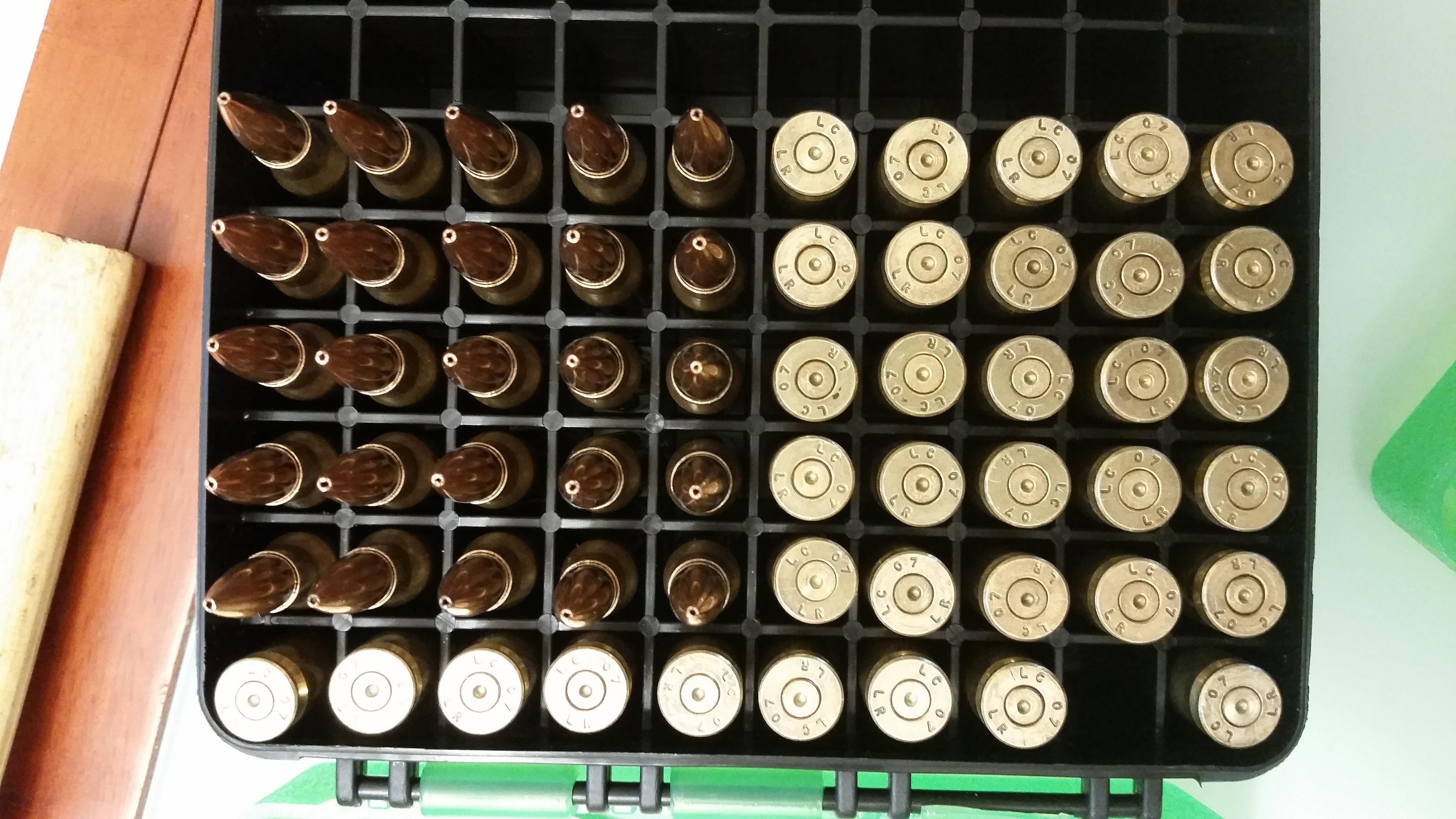

Bullet & weight: 175 grain sierra match kings
Powder & charge IMR 4064 ranging from 41 - 42.5 gr (.3 increments)
Case: IMI 308 Win Match, Lake City LR 07
Case length: 2.005"
Cartridge length: 2.800-2.801
Primer: Winchester Rifle
Primer depth: .01 from flush
Minimum & maximum times case has been fired: twice fired

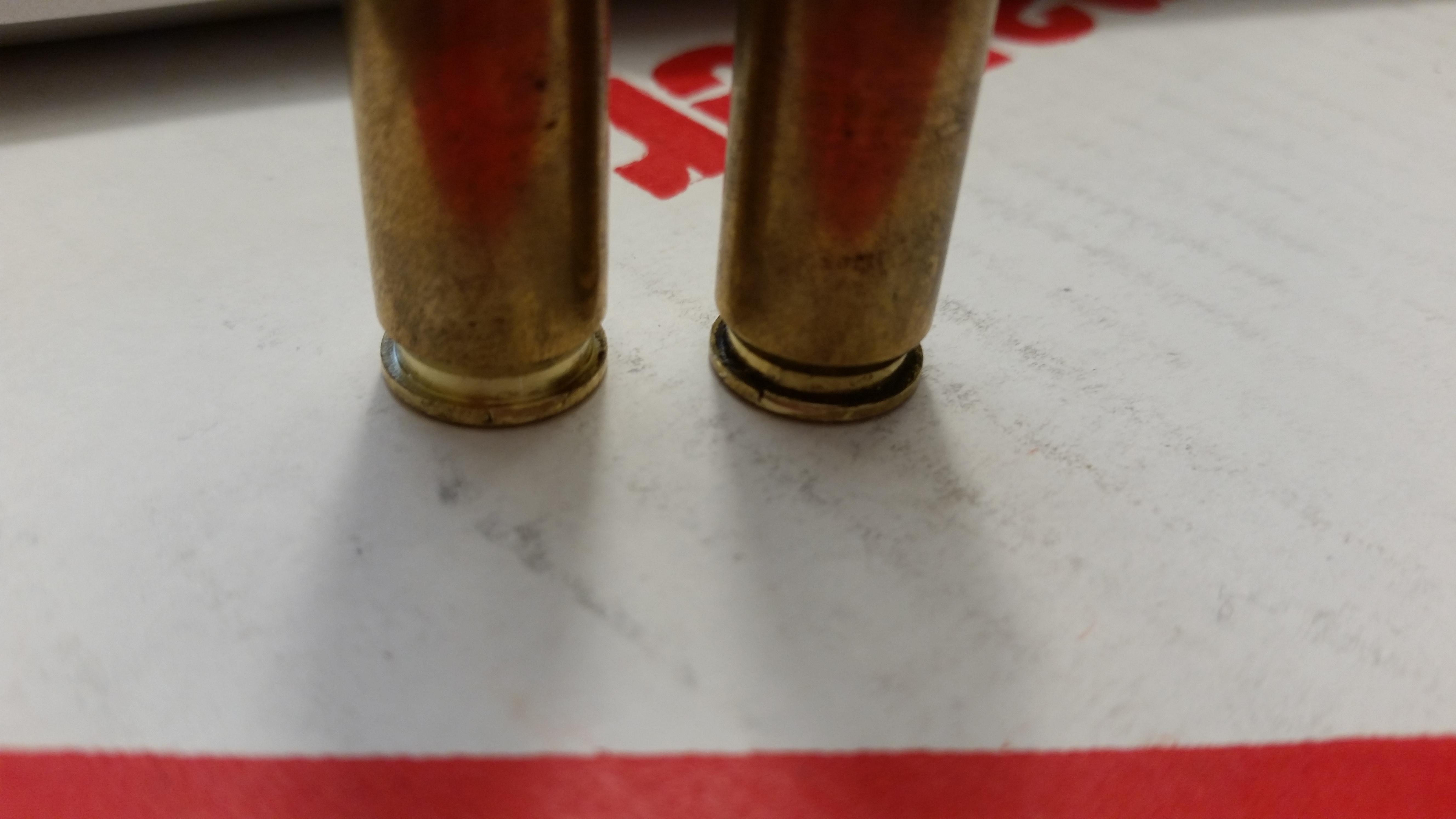

If you notice on the pictures, the one with the 2 brass cases side by side. There is a small scouring or gouge mark on each of the cases. For both these cases, they failed to extract out of the chamber even when I was able to pull the bolt back. I had to take a barrel rod to physically, poke out the brass casing from the chamber
