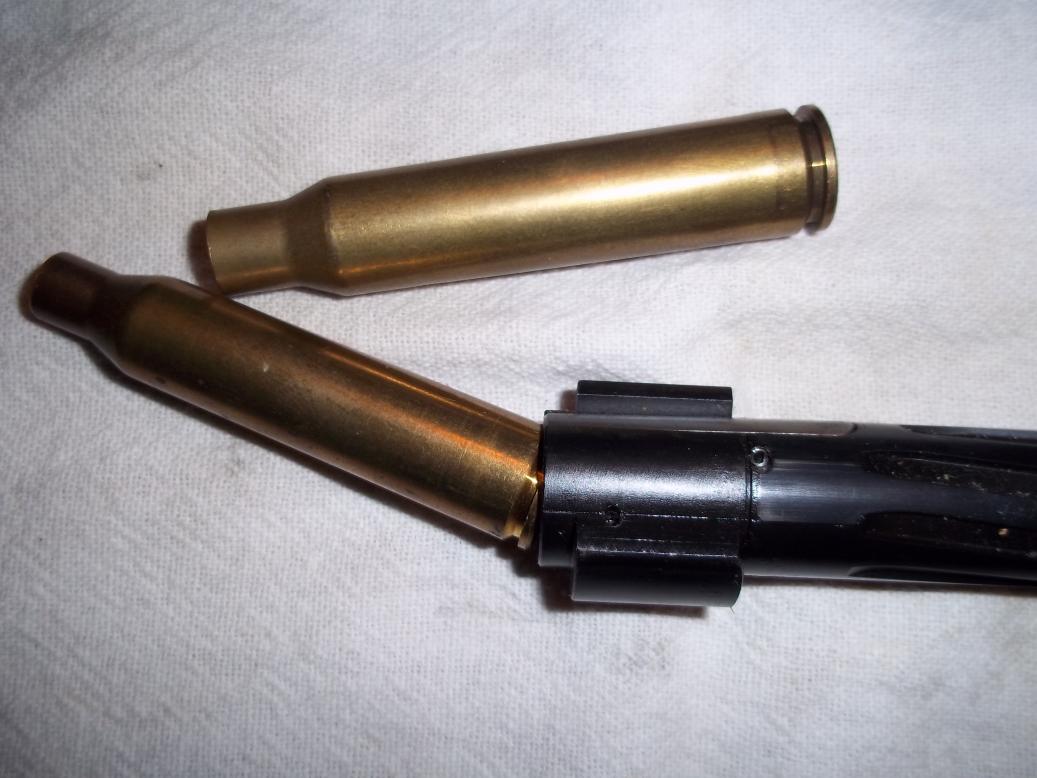

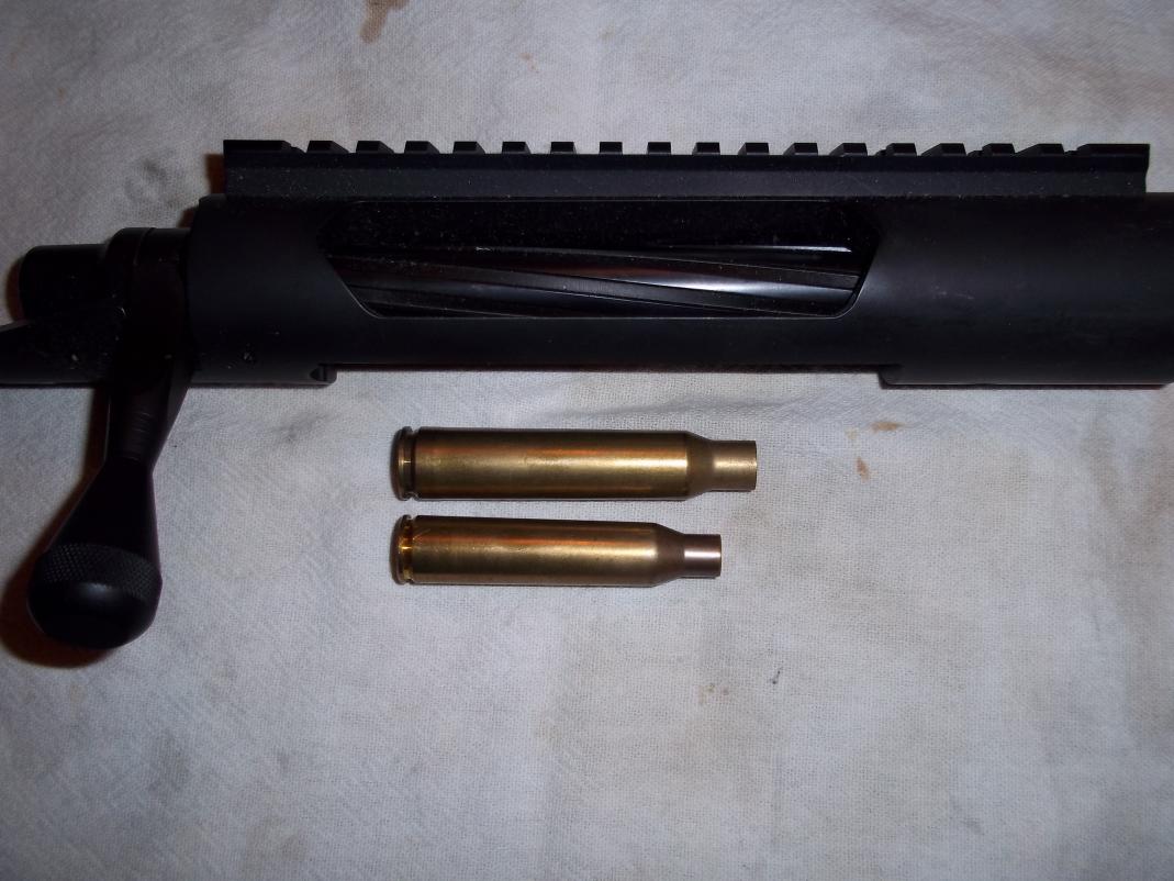

I have a Tac-408 action sitting here and after reading your post I decided to try it out.
The 408 case appears way larger to the naked eye but once I put a 338 Lapua case into the bolt it fit quite nicely and didn't pop out.
I will try and post a couple pictures so you can see the fit.I was going to call Jerry and see how much for a spare bolt but now it looks like I won't have to.
Mine is the 1.600 inch repeater model.The extractor is a M16 style and not a Sako style.In the pictures I didn't remove the plunger and couldn't hold the case straight and operate the camera at the same time.
Lynn

Thanks Lynn,
It is really only .025" larger per side which doesn't seem like much on a case that big. I ordered some PTG Cheytac bolts and was wondering if they would work for the 338 LM, I think once I get every thing here I will give it a try. Thanks for the help and the pictures!

The Tac-408 I have is the repeater model and it is 10.25 inches long and 1.60 in diameter.
The bolt is a Remington clone 0.750 diameter and 7.50 long without the firing pin assembly.I am making it into a 338 Snipe-Tac running the 300 grain Sierrra's and Bergers at 3300 fps.
The barrel is a Krieger stainless steel 1.450 for 6 inches then its a straight taper to 1 inch at the muzzle 32 inches long.
The link worked fine and that is the same bolt I asked them about.
Lynn
