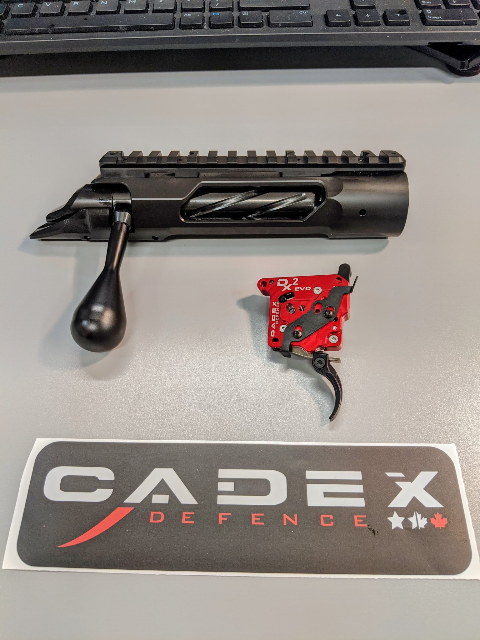

On the subject of bolt throw. The Cadex R7 @ 50 degrees as expected has a heavier bolt lift than I prefer. But like everything else, dry fire remedies the issue mostly. Definitely using my thumb for mechanical leverage during the initial "sweep".
I didn't buy this for competition, but mostly for long range steel and hogs. So it works for my needs. It is very smooth after the initial lift.
