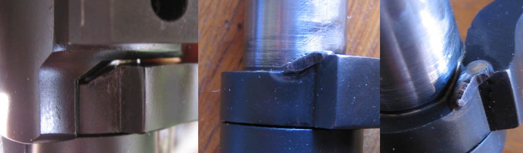

I agree that moving the bolt handle forward is generally a good idea because the cam for primary extraction is important for smooth and trouble free operation. If you're replacing the bolt handle then that's a perfect opportunity to time the replacement handle correctly, but I've built up handles with weld before to improve the cam function. This was just an easier way to achieve the same thing.
edit: One other area you can loose primary extraction is the hook. I've seen some that are really sloppy, such that the bolt would be well back on the cam before the hook would even touch the case rim. If you make it too tight though, then you risk not catching the rim at all if the case has a particularly thick rim or if the headspace allows the round to sit forward in the chamber a ways.
