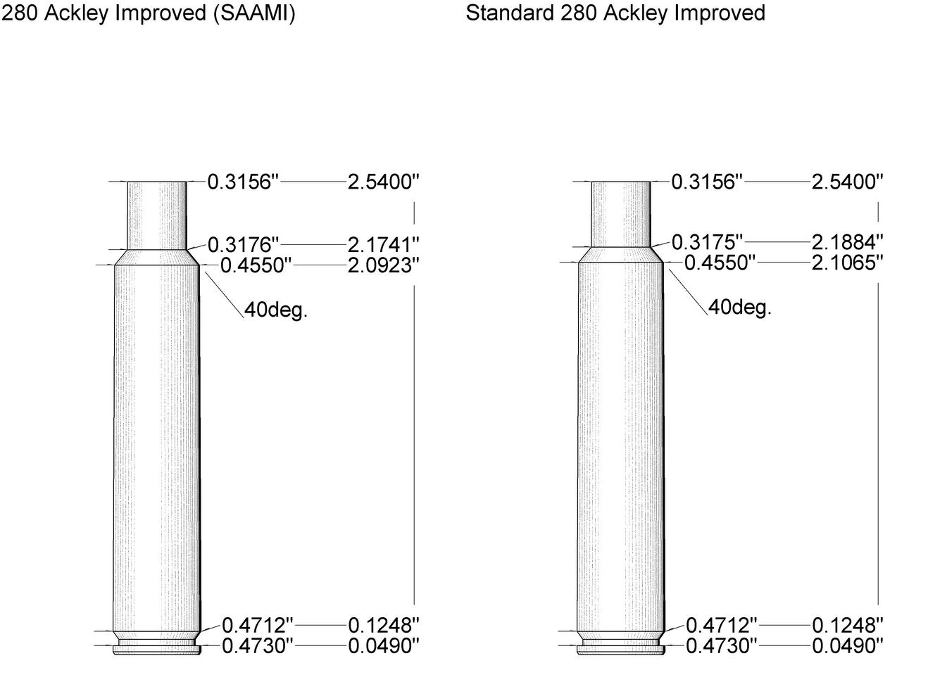

FYI, there are 2 ( prob more) different 280 AI chambers. One being SAAMI (spec By Nosler) and the original Ackley. The SAMMI shoulder is approx .0143 shorter than the original and can cause headspace issues. Fire formed brass from the original used in a SAMMI chamber will make it hard to close the bolt.
Here is the chamber specs.
