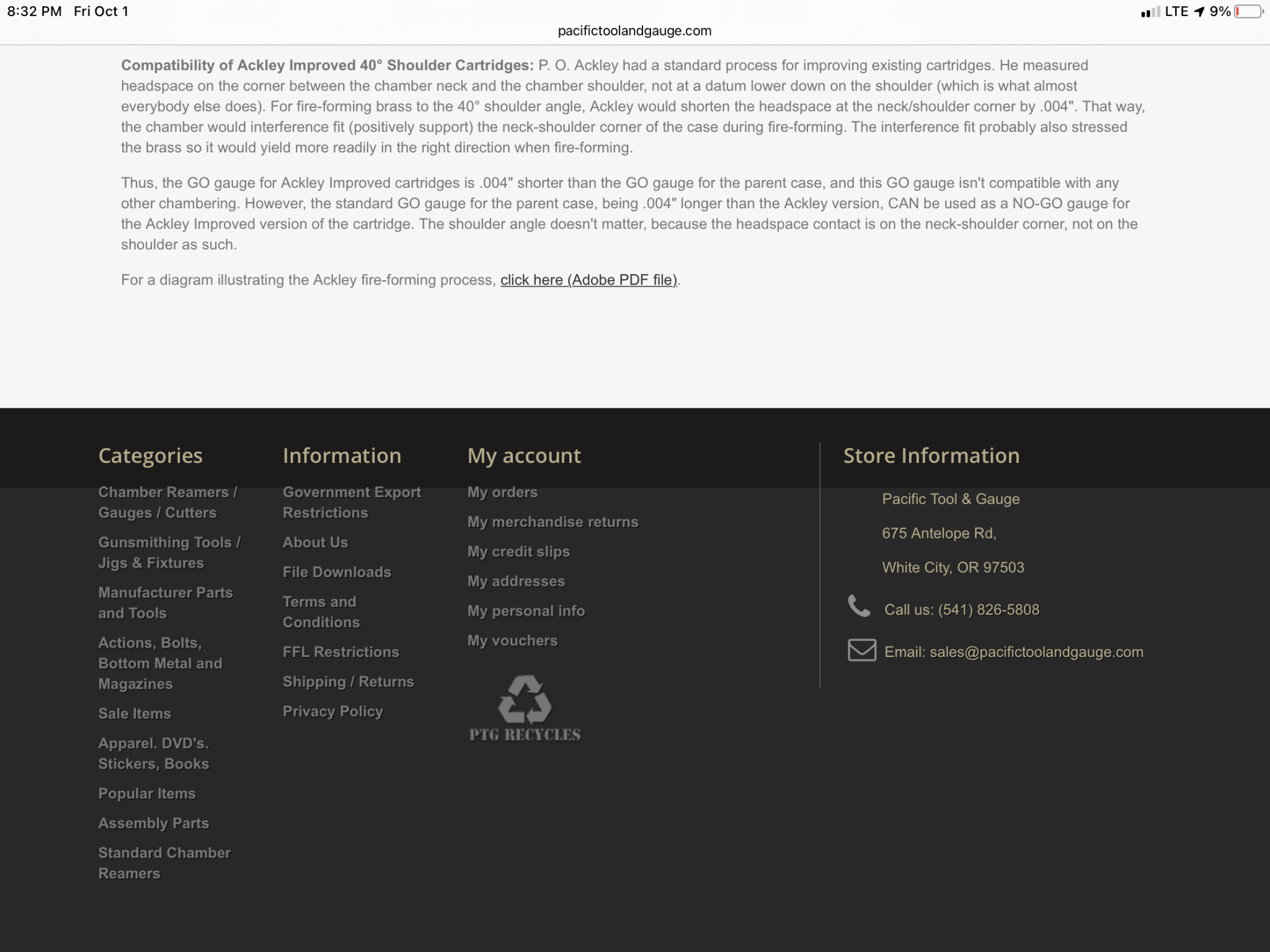

Generally speaking, you’ll get better results with headspace gauging if you remove the extractor and the ejector. Sometimes you can start the bolt closed with the gauge already under the extractor, but in any case make sure you’re not getting any interference there, that’s causing the issue. Check out the attached picture for information on the difference between ackley improved and parent case go gauges. That was why I asked that question.

As oregun said, an ackley improved should be a .004” shorter than the parent carriage neck shoulder junction to ensure it’s held against the bolt face to properly blow the shoulder out.
