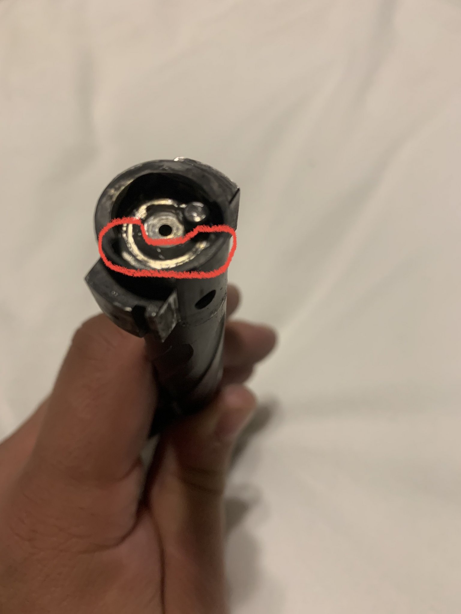

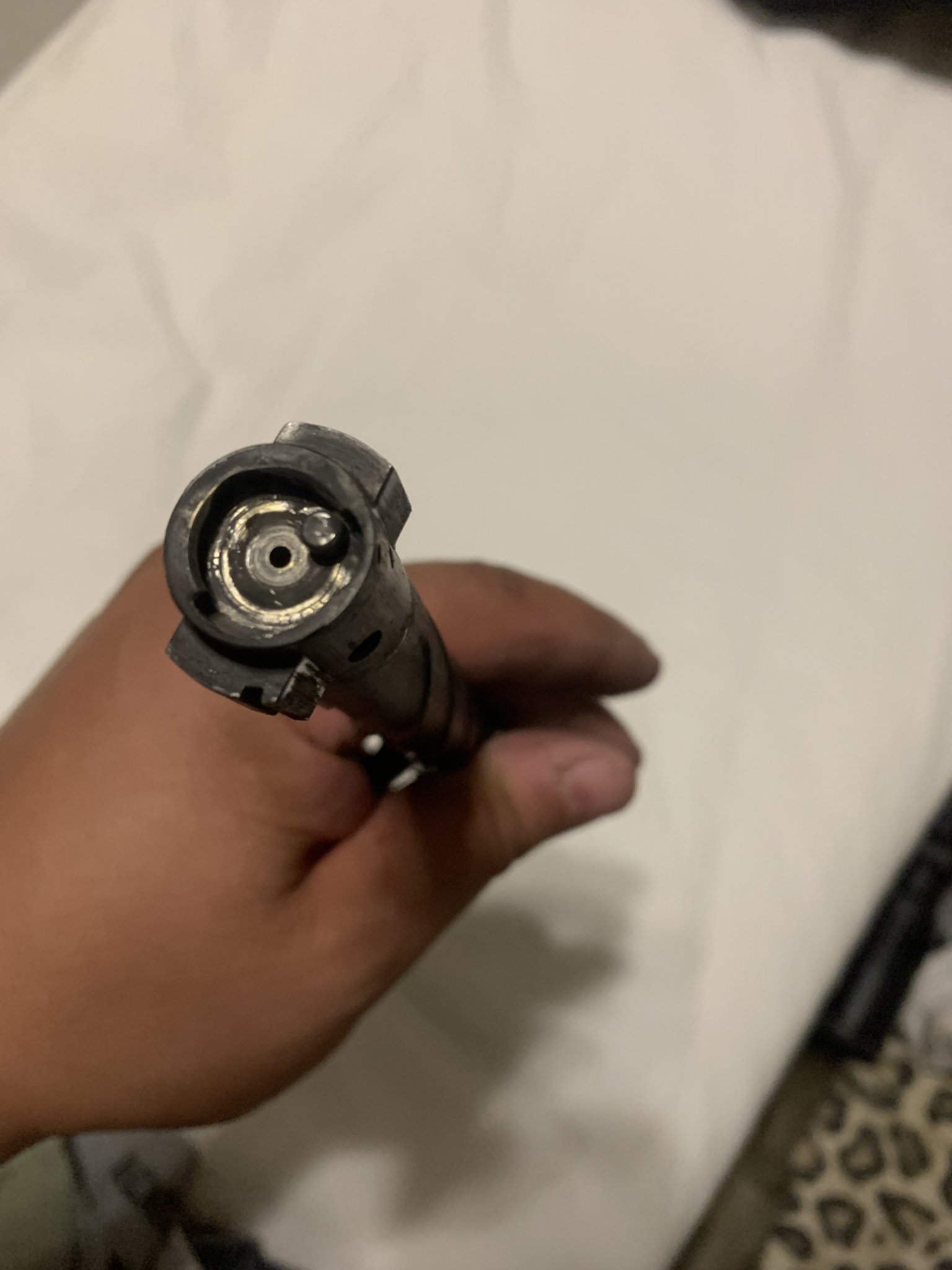

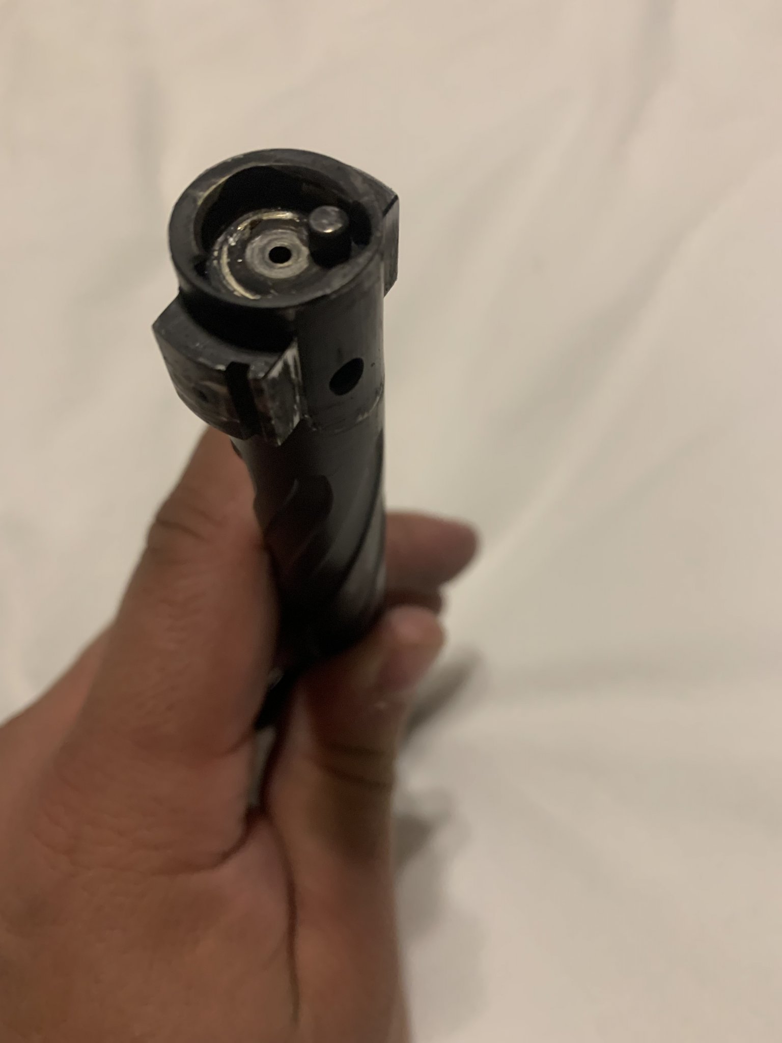

Forgot that I worked this load up in the winter. I recall factory 700 bolts being (3) pieces. Had a piece of the bolt face that the rim of the case sits below blow clean off. Time order a new PTG bolt or is this salvageable?

People freak out about all sorts of things. Check head space, reduce load. It's probably fine. You don't need to replace it with an impact action and a zco.

It's fine. Clean it and keep going.
Yeah, totally...it will still work. Just take a cleaning rod with ya incase the extraxtor has blown away or inoperable, Open the bolt knock the spent case out with a cleaning rod. Or Install an m 16 extractor. It can be repaired, a new Remington extractor about $18, if it still fits in what's left of the recess. Machine and press fit in a partial new piece of steel....Adapt and overcome. Too many good choices. Or buy an new bolt, that will need to be headspaced

Generally the bolt fits but it's not a drop in, and it requires the m16 extractor be installed... you may have to file or buff the m16 extractor to get it to fit...if the headspace is off and most likely will be because of tolerance stackup. In components. So ya need a go gauge and a no go gauge. If you were lucky and some are it fits the go and stops on the no go.
But the bolt body or bolt nose, or barrel counterbore could be a problem. And requires machining, as well as a headspace adjustment, and the barrel removed, and or opening the barrel counter bore to fit the extractor. But the usual dia of the bolt is about .700" so it generally slides through the bridges front and rear, as most run .702" to .704" ish. This is easy if ya have the tools and a lathe, just incase.
Everyone wants a dropin perfect fit, but thats not how it works and get angry when it doesn't...but it says "should be installed by a competent gunsmith" at the product sales site...before you buy. You could buy one and have it fit and be on in headspace...but that would be just luck. That's just how it is,.. for now. If ya measure the bolt reciever bore accurately or the dia of the bolt body in the rifle ...you could request that diameter, but noone at Midway can probably read a micrometer, but that would be a big help, the bolt fits the raceway ..but there is no real customer service these days...just read the order, package, and ship.

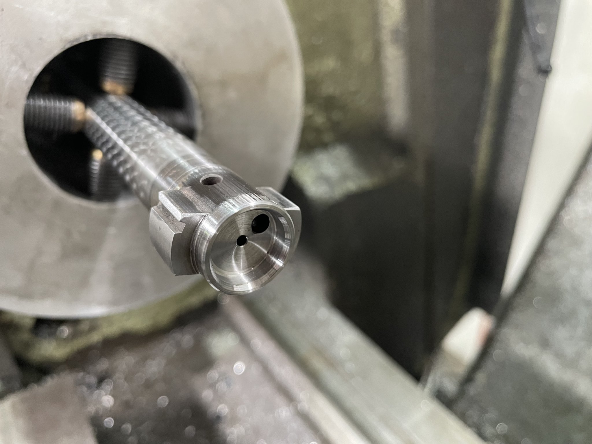

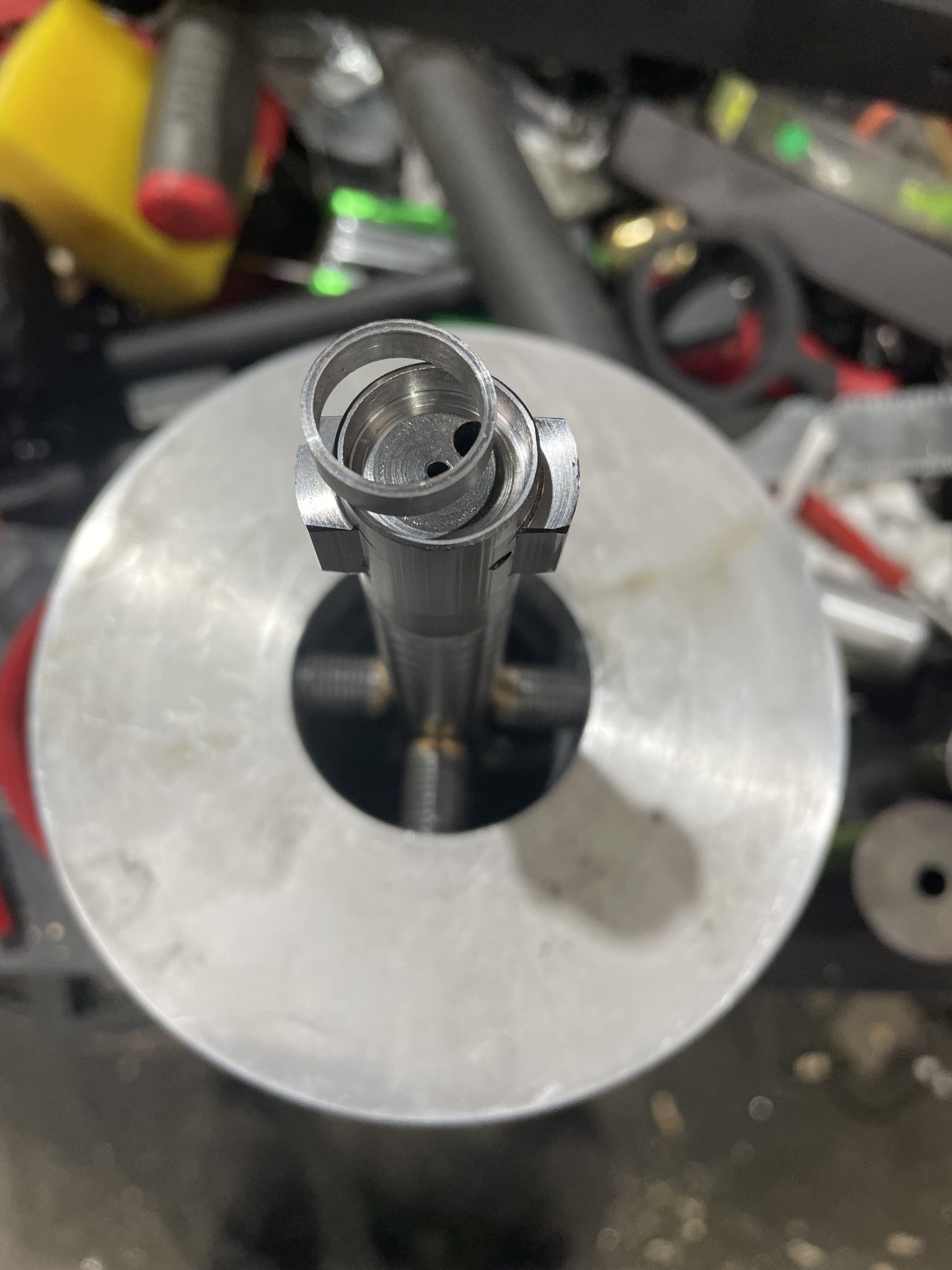

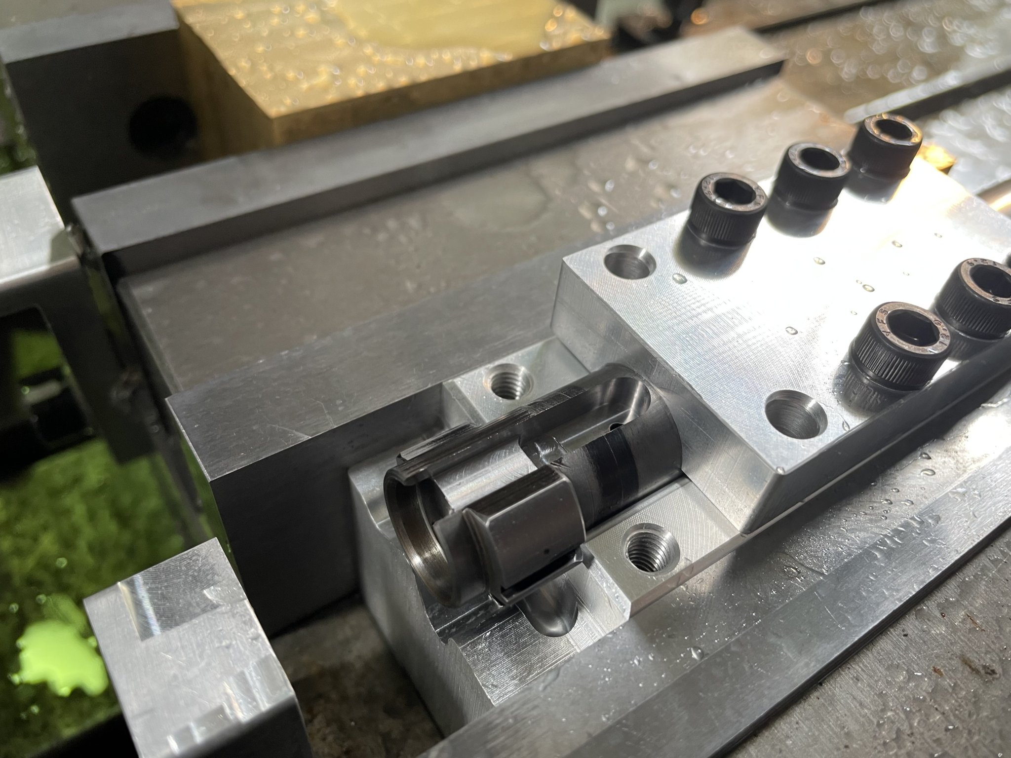

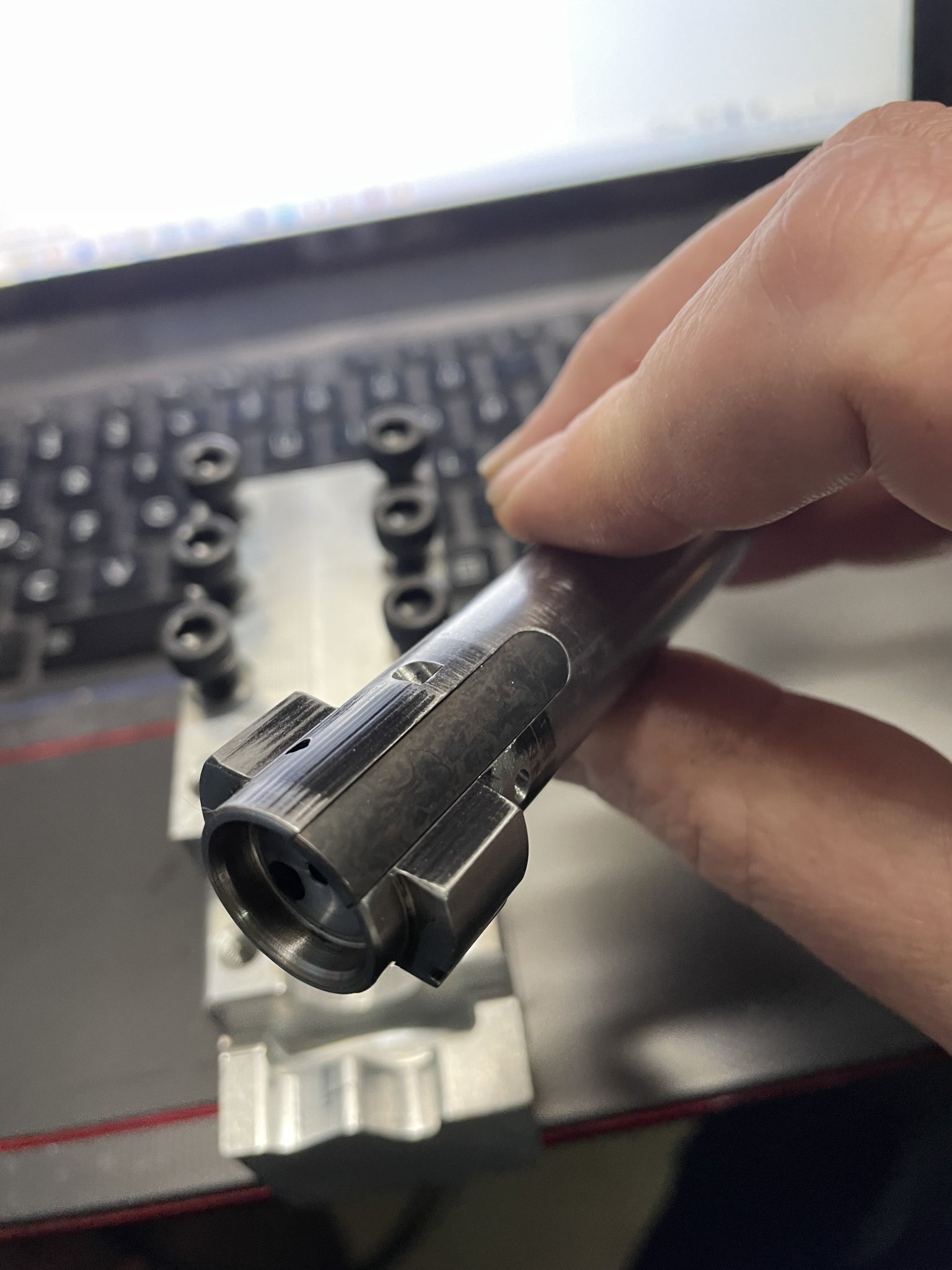

It's very fixable- machine the bolt, solder in a sleeve and fit an M16 extractor.

What's it look like all cleaned up? Trying to diagnose a problem with it like the original pics isn't a good idea. Clean it and see what the issue is. If you just blew out the extractor you can pop another in yourself.
