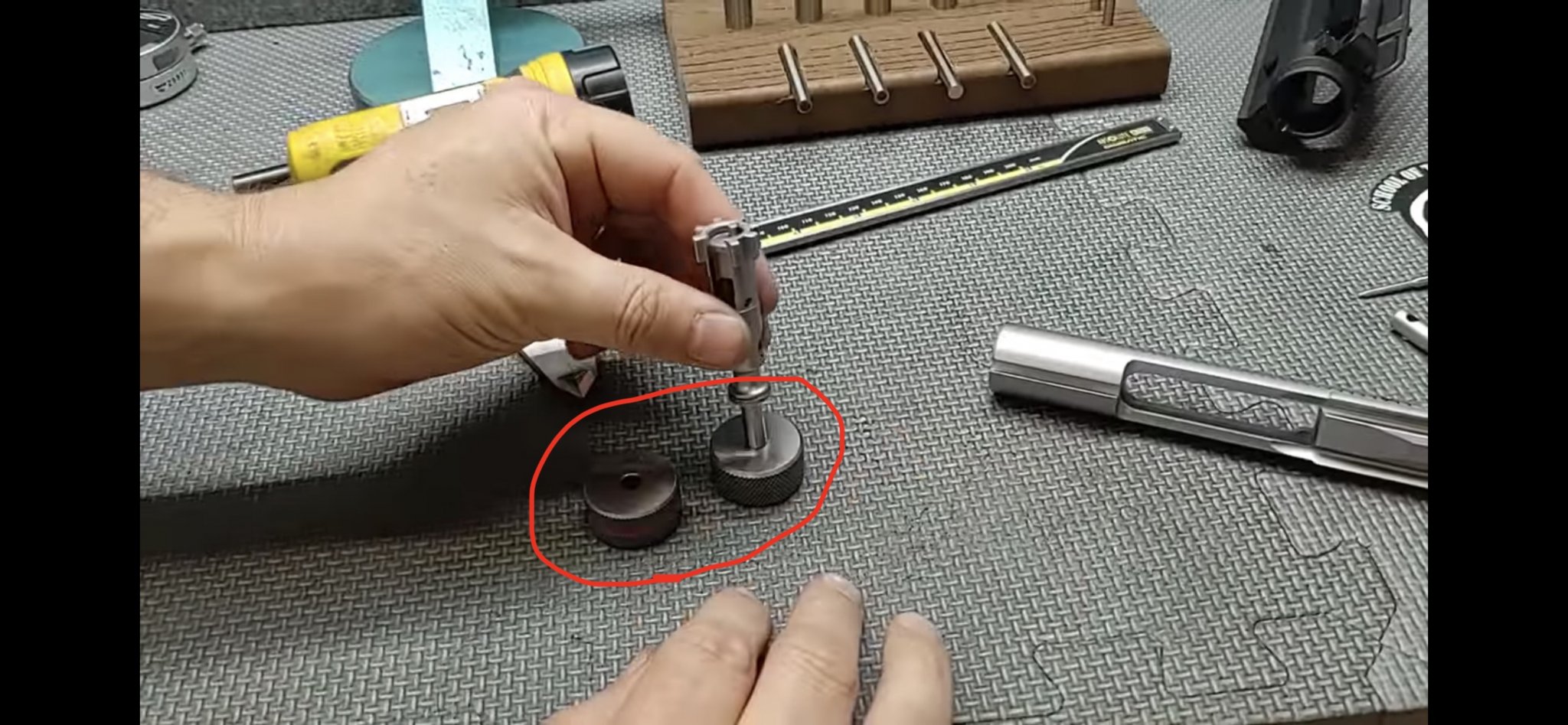

Where can I find these .223/5.56 bolt tail no go and field gauges?
Looks like SOTAR. It used to be if you went to his school, you were able to buy gauges that he has made or buys to his spec. Minimum TDP bolt tail dia. for new is 0.2501". Min. for used is 0.2498", discard at 0.2497". I have seen "No-Go" gauge marked as 0.2496", "Field" marked 0.248.
Reactions: URGILOVERR
Great information thank you sir 👍🏽
Do you have these ring gauges? If so what are you using? Kinda only wanna get 2 those are super expensive
