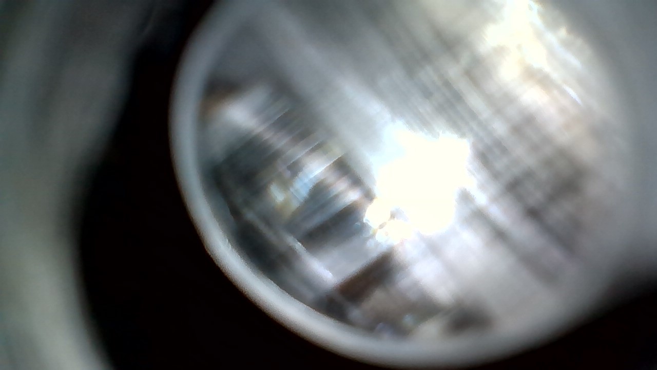

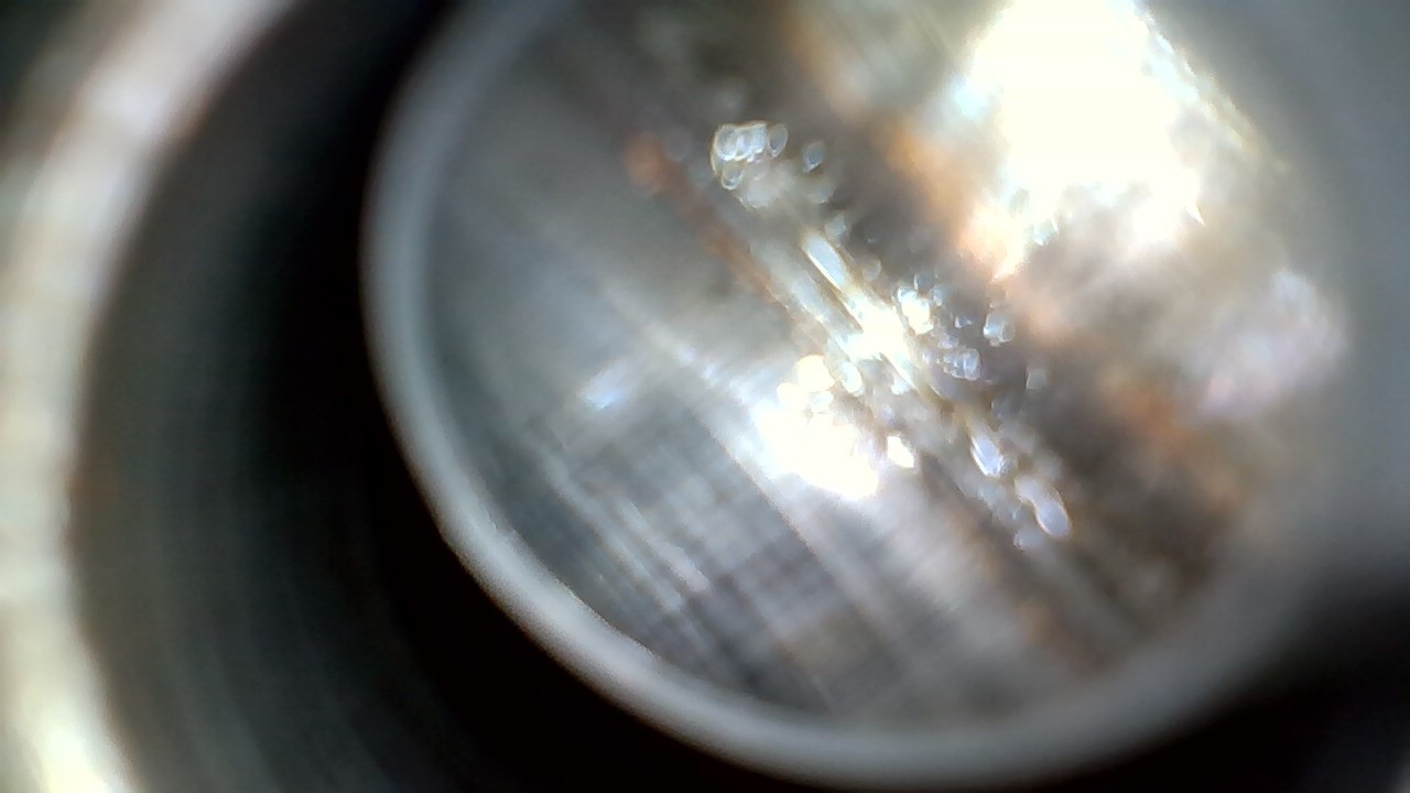

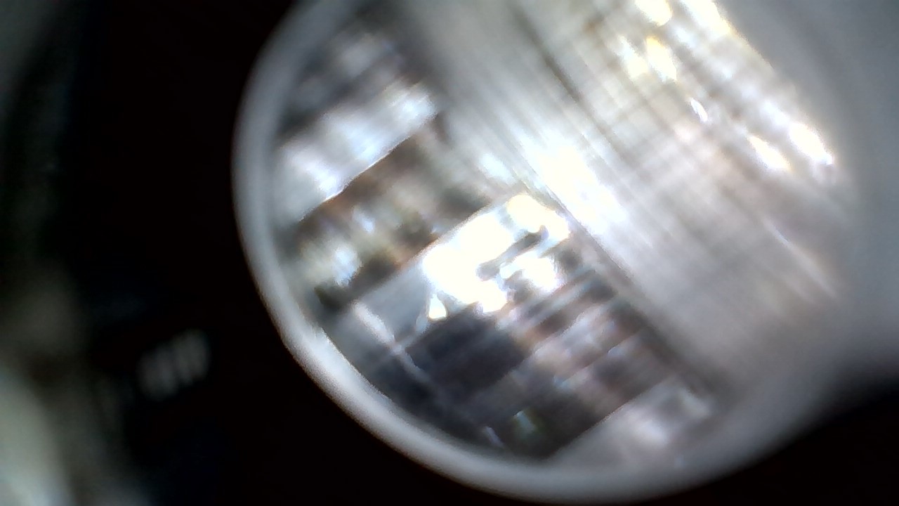

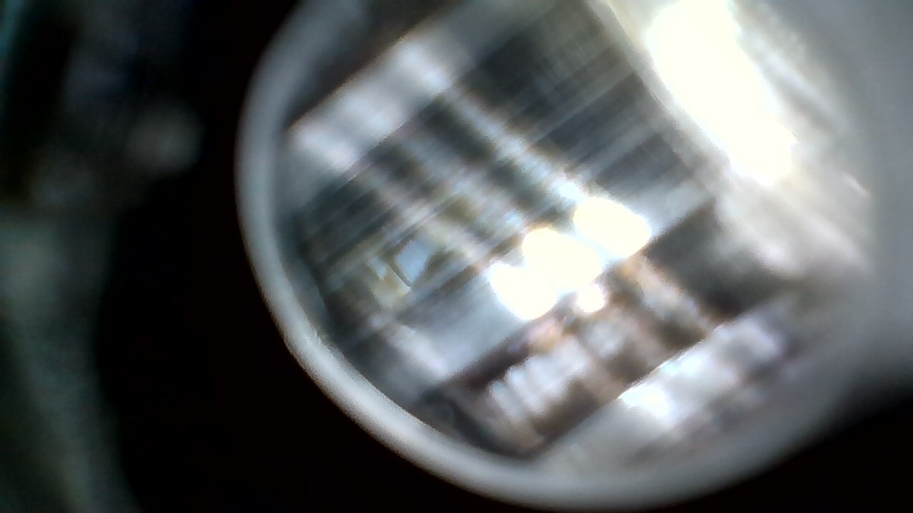

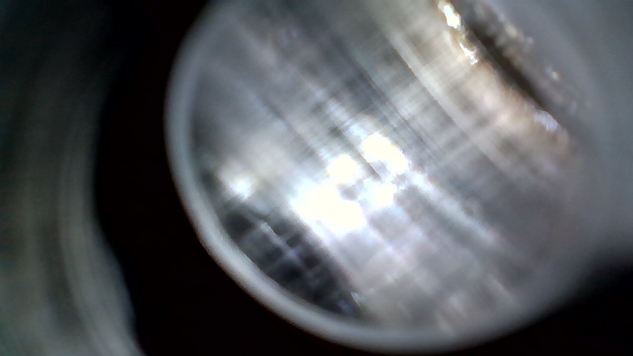

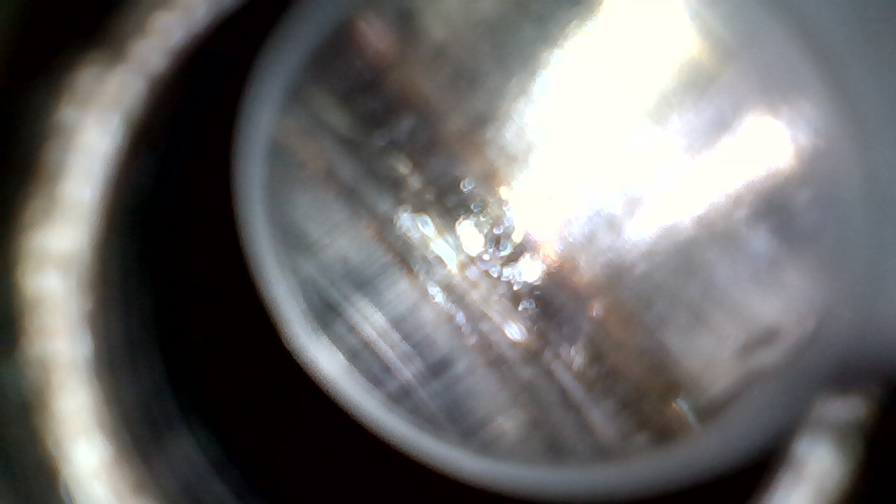

Here are two sets of 3 pictures from the bore scope at 0 and 180 degrees rotation about the bore axis. Sequences show lands, then free bore then something at the end of the cartridge. Maybe a carbon ring? Seems very odd at this round count though.

The rub marks are all the way around your bullets.
If the lead was too short, the only marks would be where the lands/throat are engaging the ogive.
Yours do not look like clean throat engraving.
If this rifle is new, my money is that whoever chambered the barrel could have had a reamer with considerable wear in the lead/freebore section leading to the throat.
As mentioned in a separate thread a week or so ago, this is fairly common and rarely caught especially if using HSS reamers.
If this is the case with your barrel, the lead/freebore is rough and under-size.
If the very first rounds didn't exhibit this conflict, the condition would produce such an interference after just a few rounds.
This should be an easy fix.
I would suggest that you contact the builder of the rifle regarding your issue rather than spending energy and time on internet forums.
Can you focus your borescope a little better? Maybe screwing the tip in or out?
Kinda looks like a carbon ring in a couple of those but hard to tell.

Here are better-focused pictures. I'll ask the gunsmith if I have to, but I don't want to make extra work for him if it's something I did wrong. The rifle ran fine at first, so I suspect the problem is on my end. That being said, I've never had this issue before and I've shot thousands of rounds through other guns. This is my first "custom" rifle, so maybe the tighter tolerances exacerbate something I do wrong?

In my opinion, there is nothing you could have done even on purpose to cause this problem.
....AND even if you did cause it, you cannot fix this without correct tools and expertise.
This is not a "carbon ring".
This will not go away with lapping or chemicals.
This will not get better with more shots down the bore (it will get worse and quickly)
This cannot be resolved by changing ammo specs.
The radial direction of the scoring and blemishes are something that happened between the time the Hawk Hill was put in the lathe and the time it was removed.
As outlined above, it is possible for the rifle to run ok with this condition at first. I believe even your first rounds were rubbing and creating resistance but the first few shots started to build the interference between the bullets and the flaws where the (smooth) freebore and throat should have been. Even a couple ten thousandths matter greatly in the lead area.
This could happen to anybody building guns/chambering barrels but if the shop inspects the work with a borescope prior to shipping (most don't) and/or they at least shoot some control groups and do a complete function test on the gun with live ammo the work would never leave their shop before being corrected.
I would encourage you to contact the maker for a resolution.

The first image in your post #21 shows that your chamber has no throat at all as best I can tell.
There is no transition from freebore to the lands.
Maybe someone smarter than me can give an alternative argument.
Still waiting on some of the previous posters above to expand on why you think he had a carbon ring issue at 70 rounds. Is that really a thing?
I agree with Terry on this. You can see the VERY short taper the lands, but this even looks too short for a typical 1'30" degree cut and there is NO freebore section at all.
