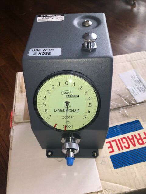

    As a user of air gaging at work (aerospace) using anything other than air gaging you won't see a difference. I'm not sure the magnification range the manufacturers use but they can get ludicrously tight. Ones I normally use are the 2500:1 magnification. Each tick line is 0.00005"(50 millionths) measuring +/-0.0015 on the face. Others I've used are the 8000:1. 0.00001" (ten millionth) ticks measuring +/-0.0007 (7 tenths) on the face.
    We also have some like in the picture. Internet picture. For scale the body is 5" wide.
