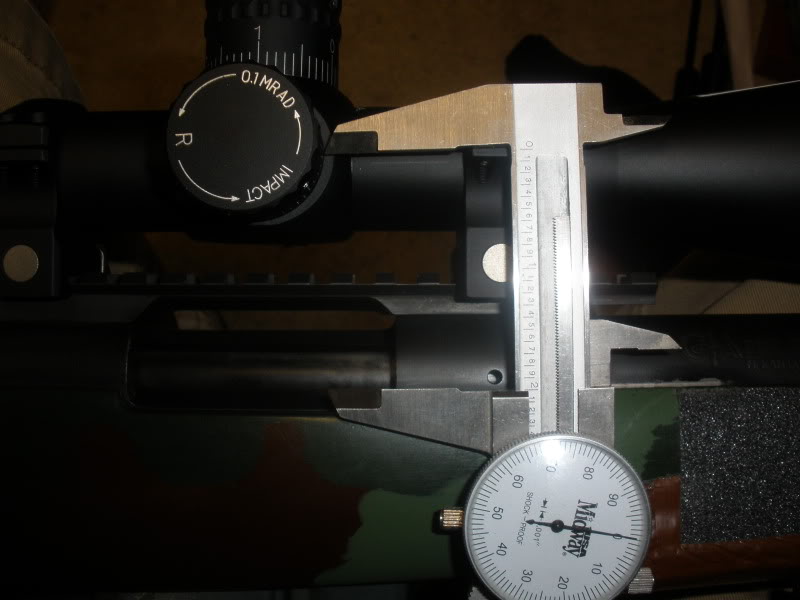

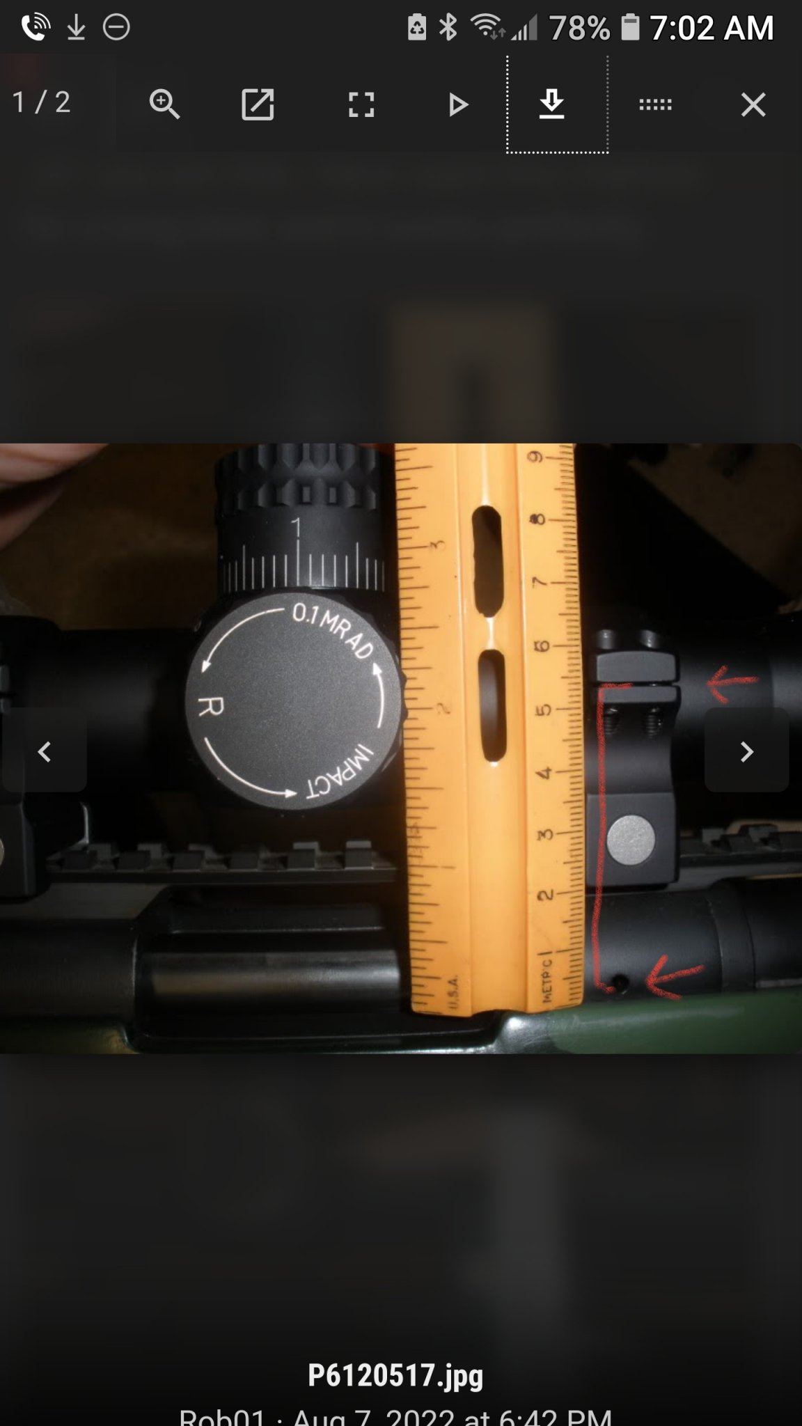

Here is the easiest way and it works fine with no math. Center of bolt to center of windage knob. No doesn't matter if a 20 or 40 MOA base and as long as you are within .25" you are fine. Have used this method for a long time and it works perfectly.
Or with a caliper.
Or with a caliper.
Bingo this takes 2sec and is so easy... I use the ruler and it's always been spot on..

Yeah, I use a caliper also but take the measurement at the back end of the bolt (center of the shroud, right) up to the center of the ocular len's cover . Maybe I'll try to the middle of the windage as you suggest. Looks like easy access/easy to eyeball it.
Reactions: Rob01
I use the same method as Rob and Dom. Any time I need to measure the scope for a firing solution, I measure to the centerline of my turret.
