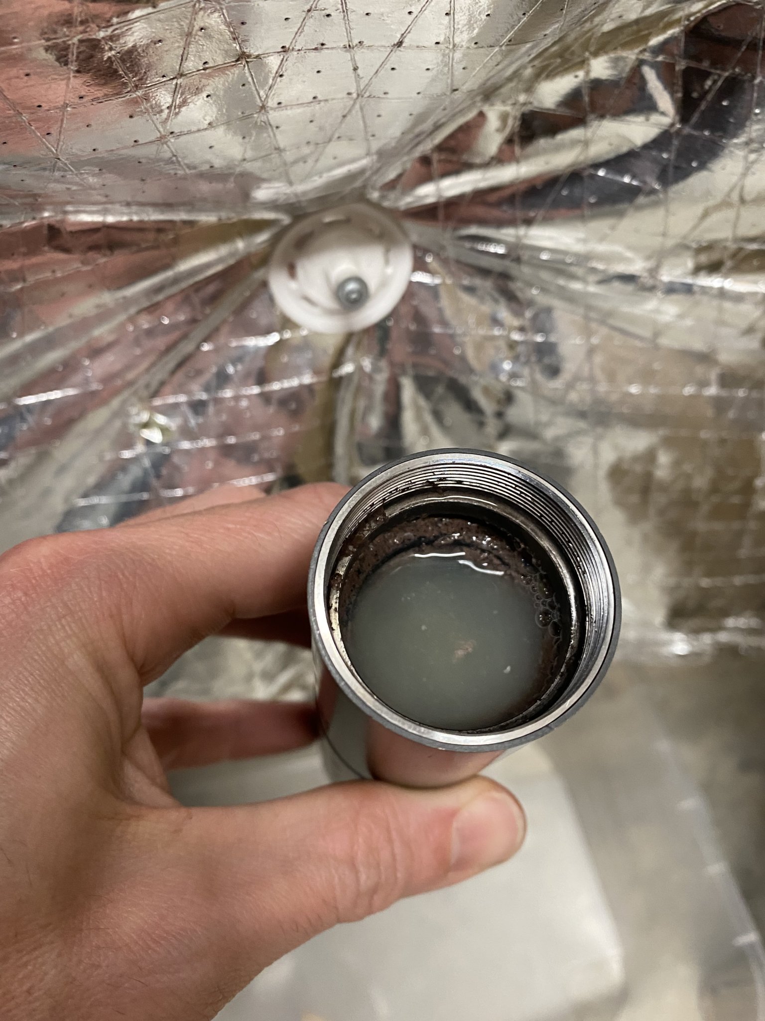

    Finally testing this shit out. Using only the Two solutions, no lance/pressure washer.
    Two hours in, the level has dropped a good 1/2” and it looks like some of the carbon has turned into brownie mix. I’ll post what is dumped out tomorrow before I rinse and go to Part B.

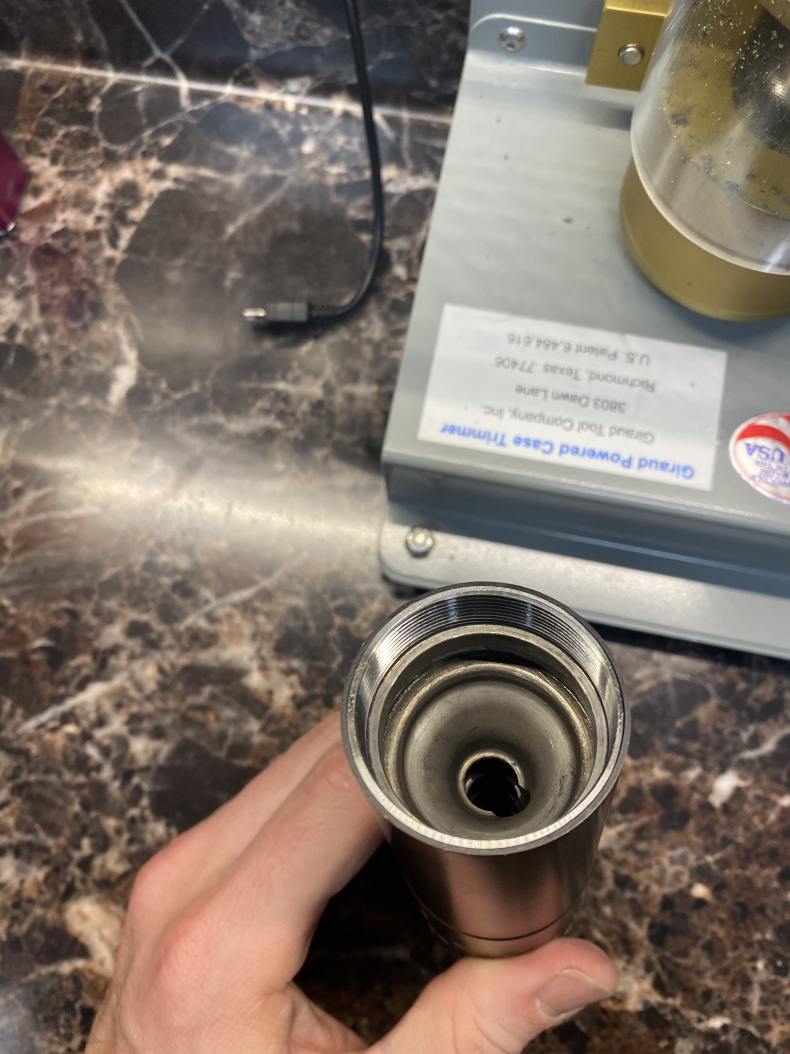

    Update 1: 24 hours after part A soak, I dumped and rinsed well, followed by blowing out with a compressor. A lot of carbon came out, but you can still see a bunch on the inner baffles, as well as some thicker caked layers in the blast chamber. I can see the value of the pressure washing lance. I did order a few steel brush pipe cleaners to help get into the baffles and dislodge. Update tomorrow with what part B does.
    Update 2: I just ordered the full kit. Expensive as fuck, but it’s for science.

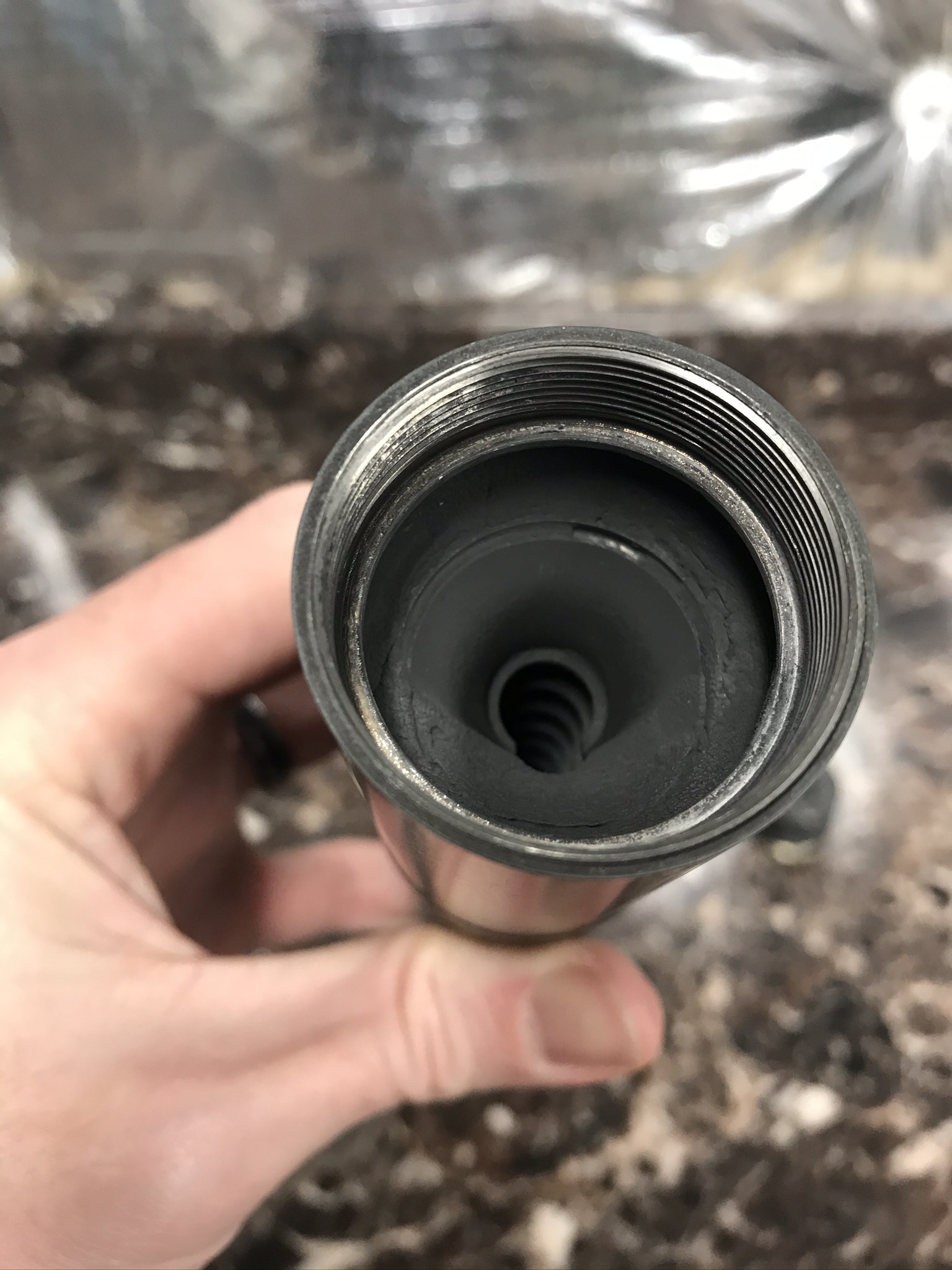

    Update 3: just finished with the Part B cycle. 14 hours through and I was beginning to think this part was worthless. The solution color was dark, but had not gotten any darker. However, once I dumped it and started rinsing…. The amount of shit that flowed out surprised me. Thick chunks of carbon fell out. I rinsed for about 10 mins, then hit the blast and exit chambers with a plastic pick. It was effortless to remove any thick chunks remaining.
    I will say, this Part A and Part B of the Decimator solution appears to be stronger than what Bore Tech C4 is. I had to go through what was 2-3 cycles of 24 hour soaks (with C4) to get this level of removal. After blowing out the can with my compressor I weighed the can. I got out .34oz of carbon. Not bad at all.
    Lessons learned: plug the exit cap with the cork/plug, not the blast side where it threads on. I had a lot of leaking (during Part A) which I attribute to the plug not sealing enough in the threads. Also, highly recommend ( if you can remove the exit cap ) to wrap the threads in plumbing tape. I had zero leakage this way.

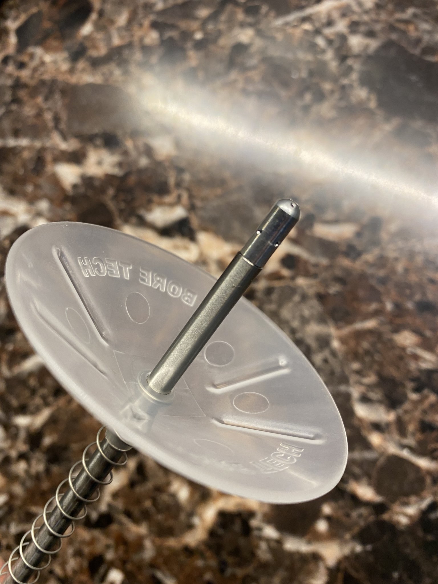

    Full kit arrived today. Nicely packed. Impressed with the lance. The tip has 6 different holes (3 per side) in a cross direction to get a wide coverage with each pass through the baffles. As soon as this shit weather passes here in MD, I’ll hook up the hose and put it to the test.
