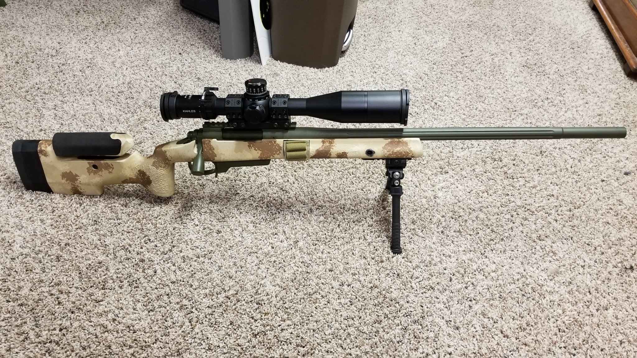

I am trying to build a rifle in 300 Norma Mag for the Barnes 212 gr Bore Rider with recommended COAL of 3.845.
Is my only option BDL with a Wyatt's extended box?
Will that box work with an Impact LA or the Mausingfield M7 with a Lapua bolt of course and Hawkins M5 Obendorf BDL bottom metal?
