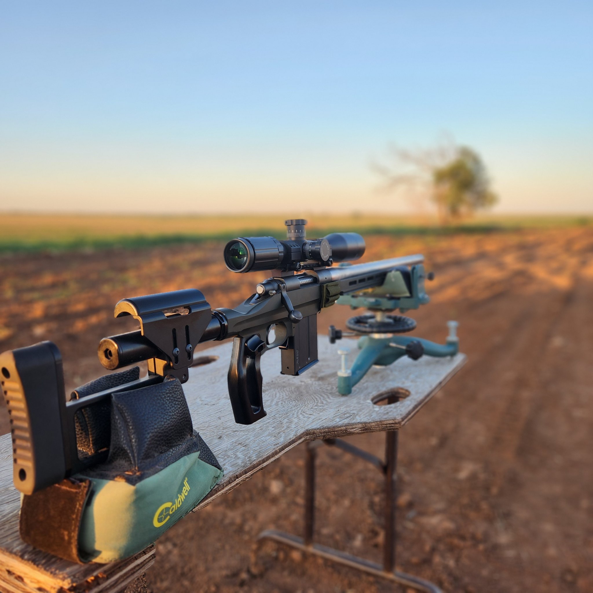

Bought a Remington 700 action(dates to the 90's). Barrel is a 24" Shilen chambered in 7BR. I feel this caliber died way back when. Found some new Peterson 7mm br brass. Went out to sight in with 8208 and 110gr tnt and wow im pressed under 1/2 inch groups right out the gate. Having an issue with the bolt not grabbing the spent case and ejecting the round. I have heard of ejector issues but not extractor issues. Anyone know of a fix? Out of the rifles i have i havent had this issue.
