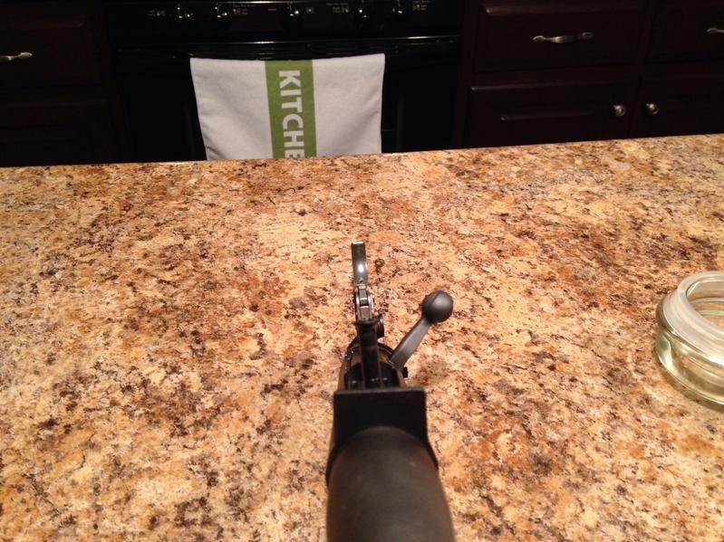

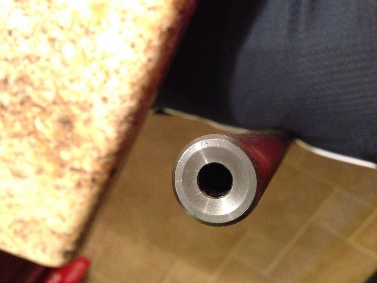

Inboxes it to find a scratched muzzle and a crooked lug
Should I see if the shop will take care of it or is it my baby to send back to Remington - and how long might that take?

I wouldn't worry about the muzzle, it doesn't appear to be any damage to the crown itself. The crooked lug can definitely present a problem though. I'd take it to a Remington repair facility if you have one near you and have the lug straightened.
What would it cost to have this fixed by a gunsmith. I haven't had a chance to call the gunshop yet. If they just loosen the barrel and fix the lug / retighten does headspace change?
The muzzle scratches are not likely to present a problem.
The crooked lug can be corrected with a few taps from a soft-faced hammer (a large brass or lead mallet works best).
Unfortunately, I've seen these problems on the last few new R700s that I've purchased.
Full marks for checking and inspecting the rifle.
Remember: With a factory Remington, YOU are the quality control.
Now you can either send it back or put more money into it.
... Which discourages the idea of shopping a factory rifle on price alone. So, better yet, send it back, call Mile High and snap-up an AE before they're all gone.

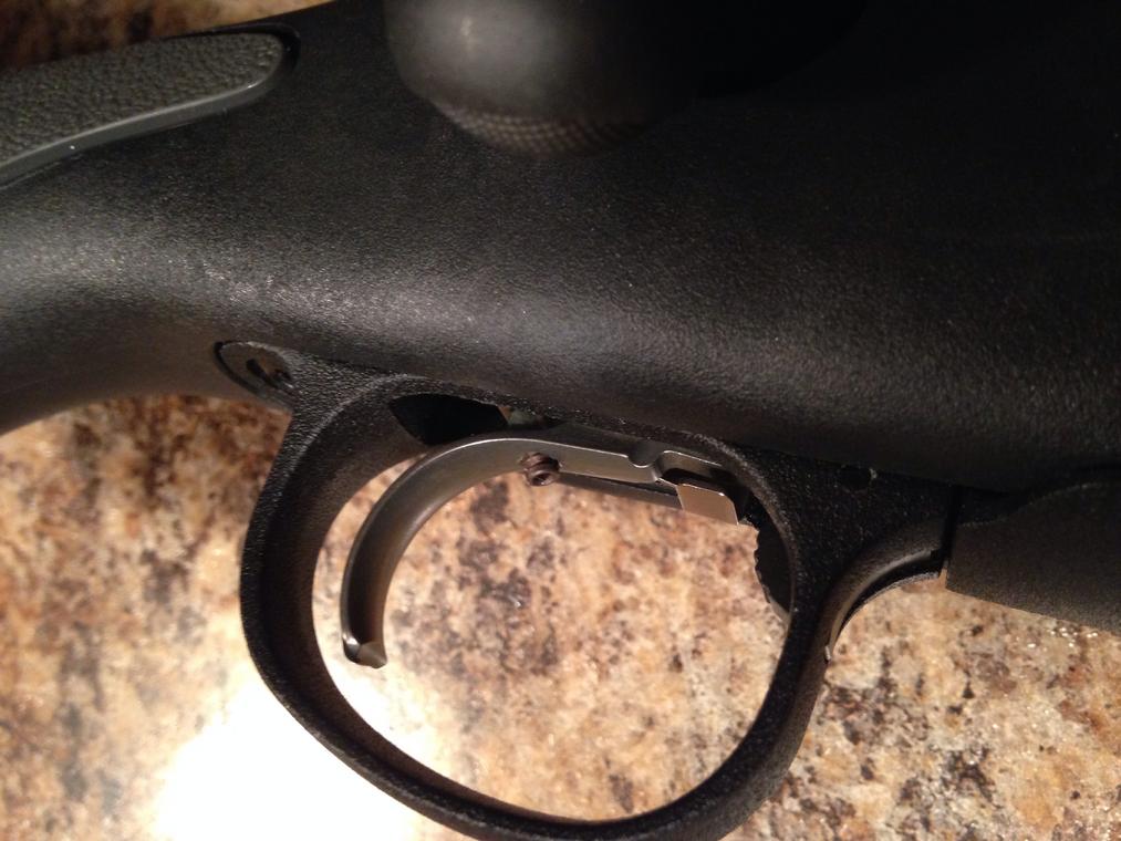

Well after closing the bolt on my just replaced sps v I noticed that it was firing
Here is what the trigger screw was like from factory - set too loose to catch the firing pin

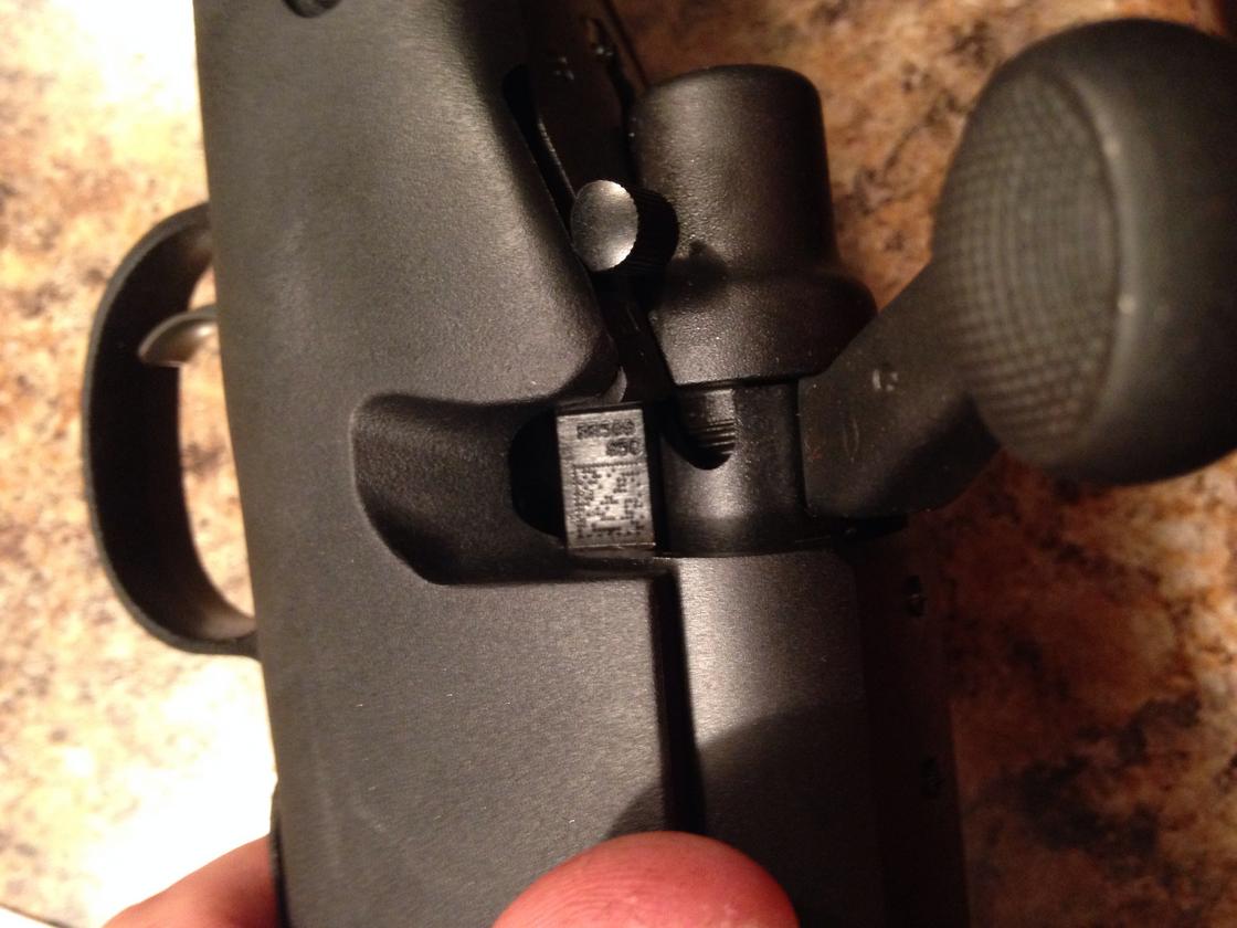

Under the bolt knob looks to be a QR code see second pic
What a freaking joke!!!
The screw on the trigger itself only has limited impact on trigger pull; on any factory X-Mark Pro I've see, it can be backed out all the way with virtually no effect. If the sear isn't catching the cocking piece, then either the adjustments on the trigger body got messed with at some point (check to see that the factory sealant is still present on the sear engagement and pull weight screws), or something is severely out-of-spec or broken.
Send this thing back to Remington, and make 'em pay for shipping. This is totally unacceptable on a factory gun, and the factory needs to be held accountable. They aren't going to get the point if you eat the cost of fixing everything yourself.
Yep, that's standard on newer R700s. I'd love to know what information is contained within ;)
