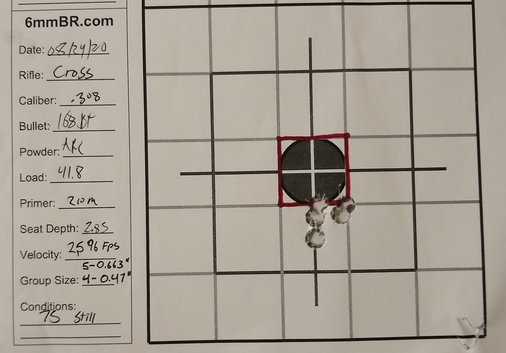

This was setting up my friends cross in 6.5cm. First 6 rounds through it BTW. The group on the left is 120amax and the group on the right is 143gr ELD-X. It was the reason I went out and bought one.
I settled on this load for hunting last year after a little rushed load development.

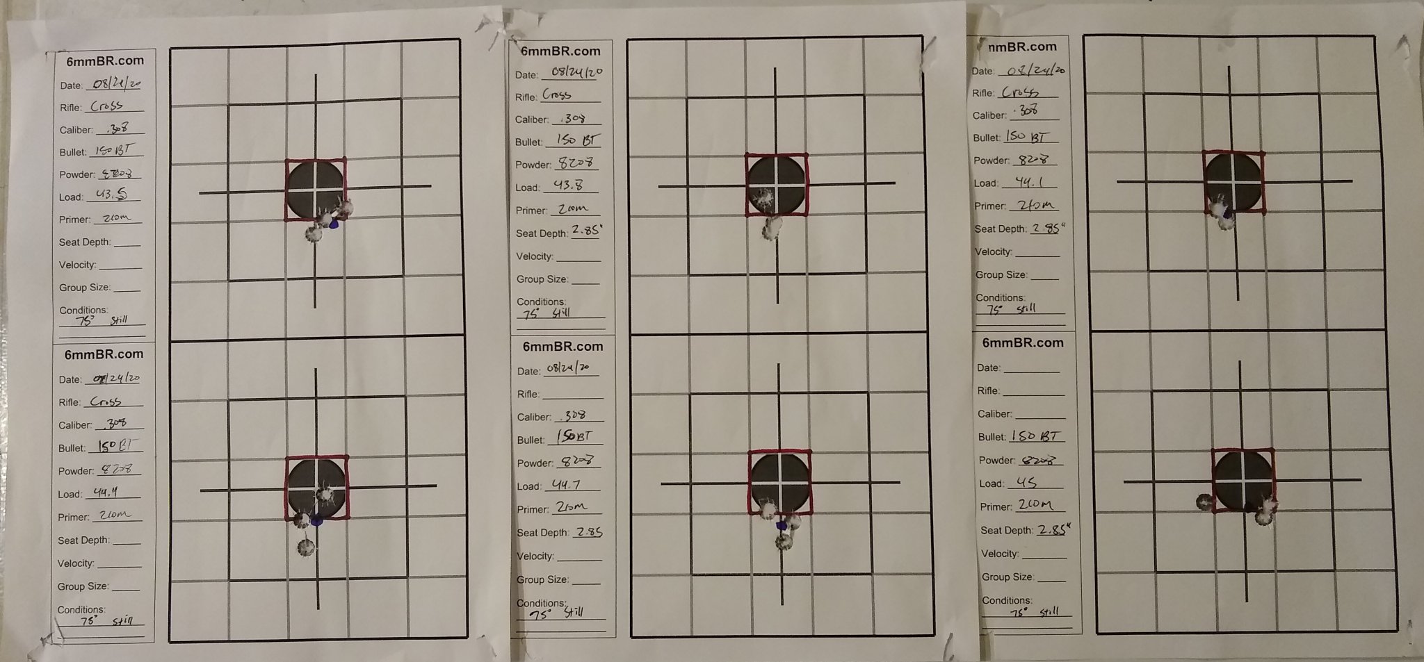

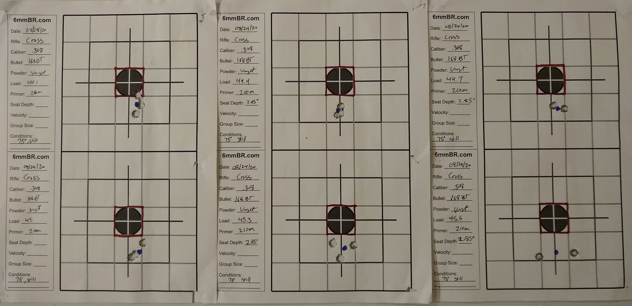

Here are a few other OCWs that I started and didn't finish before swapping a 6.5 barrel in, maybe something here will help give a starting place. Honestly with the type of groups you mentioned, and if you verified everything is tight, it sounds like something is fucky with the barrel and it might need to go back.

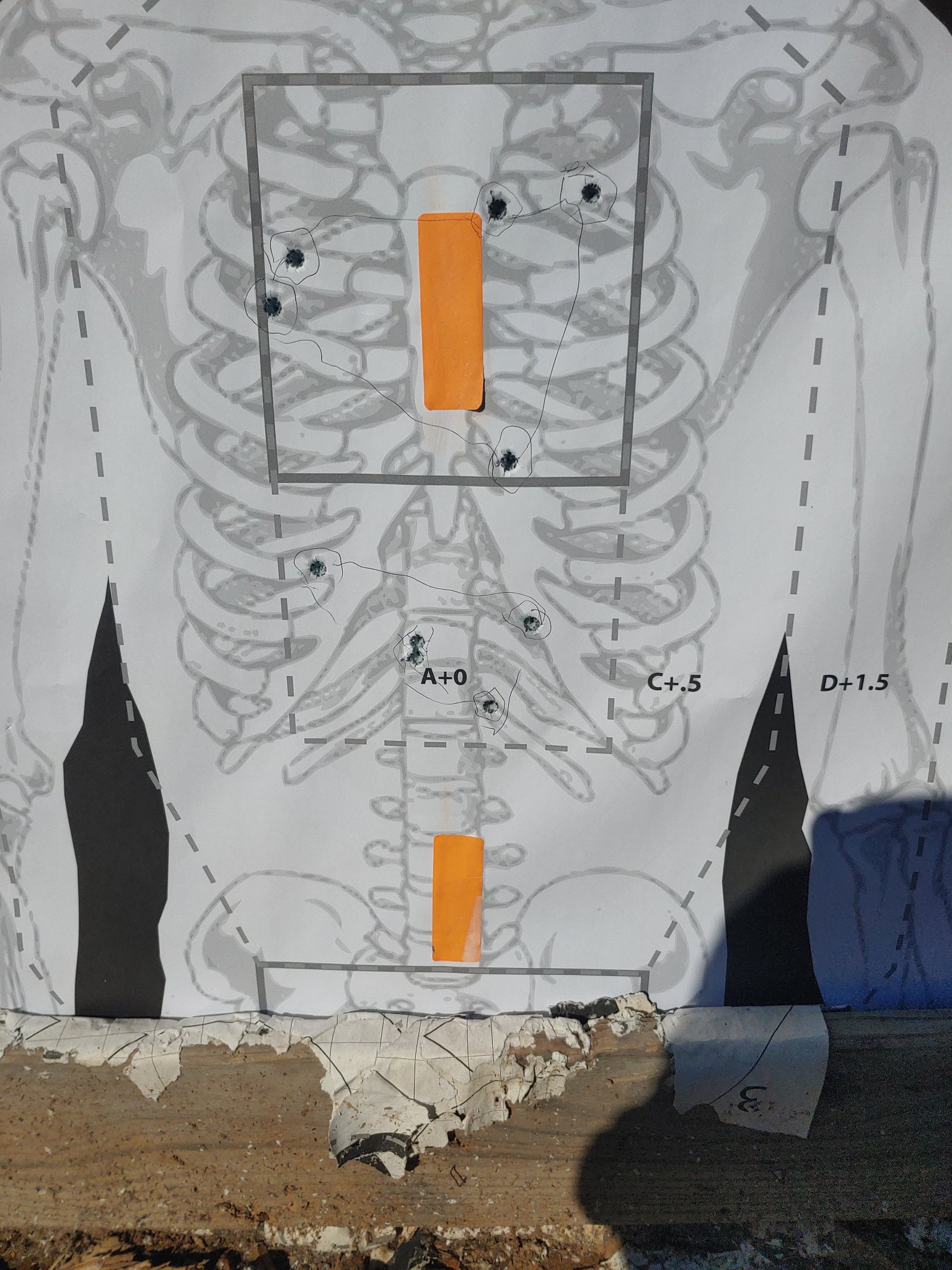

Here is the OP's newest post from the main Sig Cross discussion thread where he solved the problem- an ammo issue:

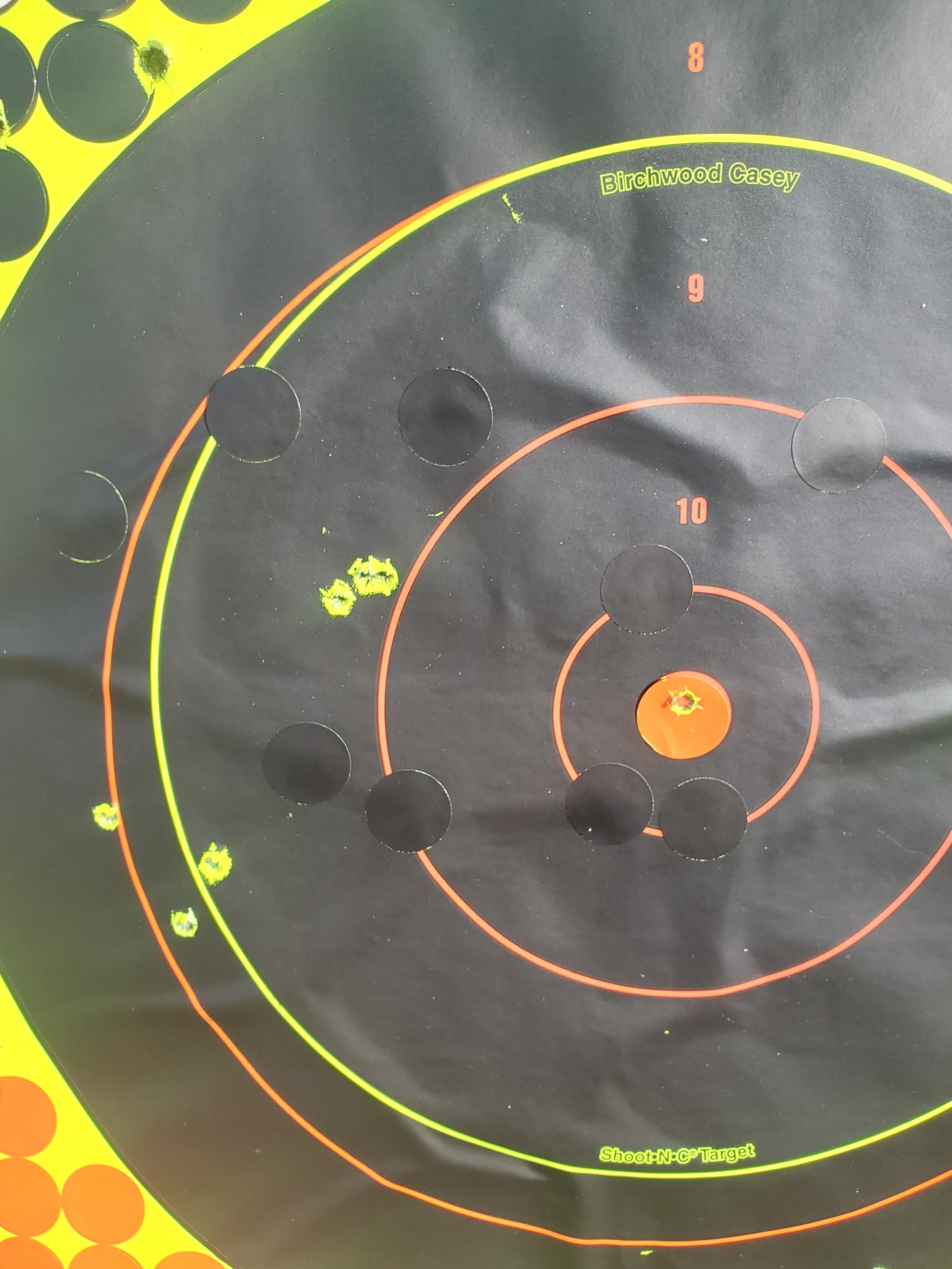

Well it's looking a hell of a lot better than it was. I tried some CFE223 and the old standard 44gr of Varget. This is with LC brass and CCI 34 primers. There a 3 groups with 3 different loads at 400yds. 2 of them are definitely under MOA. I have never seen a rifle go from shooting that bad to grouping like this like that. I'm going to switch to some CCI BR2 or 210M and stay with the varget and maybe even try some new Winchester brass or lapua and see if I can clean it up even moreView attachment 7756456View attachment 7756459View attachment 7756460
Yeah it's a good bit better, it's not any .5 or anything but definitely better than it was. I think it may be a legit .75 rifle if I tune up the reloads a little better. This was with LC brass and CCI 34. Nosler 168CC and varget. The larger groups was 47gr of CFE. The 2 smaller ones were 44 and 44.5 of Varget. These groups were at 400yd. Except the small one there. That was 100yd with 47gr of CGE but it was a little too warm. Had a little click at the top of the bolt lift. With both 44 and 44.5 of varget shooting good I loaded some for tomorrow with 44.3 in both LC brass and also some Nammo, lapuas version of 7.62 and I'll try that tomorrow morning. I was very surprised at the turn around it has made. There is 3 groups on the 400yd target and 2 of them are definitely sub MOA.
