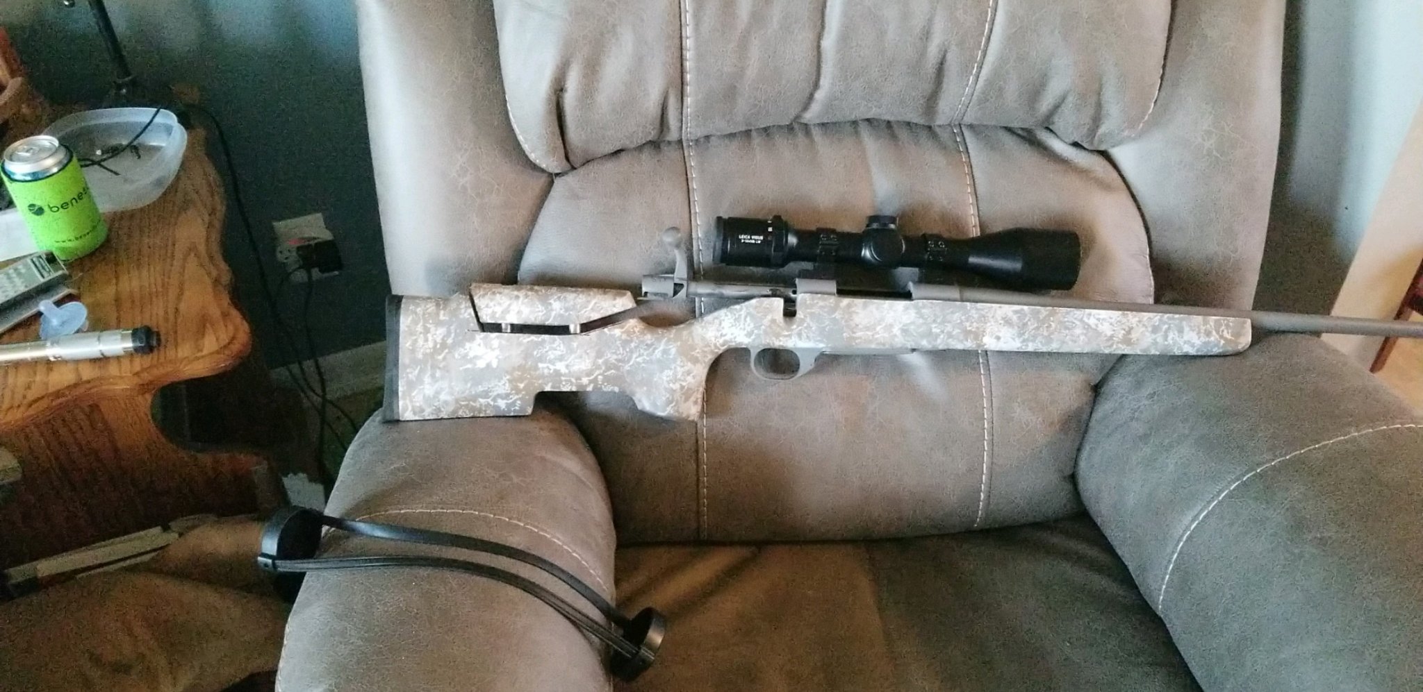

I dont know how the Pro Varmint compares to the Rimfire Hunter, but my heavily reshaped Pro Varmint needed .5" pillers in the redneck cheek peice to get a good cheek weld on a budget 243 with a sporter barrel.

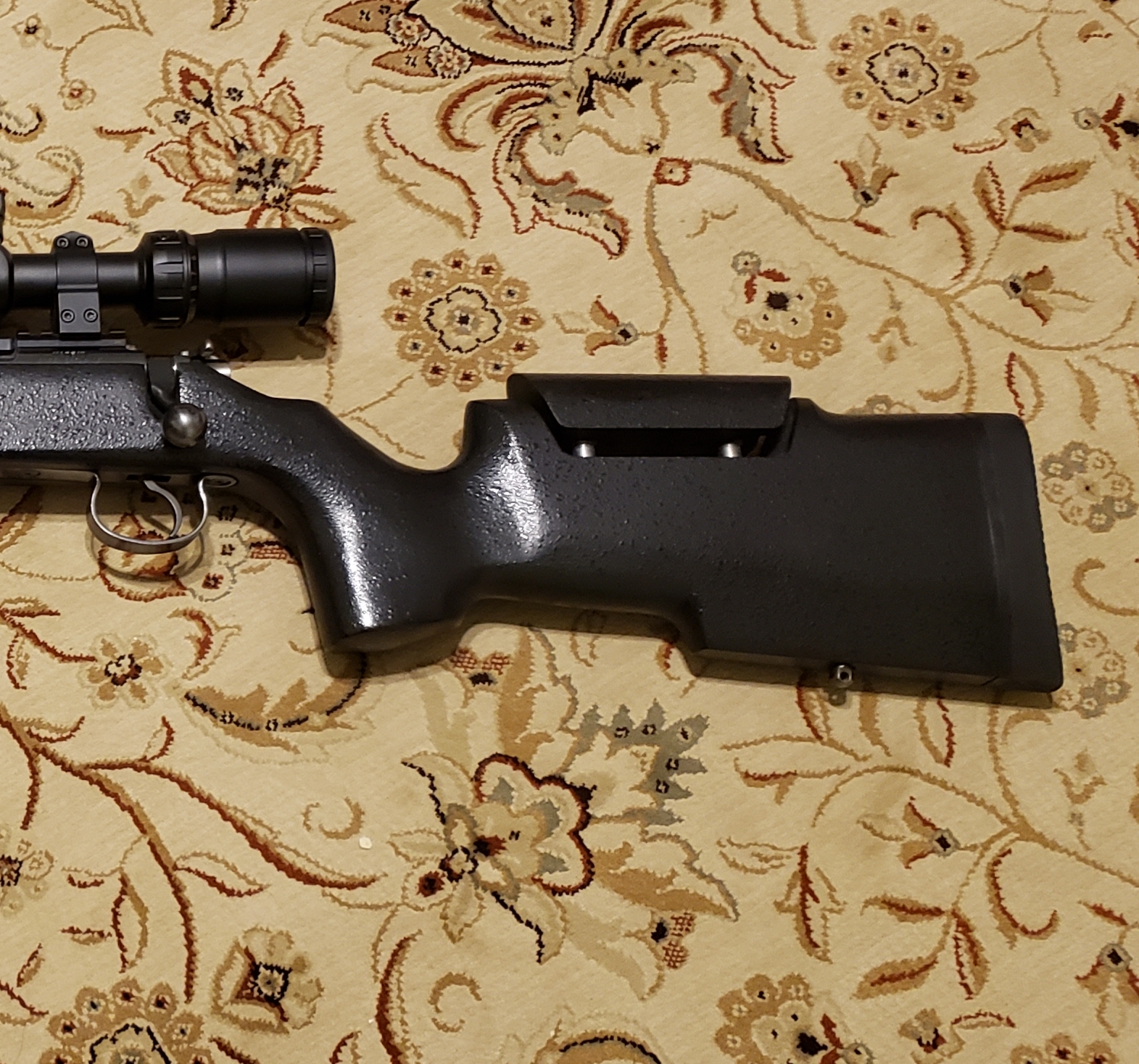

Op, the pro-varmint adj cp on my stock can extend upwards of 3/4 to possibly 1" inch. The drop in comb with the cheekpiece at its lowest point looks around 5/8". Here is a pic I shared with another fellow 452'er, settings with high rings on a 25 moa base. I recently swapped out optics to a 50mm obj with med rings and actually lowered the cp a tad.
Thanks Shifty, that's what I was looking for. Think I'll go with the Pro Varmint as the Rimfire Hunter doesn't look like it will help my cheek weld issue.
