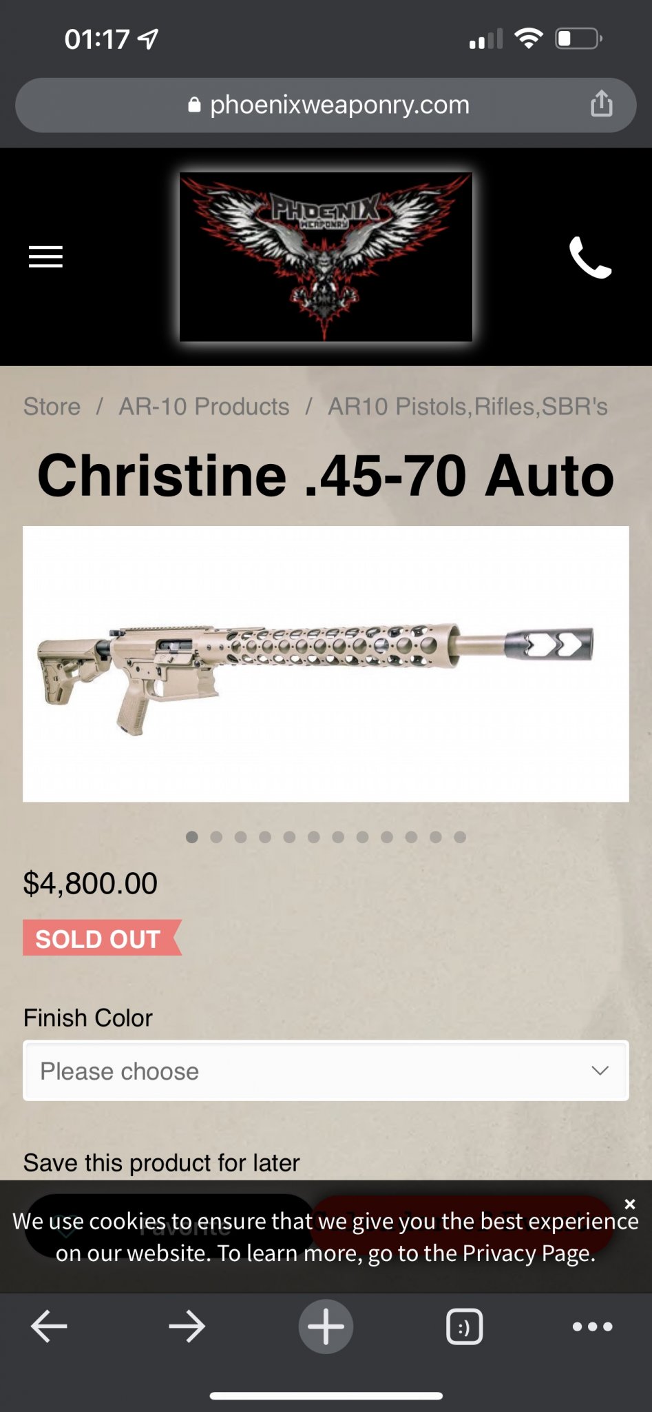

    That may actually be better than the 300 win mag AR10s.
    I doubt he 4570 probably wears out the throat as quickly as the semi automatic 300 win mag
