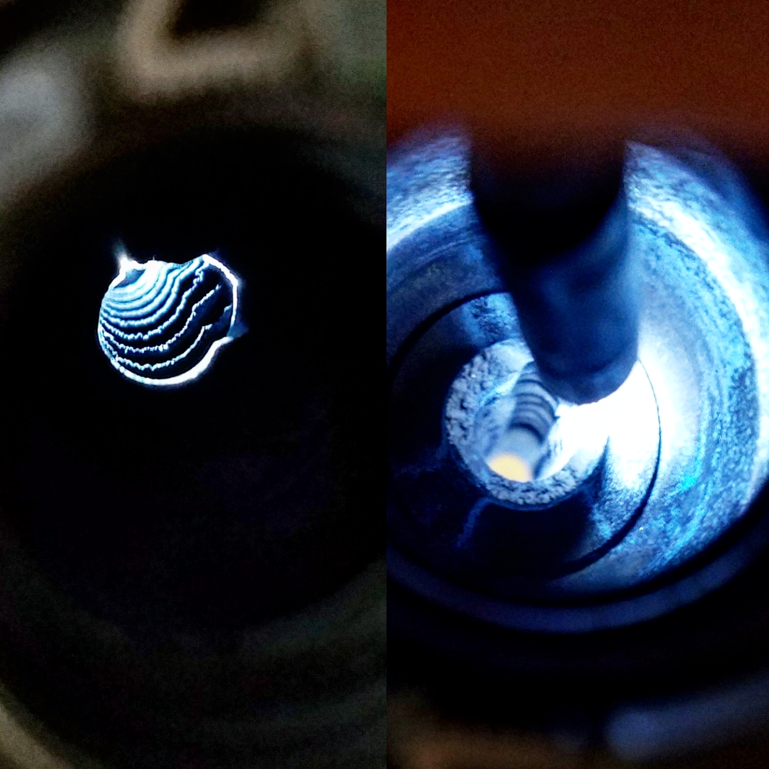

    I remember seeing a post (think it was a SilencerCo Omega) where you could clearly see the erosion on the blast baffle from a 3 point flash hider
    You mean this one? Sico omega run with a 3 prong on a 10.5" AR (600 rounds) and a handful (200ish) 308 rounds on a 20" bolt gun. That's not carbon...
    That could be it. I thought there were pics of the blast baffle with pronouncing 3 prong wear marks. Either way that’s low low round counts on a can
    Ahh I think I remember that one, was around the time I posted asking about this one. It's hard to see on mine but where the 3 prongs line up the blast baffle edge is far less eroded. It's the 2 glare spots (3rd covered by the light).

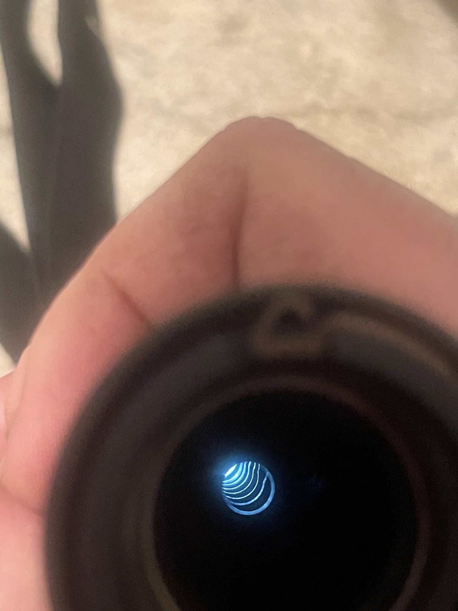

    Saker 556 ASR with about 800-1,000 rounds of Fiocchi 55 gr fmj. 10.5” FN barrel SBR. Brake
    This includes some LE training and a Magpul D60 mag dump
    Never cleaned
    Never cleaned
    Interesting. Mine was from a class also on the 10.5". No wear when it came off the 20" bolt gun. I used wolf gold for the 600ish rounds I put through it. Fully expected it to be harsh but not as bad as it shows.
    Wonder how much ammo/powder selection makes a difference.

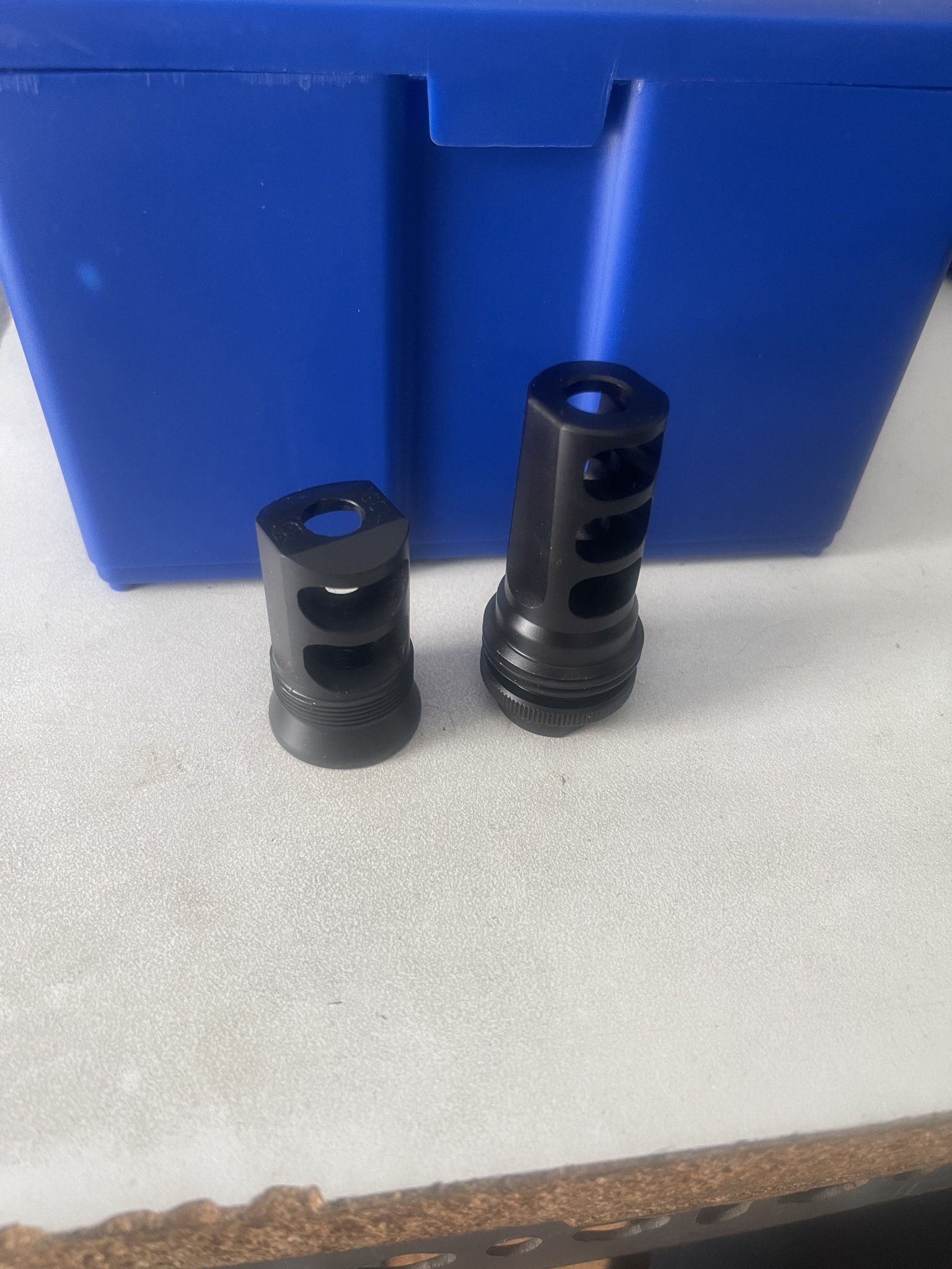

    I would say the more baffles the brake has would help more than anything one inside the can. As the “brake” ports no longer will do anything at that point
    Most suppressor companies like SilencerCo or TBAC only have one type of brake and one type of flash hider for the host mount on a can
    Here’s a SilencerCo ASR next to a TBAC CB brake.
