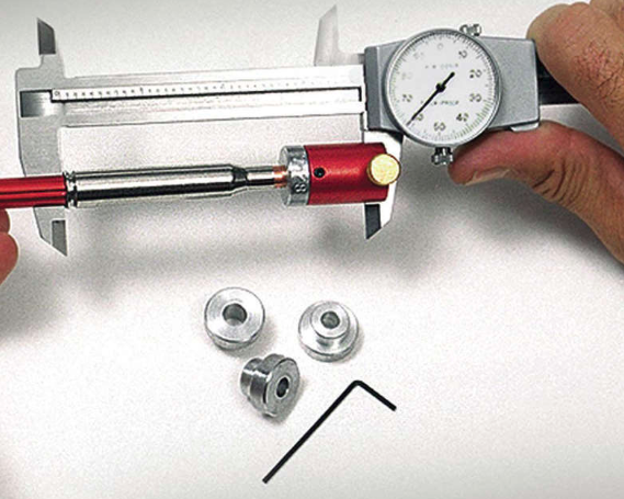

Igauging calipers can be had for 50 bucks, much better than the cheap 20 bucks harbor freight/amazon knockoffs with the hornady headspace comparator bushings and bullet ogive comparators.

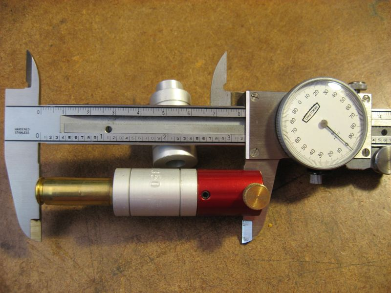

Seriously though, get the hornady headsapce comaprator and bullet ogive comparator to throw on the calipers. Its so much easier to get real measurments and know what effect your actions are having on the brass.
