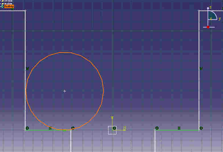

2mm might seem pretty small, but here is a sketch demonstrating the relative size of a 2mm sphere in a small rifle primer pocket:
as you can see, it doesn't quite get into the corner of the pocket. Basically, it would miss the outer 1mm where the primer contacts when seated, which is .0394"
