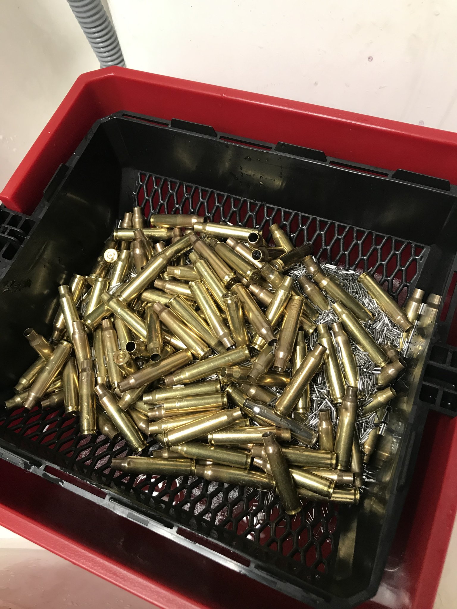

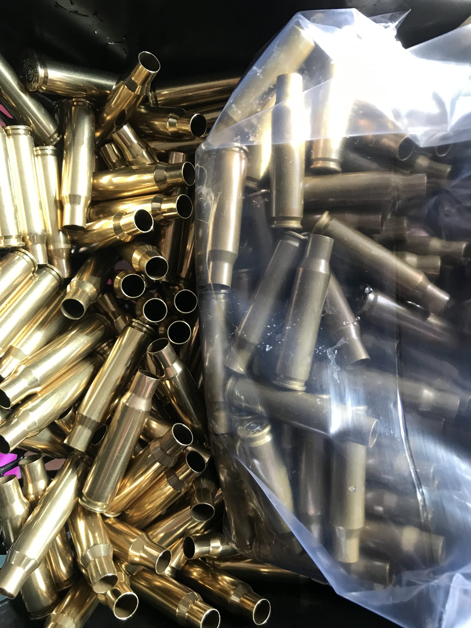

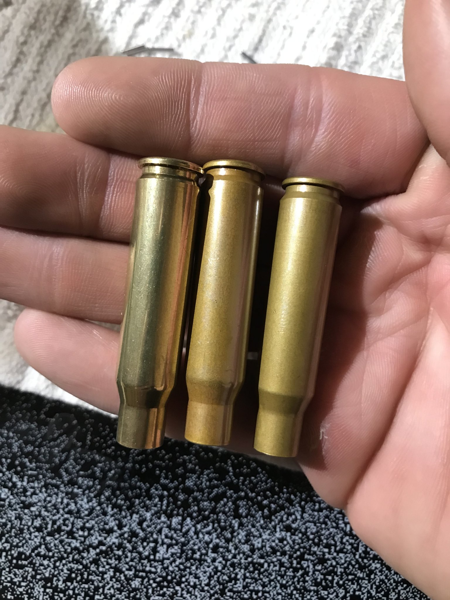

I just started getting into reloading. I got a new Hornady stainless steel tumbler for Christmas. First set of brass came out dark, as in old surplus dark. Second set came out ultra clean and shiny. Both of these loads were ran for 3 hours. I only added soap, water, and some white vinegar. Third try I put a few of the very first load in, and recleaned them. The only difference is I didn’t put as much brass in the tumbler. They came out dark gold.
I first thought it was because the stainless steel was dirty, and needed cleaned up. Second try it came out perfect. Third try it came out dark again.
Am I tumbling for too long? Too much vinegar?
On the plus side, EVERY piece of brass is clean.

Getting brass to come out nice and shiny requires the right balance of water to soap to acid. You can’t eyeball it. Get some precise measuring tools. I use a .7cc Lee dipper for the Lemishine and a table spoon for the soap. I use 1 tablespoon of Palmolive to .7cc of Lemishine in my Thumler drum. I can tumble 72hrs straight without any ill effect.
why are there primers still in those pockets ?
dawn ultra - 1 hard quick squeeze
lemishine - get a pinch and put half of it back, then add more. If your brass comes out orange....your using too much.
your water ph will play a part in how much of each you use.

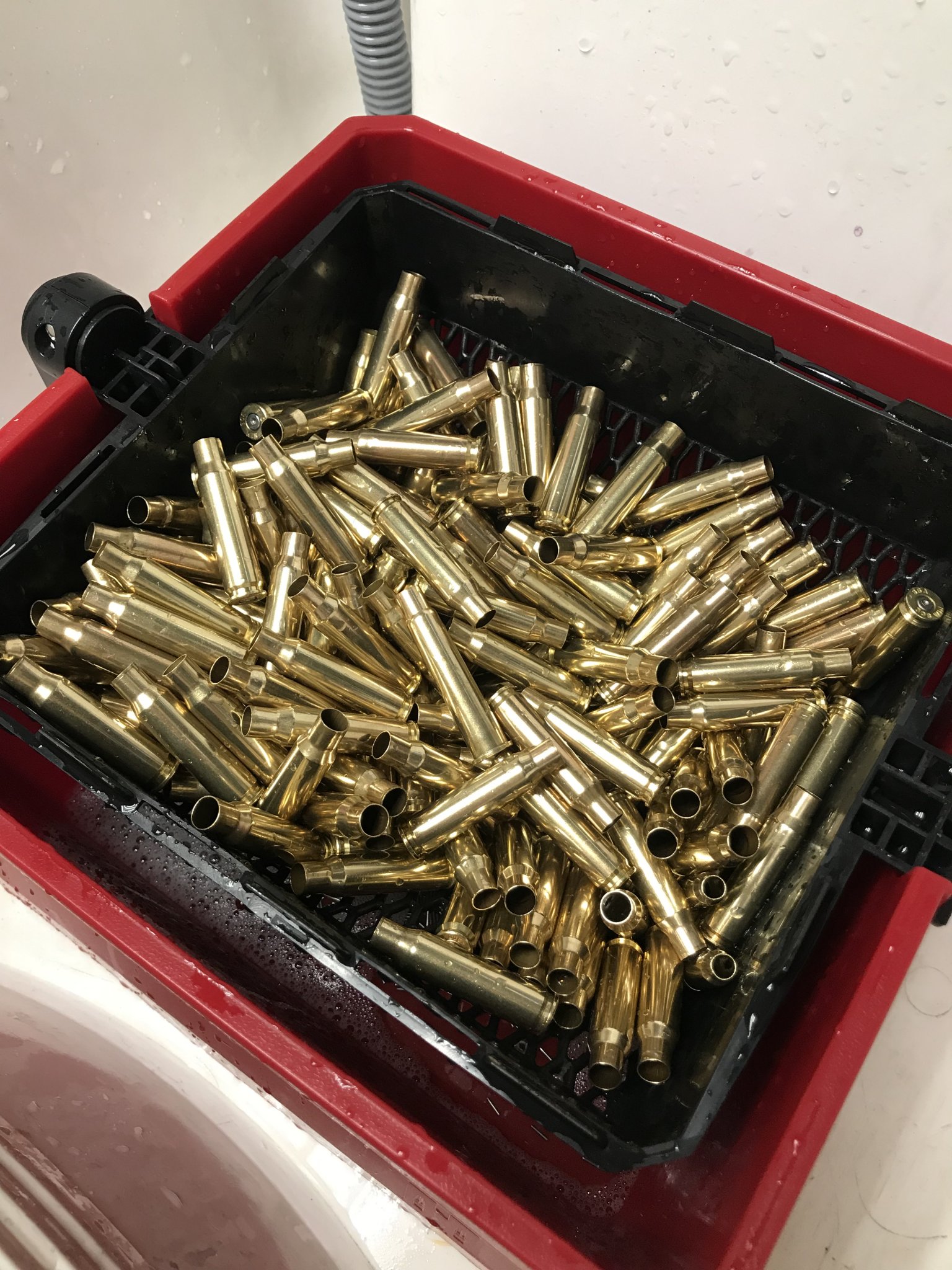

Primers are still in because I’m still waiting for my co ax to come off backorder. I even have the dies for them.
1/2 teaspoon of LemiShine
1 squirt of dawn
40 minutes
Freaking PERFECT! Thanks for all the help!
Need the lemishine 1/4 to 1/2 TEAspoon to get it bright. I like to use the cheap carwash with wax from Walmart instead of dawn. It leaves a slight wax coating that seems to stay bright instead of dulling out from oxidation. Ymmv.
