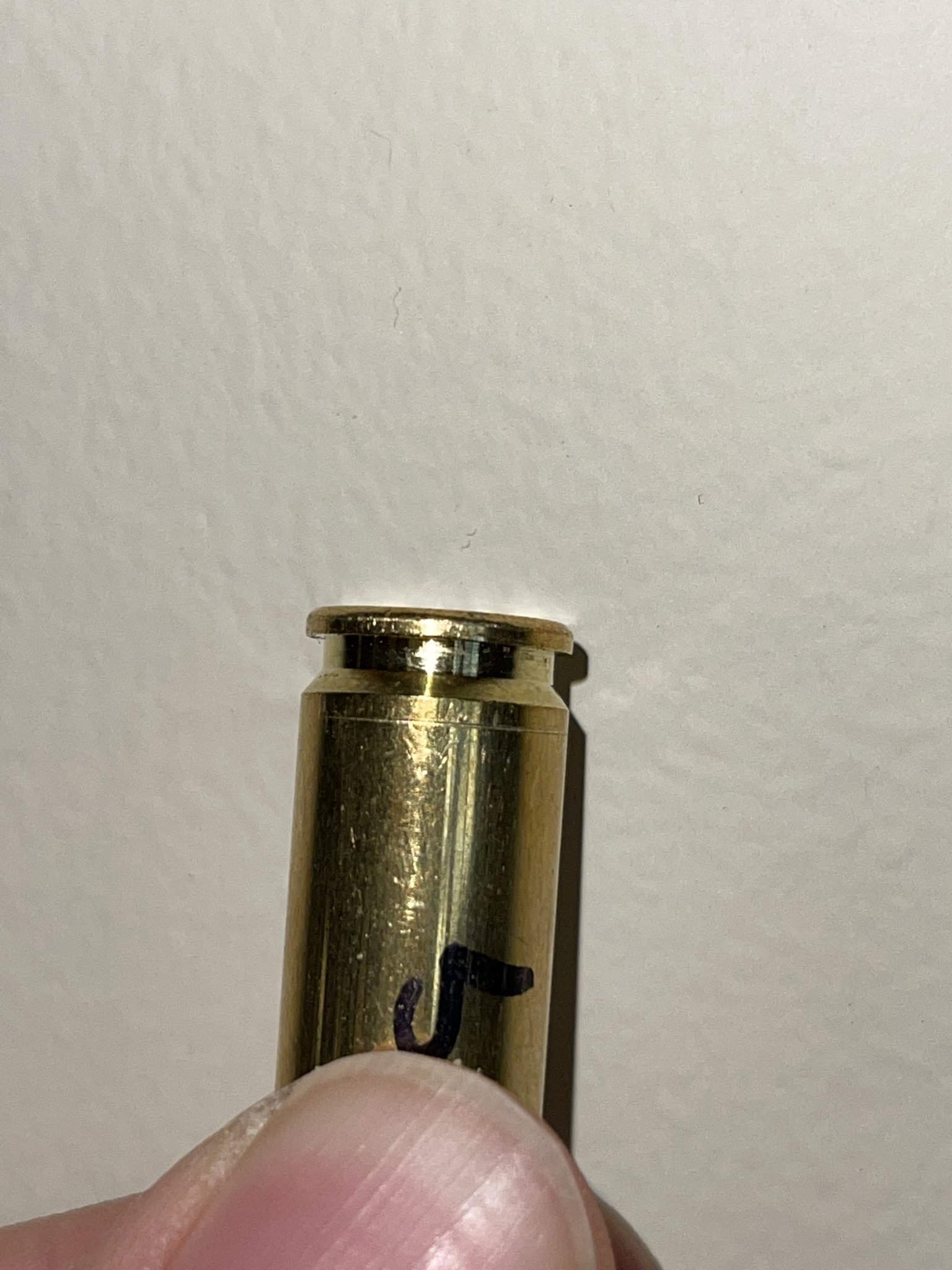

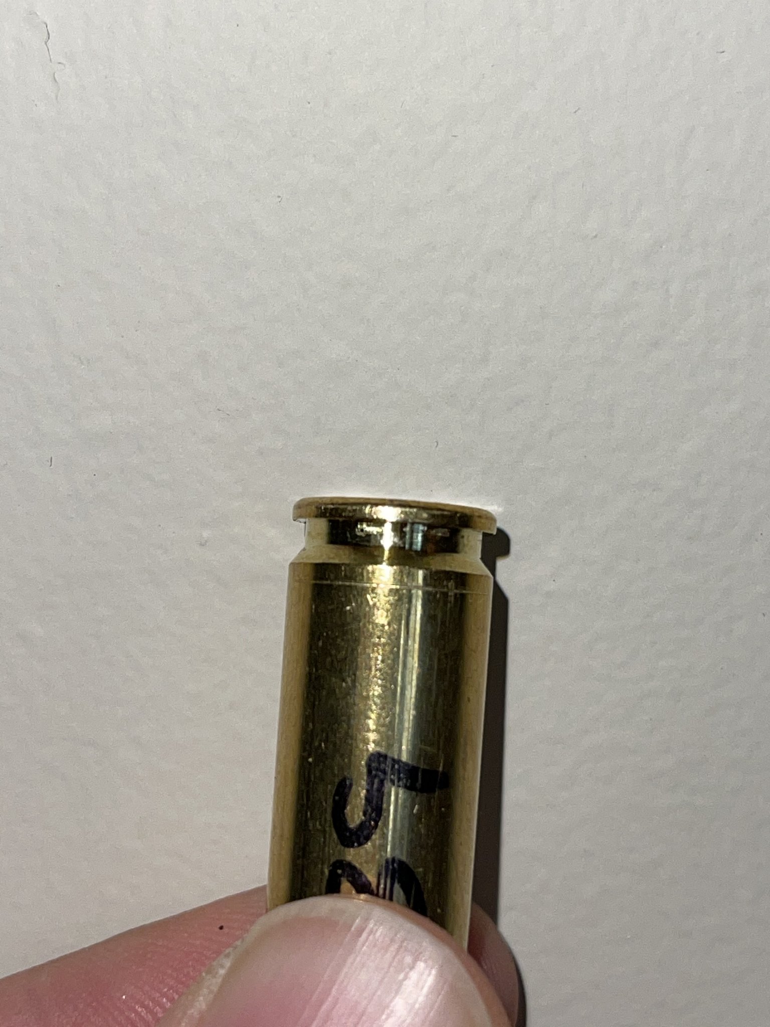

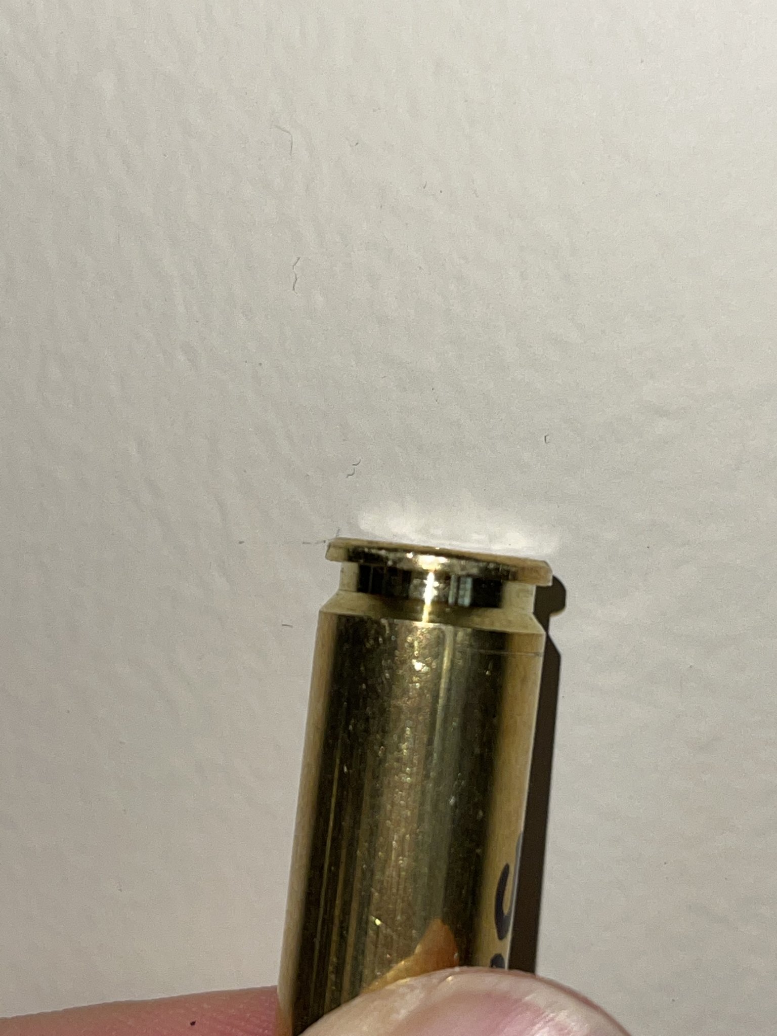

    Hey all, just wanted to get your opinions on something Weird going on with my brass. Every firing no matter the charge weight I get this line that looks like a cut about 1/4 of the way around the diameter of the brass. Pics below is 39gr H4350.
    I was doing load dev on a basically new barrel. 50 rounds prior to doing an initial load ladder to shoot a local match.
    Load & barrel specs are
    6.5x47 lapua 26”
    .167FB
    .295 nk
    Virgin lapua brass
    Rem 7 1/2BR primers
    135 A-Tips
    Started at 39gr h4350 seated 10 thou off
    Went up to 41 gr in .2 increments
    Brass growth between unfired virgin and 1x fired is only about .006” so I don’t believe it to be a headspace issue (?), but the line seems close to a headcase separation issue. I just don’t know how that could be.
    Any thoughts and opinions would be welcome! Thanks!
    Looks like the unsupported area of the case at end of barrel with a chamfer.
    Cases typically separate at least another 1/8-3/16 up the case.
    Thanks. That what I was thinking too, but just found it weird. I’ve called the smith already and he said to send the barrel back so he could look at it.

    I second steel head's assessment. You're fine. If the smith wants to clean up his work, I'd let him. Just for kicks.

    Looks like he had a poorly finished or worn-out reamer...Or a shaving or chip got in there and wreaked some havoc while finish-cutting the chamber. It doesn't look too deep on the case (but I haven't seen pics of the chamber, so just guessing), but probably just needs a good chamber polishing to correct it.

    That’s in the stoutest area of brass, I’d 95% keep shooting that brass from what the kinda bad picture shows

    I imagine its normal to chamfer the leading edge of the chamber. Maybe he missed this step.

    If that's from the first firing, you should be fine to reuse it. As others said it's a chamfer on the edge of the chamber. Your Smith can fix that easy, just probably had a brain fart and didn't do it originally.

    Looks like smith left a burr when cutting the chamfer.
    Brass is probably GTG.
    May also be a ridge at the spot where the chamber flares out and the brass is unsupported. That chamfer or flare is cut after the chamber. And in cutting the chamber, there can be a tiny bit of surface hardening caused where the tool cuts out metal. Then When you cut a chamfer, that hard surface translates into a tiny ridge as the tool doesn’t cut the hard area as deeply as the softer metal under the surface.
    the brass looks fine, and if things are not hanging up, chamber is probably fine. Those little ridges in the throat can usually be removed with small round fine polishing stones and a bit of kerosene as lubricant. They would lap/ polish out easily.
    likely, as pointed out above, you could detect with a small probe that you drag out if the chamber. You don’t need pressure! Don’t scratch the chamber by aggressively using a dental pick. But with a sharp point and very light action dragging it, you may find a tiny ridge right where the chamfer begins at the back of the chamber.
