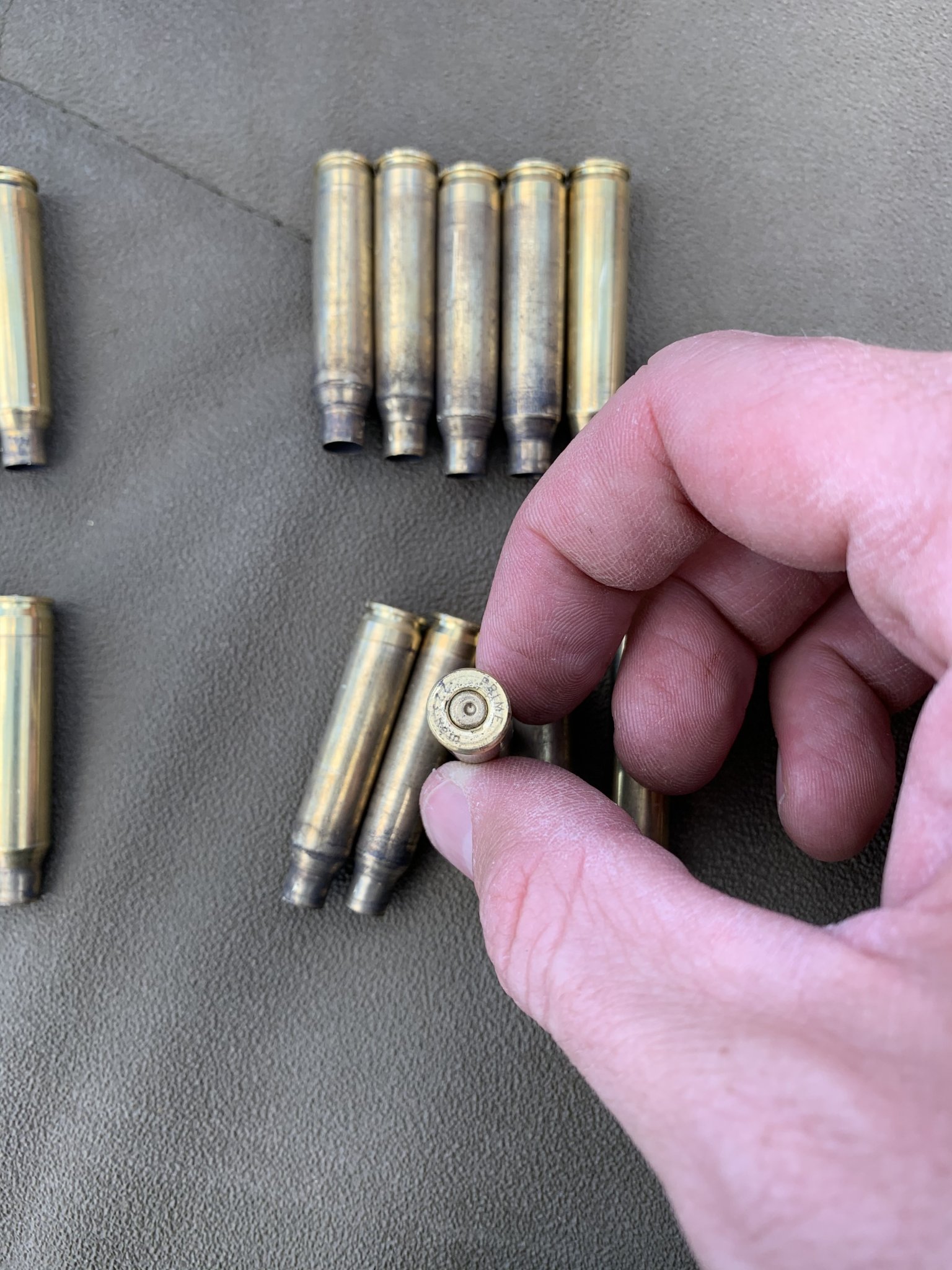

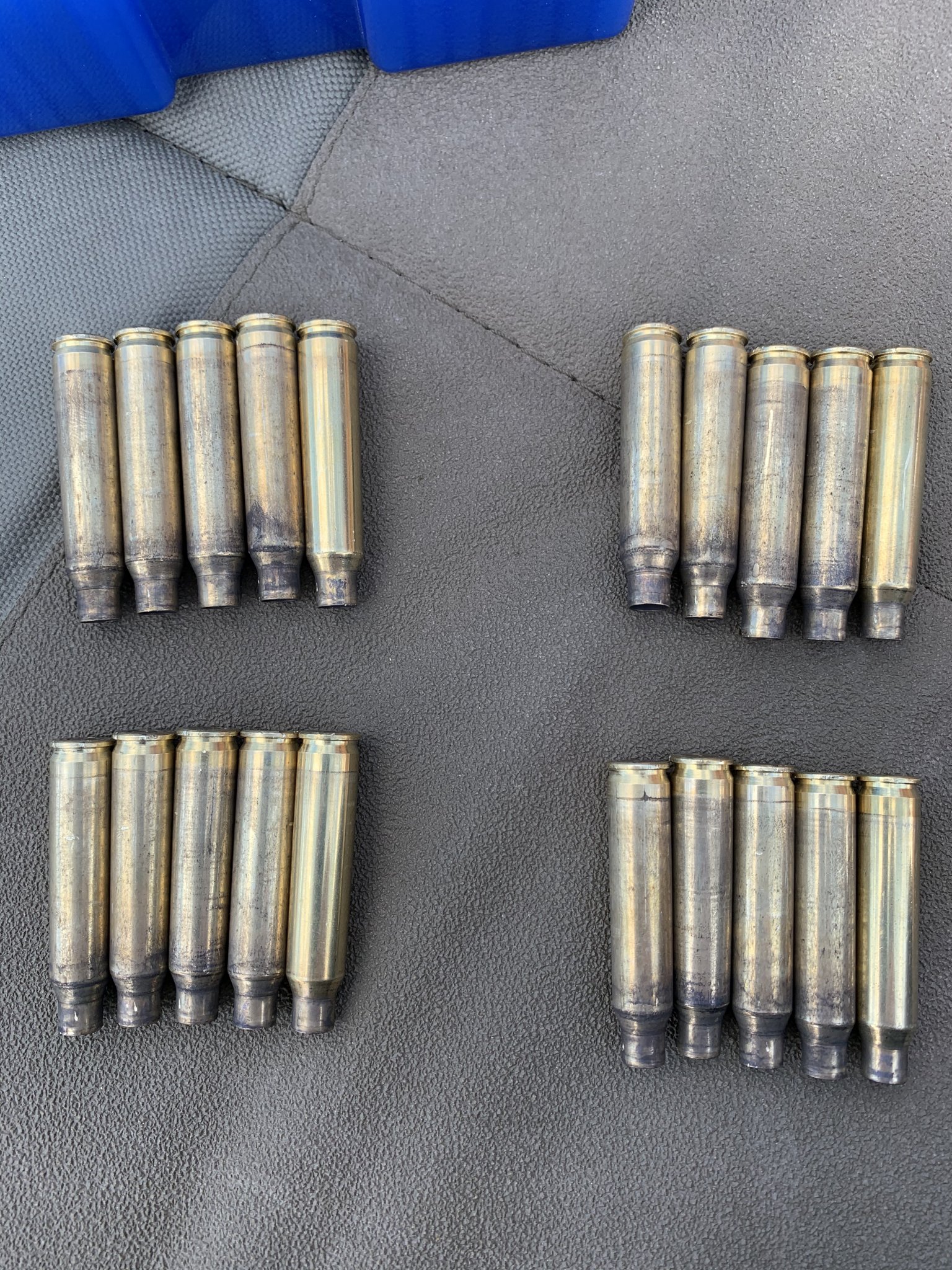

Can someone explain what’s going on here with the obvious differences in brass discoloration after being fired, and if it’s anything to be concerned about: A67A0D5A-8152-40F9-89E7-906AEA1A4A48.jpegA6AB4AED-DF6F-4D34-B601-09998B1C5EDC.jpeg
I have once fired (in my rifle) Prime 223 brass, resized with a Redding non bushing die, bumped .004. These reloads are 26.0 through 27.5 gr of CFE223 with a Hornady 53 gr vmax. Rifle is a BCM 16” AR, their SS410 barrel. The shiny piece is always the last case and always ejects to 5:30, while the other ones eject closer to 1:30.
What I'm seeing is the discoloration from powder gasses that escapes back over the front part of the case in the micro-second between bullet exiting the case mouth and before the case expands to seal the chamber. Not sure why the last case is cleaner. As for the ejection, the #1 through next to last has full bolt travel effecting the ejection pattern. The last case fired has the bolt being caught by the bolt catch.
The last round does not have any upward pressure on the bcg.
It's going to eject different and a lot of time is a flier out of my groups.

Do you think the bottom of the case isn’t covered in gas because it didn’t get resized in the process so it’s already sealed to the chamber?

Your brass looks pretty normal with the 5th round exception. I have not noticed that in my gas guns, 223, 300blk and 6.5g.

I really dont think you have a problem.
Maybe @spife7980 would take a look he is good and helped me a lot.
That last clean round is still puzzling.
