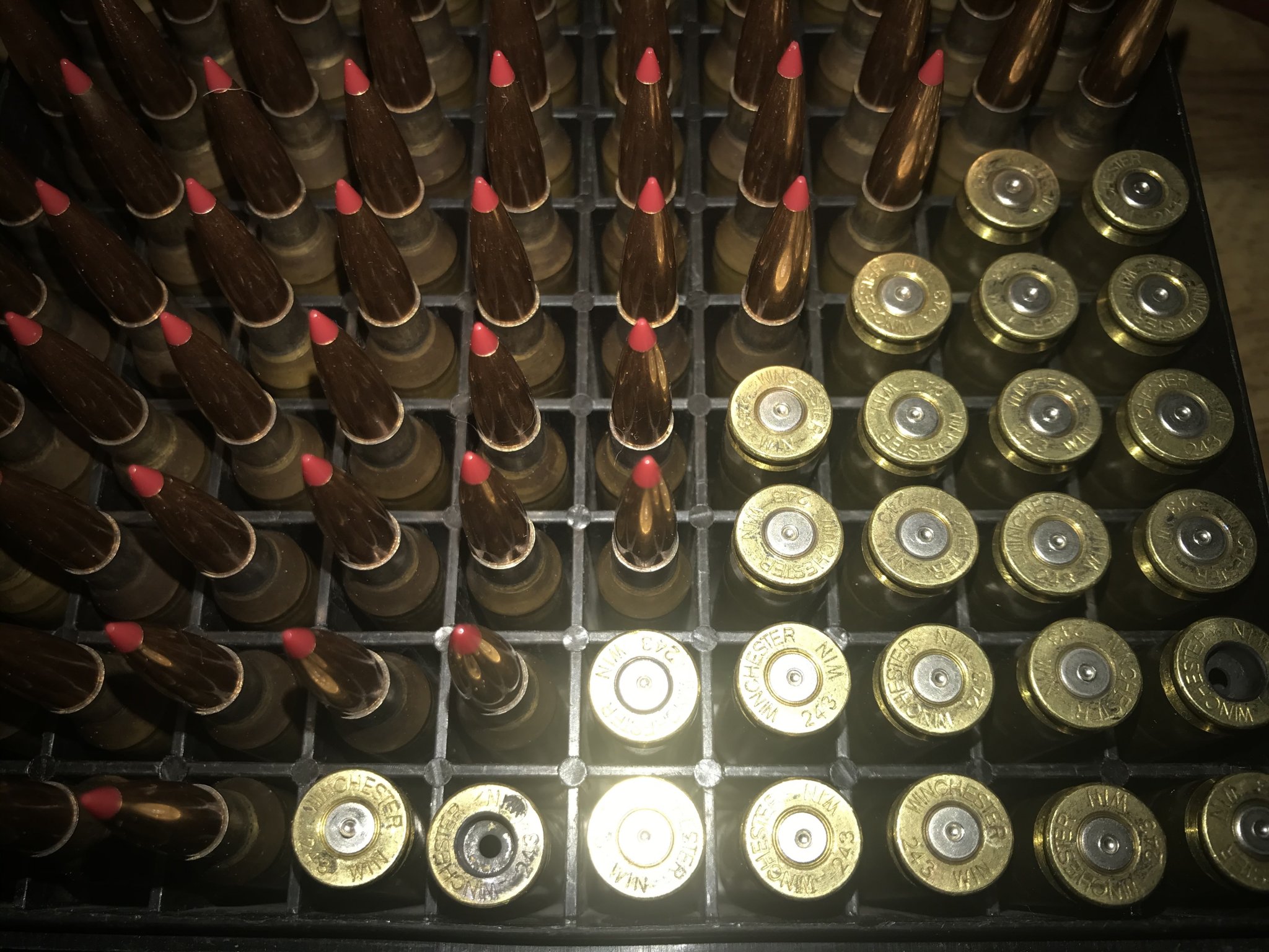

How loose is loose? o_O ?
This is too loose.
Reactions: roostercogburn98
Yup.

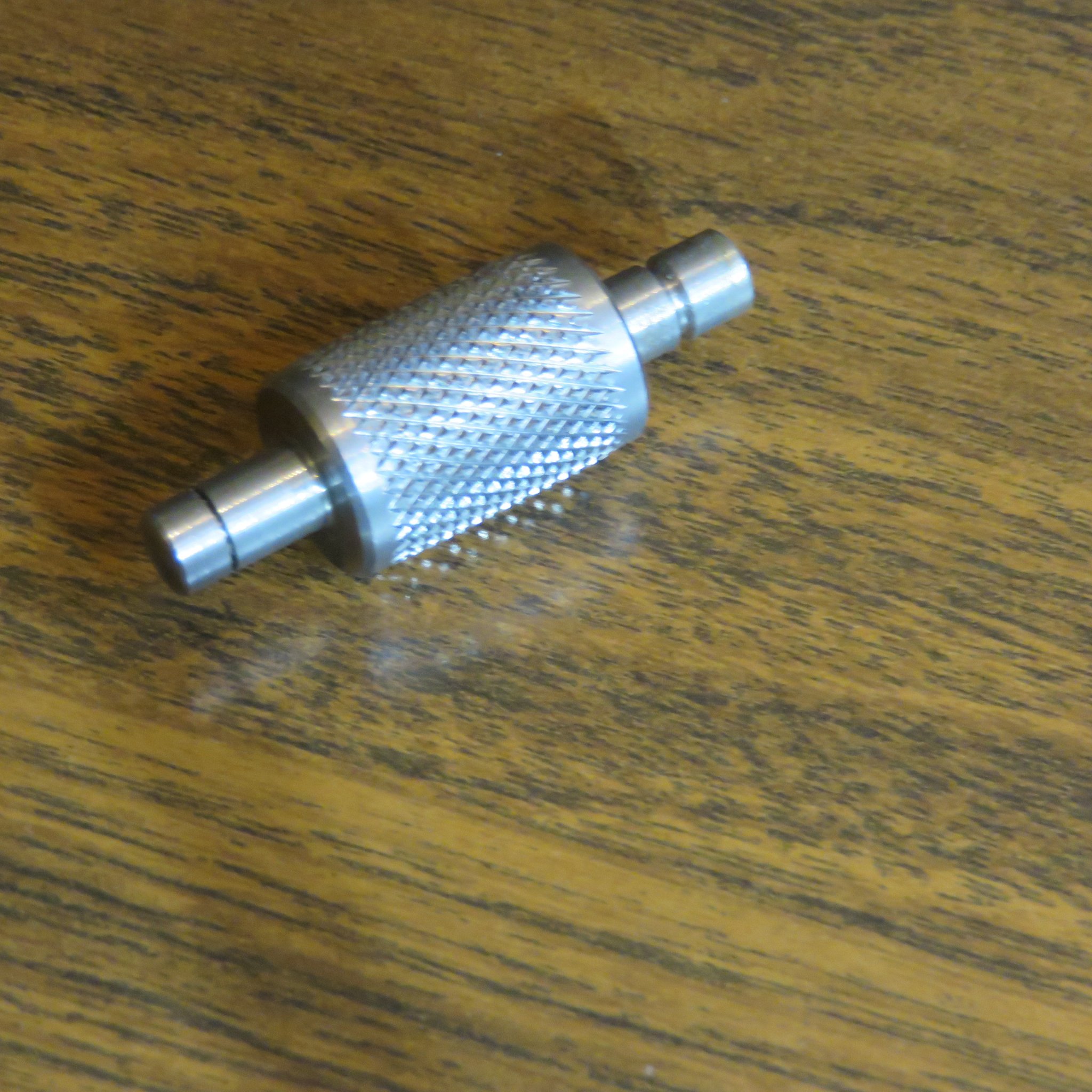

Rather than finding out this way, I simply use a swage gauge after each firing and trash canning any that the swage will slide into. Though some pockets can feel a bit loose when priming, they hold up as long as they pass the swage gauge test. It's really the only reliable way I've found to know when the pockets are actually too loose. I hate guessing and throwing away perfectly good brass. . . especially when I've invested a lot of time precision tuning them.
For those who haven't see such a swage gauge, here's a pic:
