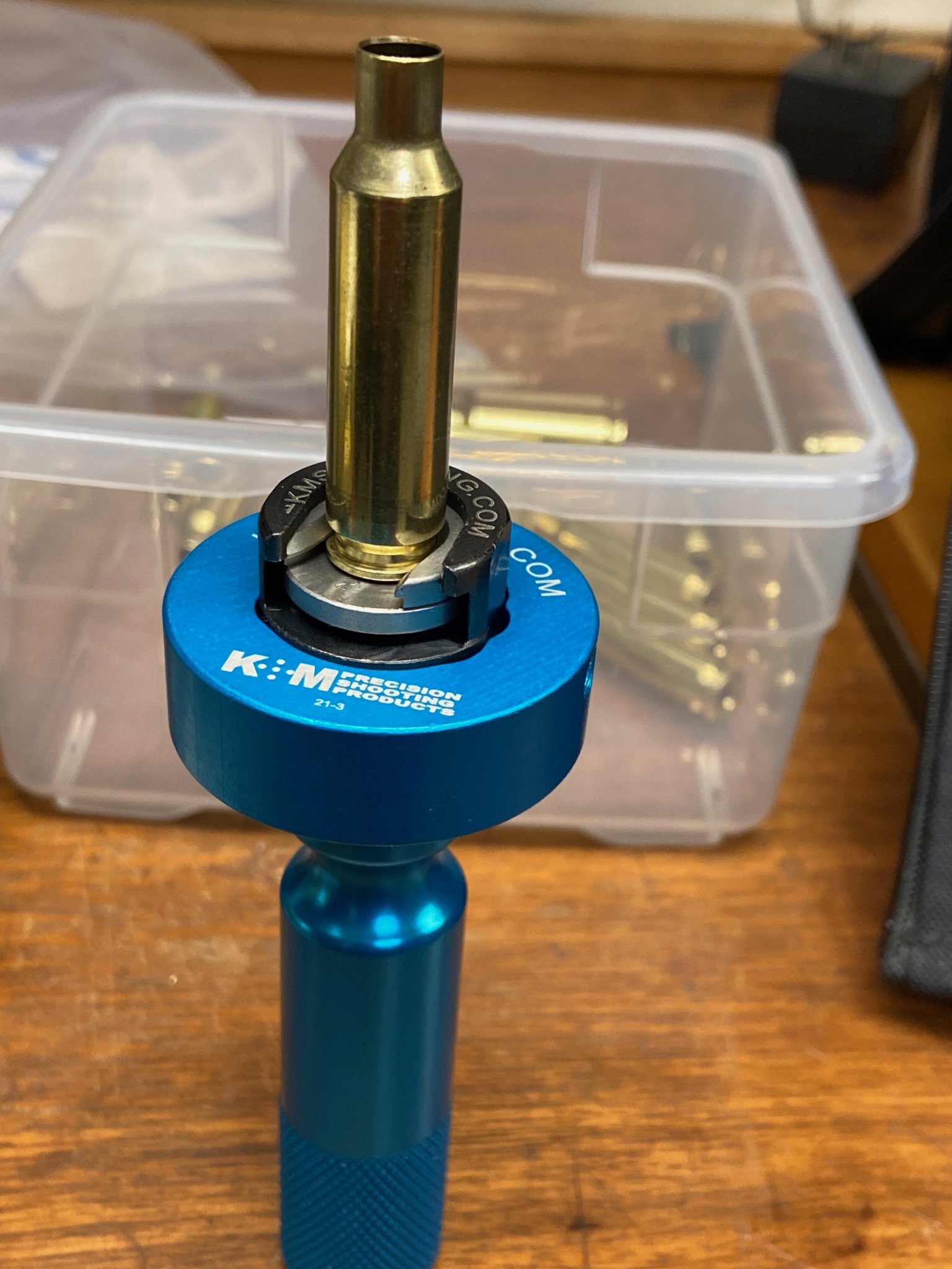

    For chamfer/debur - I like the K&M tool for precision loads, and a generic RCBS tool for everything else.

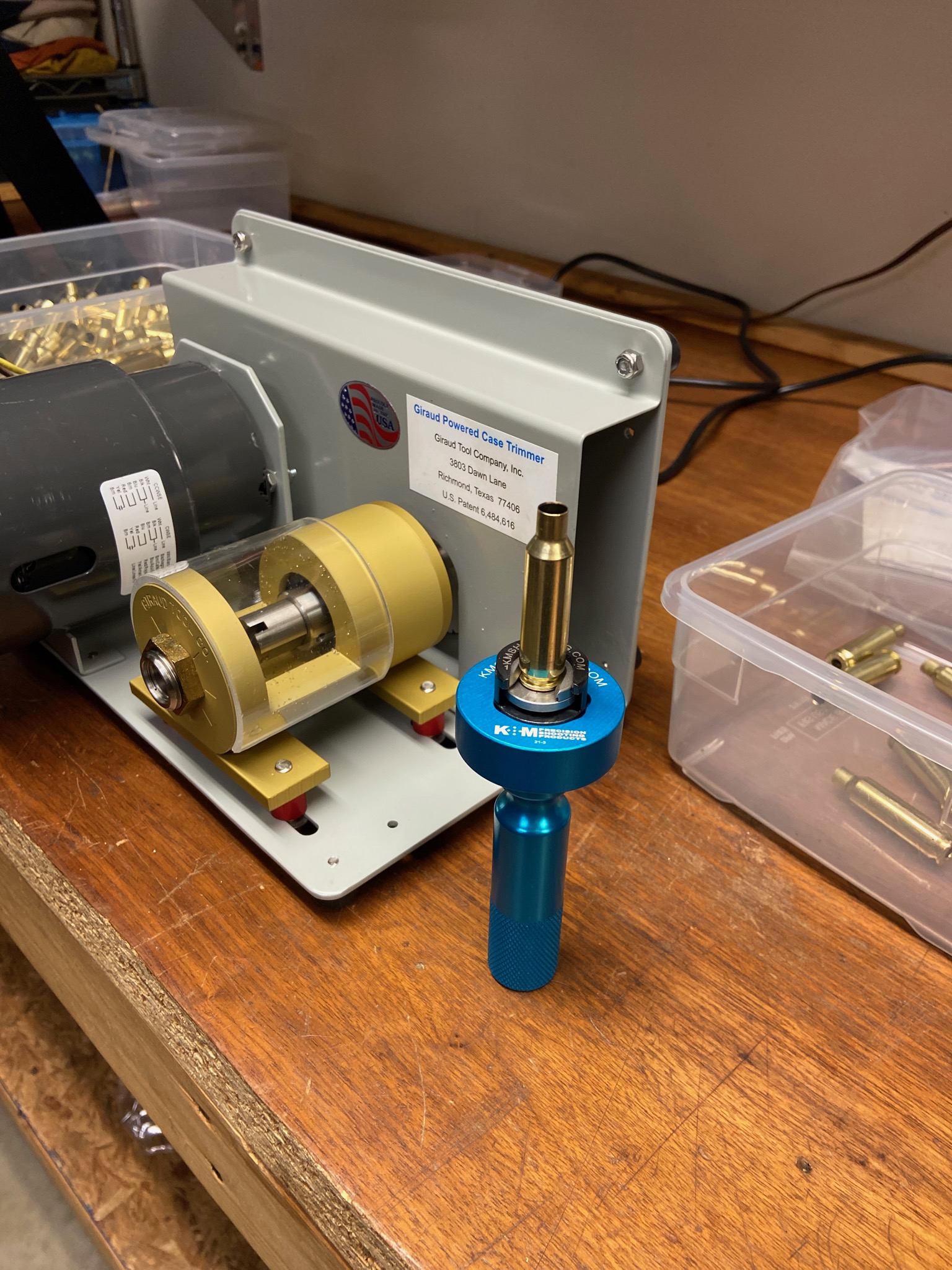

    giruad money…I’ve owned 2 girauds and now a Henderson Wish ida just bought the Henderson when I bought the second giraud
    I just bought a Giraud after using my friends for a while.
    I now wish I had gotten the Henderson.
    In 2003, Giraud made a product change and went with an electric motor w sealed bearings vice the previous motor that req you to oil the bearings periodically.
    Guess what motor I got on mine? Yep, old style motor w unsealed bearings that need to be oiled.
    When I questioned Doug Giraud about this, as his online manual still says he changed to sealed bearings in 2003, he replied that the other company raise the price to him by 15%, which can’t have been more than $20-30, max. Back a reasonable margin out of the sale price and I think you too will come up with a similarly small amount.
    He had the choice of absorbing this cost, passing it on to customers which would still leave it well cheaper than the only other comparable trimmer (Henderson), or split it.
    instead he dropped back to a fucking electric motor you have to oil or you’ll eventually burn the bearings….without any change to the online documentation.
    In the manual, it says to oil every 1-2k cases. Now that he’s trying to push this old style motor again, he’s stating it only needs oiling every 10-20k cases and it’s the exact same motor as the one mentioned in the docs. I don’t trust or believe him, frankly, and he provided no rationale for the dramatic change in oiling frequency.
    And I’ll be fucked if I’m going to keep a round count log on a trimmer. LOL
    I addressed this thru the retailer I ordered it from, Creedmoor Sports (who I absolutely love, not their fault at all), they reached out to Giraud, and the message that came back basically that I got what I got, end of story.
    Certainly not the end of the world and if I fry these bearings I’ll get a Henderson. But I will not do business w Doug Giraud ever again
    but let me ask you guys, do any of you have an appliance class electric motor newer than 30 years old that needs oiling?
    Anyway, if I had to do it again, I would go with Henderson and that’s my whine for the day. Haha

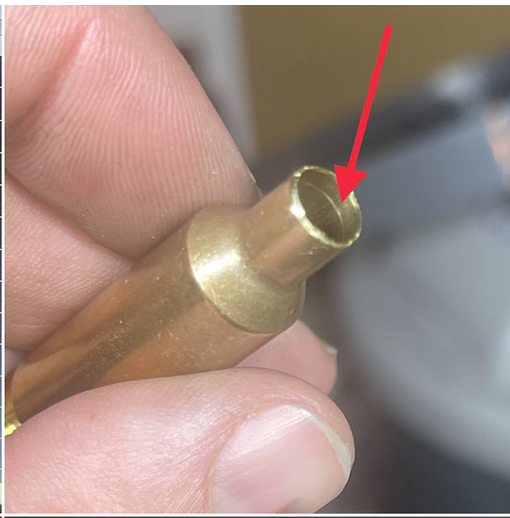

    You want a design that holds the case exterior, ie the old conventional wisdom?
    Just by it’s very nature, if something requires a pilot to work, it will always touch. Otherwise the pilot would not be needed (giruad, IDOD, etc don’t require a pilot).
    The minute the brass touches the pilot (almost always) it will always be touching.
    AFAIK Both the Forster and the Henderson use pilots and the same setup/collets etc.
    even the cutters I think all are made by Forster...
    The Henderson pilots and cutter were Forster but have moved to their own design a rev or two ago.

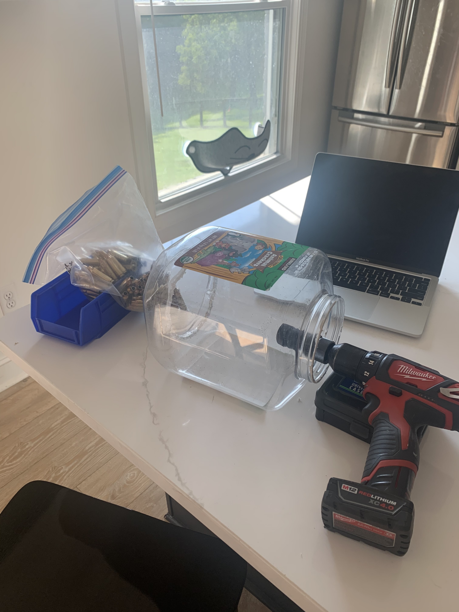

    Plus, with the help of a repurposed giant container of animal crackers, I can trim almost anywhere in the house without leaving a mess 🤣:

    I agree that the way Giraud handled the bearing change was incredibly poor.
    As to the pictures, the pilot was chattering in the neck. The graph from the AMP press showed inconsistent seating pressure as a direct byproduct.
    The further comments from @Dthomas3523 and @orkan were that the Giraud being pilot-less do not cause this problem.

    Any idea what caused the chattering? Was there some kind of malfunction or loss of proper set up at all?
    I did get that they were discussing the pilot and it’s deleterious effect on the neck and seating pressure shown in the graphs.
    I no ask because unless I’m mistaken ( which happens all the time lol) are there not a lot of very knowledgeable and expert precision reloaders who successfully use the Henderson?
    That rough chewed up neck lip seems like it would be obvious even to a novice like me and I haven’t seen any other bad reports on this trimmer.
    I wouldn’t call it chattering, it’s where the pilot had some galling on it which is what scratched the inside of the case necks. Polish the pilot clean and it goes away (until it gets galled again). Galling is just what happens when unlubed metals run on each other.

    Ah, I did...but no where that I saw was it discussed why Thomas got such a completely and obviously ugly neck lip while many other highly competent reloaders use a Henderson without complaint or issue?
    That pic of the neck is fuggly as can be. To me, this looks obvious as hell and could easily be detected via naked eye and just running your finger over the lip.
    Think the lip looks worse than it is, the auto-focus went more to his fingers. The issue is the ring inside the neck.
    The new wrinkle is now being able to precisely measure the seating force change caused by that and have it persist on a screen.
    Maybe you'd see it on a fluid pressure seating gauge, but not as easily or in a way you could graph.

    @ma smith - if I recollect correctly, you are most likely not interested in trimmers at the price point of a Giraud or Henderson, right? And no shame in that....we all set our priorities according to our own lights...IMO. haha Some like Bushnell while others will spend for a Tangent Theta. And so the world goes around.
    BUT, if you are interested in a Giraud, one of the chief complaints is the impact on your fingers of holding 200-300 cases in their pilot against the spring tension while cutting. If you are just refreshing a chamfer to brass that had already been trimmed to your desired length (and not grown much), then its not nearly so bad but still can get annoying. If you are cutting back...I dunno....say .005, then the vibration of cutting will def get to your fingers.
    Gloves are an option and, before I got my trimmer, I used my friend's a number of times (with his sealed bearing...the fucker! LOL) and used some reasonably thin, grippy, close fit gloves which helped. But the problem with a lot of gloves is that I found I had to squeeze even harder to hold the brass against the slight compression of the glove material and give it a twist while against the cutting head, which is recommended (see his manual).
    So, I found this, which works very well but may also put people off for price. Also, I think this would work lovely for hand held drill powered trimmers and other hand held tools.
    Its from K&M and there is a cylinder that comes up from under the shell holder when the big round part is turned and locks the case into the fixture firmly.
    It only takes a 16th or so of rotation of the round part to lock in/release the case so its really quite easy, quick, and kind of responds to the lack of something like the collet and handle that the Henderson incorporates (I actually suggested providing something like this to Doug Giraud before I found this K&M tool with zero response or acknowledgement....yeah, Doug is def off of my xmas card list! haha).
    It takes these parts from K&M to put this together....and, you don't really need the handle if you have something like it already....
    Power Adapter (#CHPA00) - $25.70
    Shell Holder - #2 (#SHLAP02) - $3.40 (note, this is just a Lee Shell Holder)
    Power Grip (#CHPAGRIP) - $20.95
    Power Adapter Handle (#PAHANDLE) - $12.90
    So, total of $63 plus shipping....and it really is a very nicely made piece of kit.
