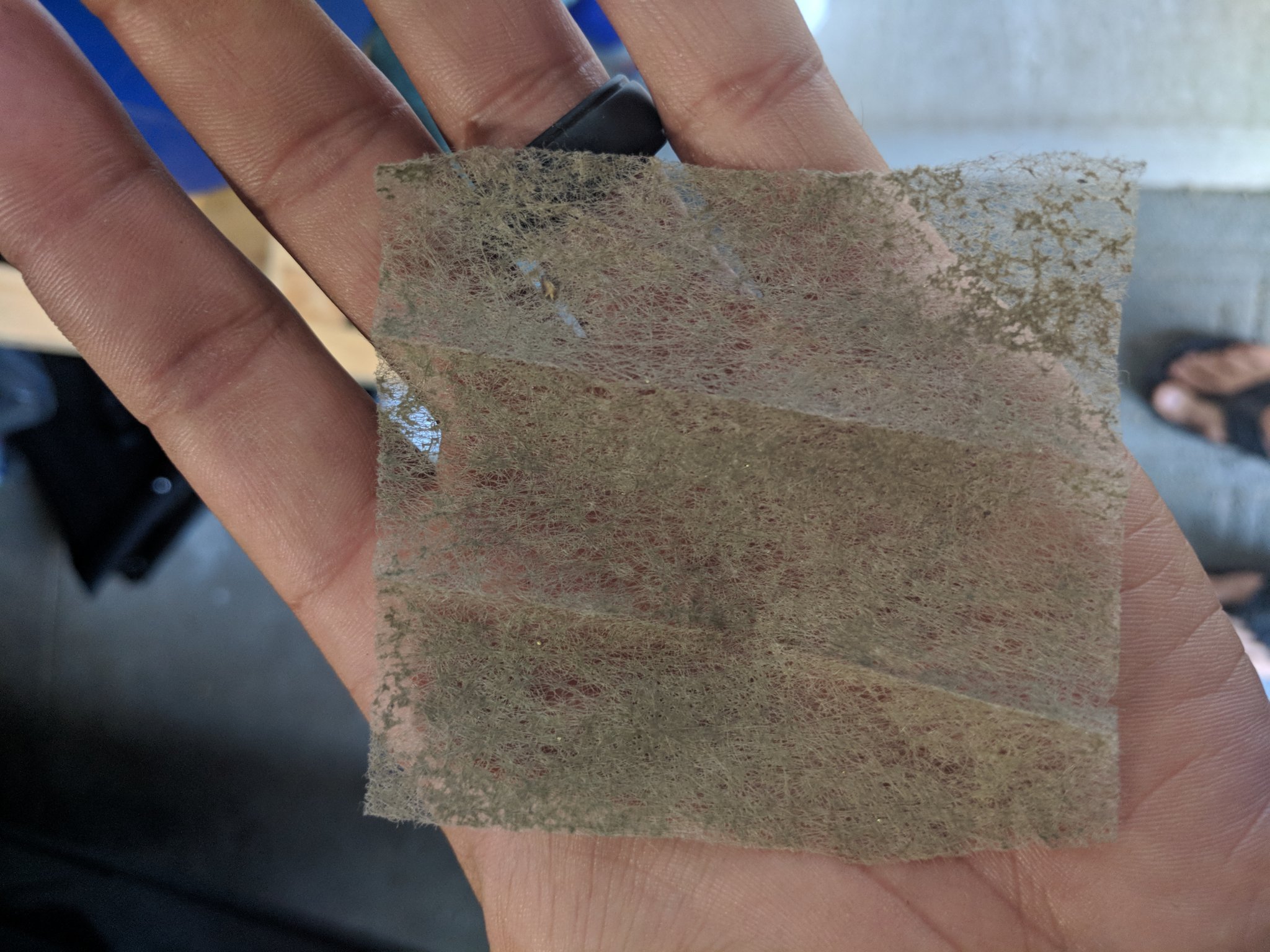

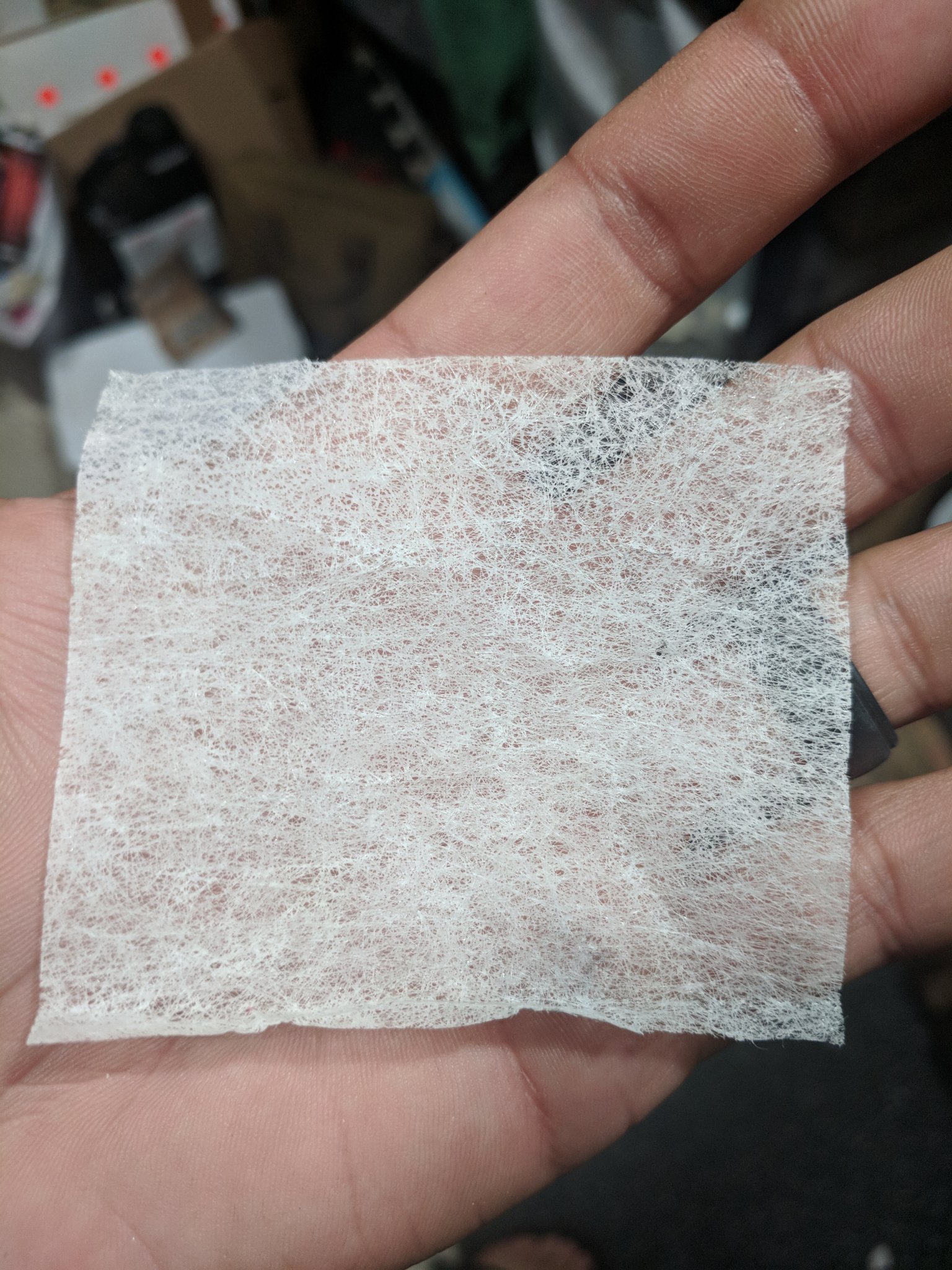

Here's a tip I thought I'd share in case some haven't tried or don't know about it.
When dry tumbling brass (whether corncob, walnut or other), cut up a dryer sheet (new or used but new works better) into 3-4" squares. Toss those into the media with your brass.
The super fine fabric of the dryer sheet catches the dust, lead, carbon fouling and keeps your media cleaner, your brass virtually dust free and pulls any crap buildup out of your tumbler. They usually last 2-4 tumbles before they are pitch black.
Shortens my tumble times to about 20-30 mins for bolt guns and to 1 hour with Semi-auto brass if I'm just cleaning for dirt/carbon on outside of case. Brass comes out of tumbler media with way less dust, lessening the amount of cleaning needed before resizing, saving your dies from extra wear over time.
I've switched from corncob to walnut as it seems to work faster and comes out of cases easier.
Here's a before and after:
Good luck and happy reloading!
Awesome tip. I do the same thing but cut long 1” strips and pinch one end between the lid and the bowl. You are correct; this works very well.

I do the same thing and haven't noticed any residue from the dryer sheets ending up on the casings. I just use plain dryer sheets, no scent or anything weird like that. When I feel the dryer sheets by hand, I don't notice any waxy stuff or residue on them that could end up transferring to the brass.
Before I started using the dryer sheets, I wasn't noticing any dust on the cleaned cases like the OP mentioned, but you can't argue with the fact that the dryer sheets come out looking fairly black so they are obviously picking up a lot of the dust/dirt/carbon residue which is a good thing. I use corncob media.

Lyman walnut media (untreated) has a fair amount of walnut dust from the crushing process. New media has more but the carbon and dirt from brass also has to go somewhere.
The dryer sheets simply help take that crap out; there is a noticeable difference in the appearance is the media after several uses with dirty sooty brass. Dryer sheets seem (and even paper towel to a lesser extent) help media stay newer looking, which to me, means less crap swirling in with already dirt brass.
