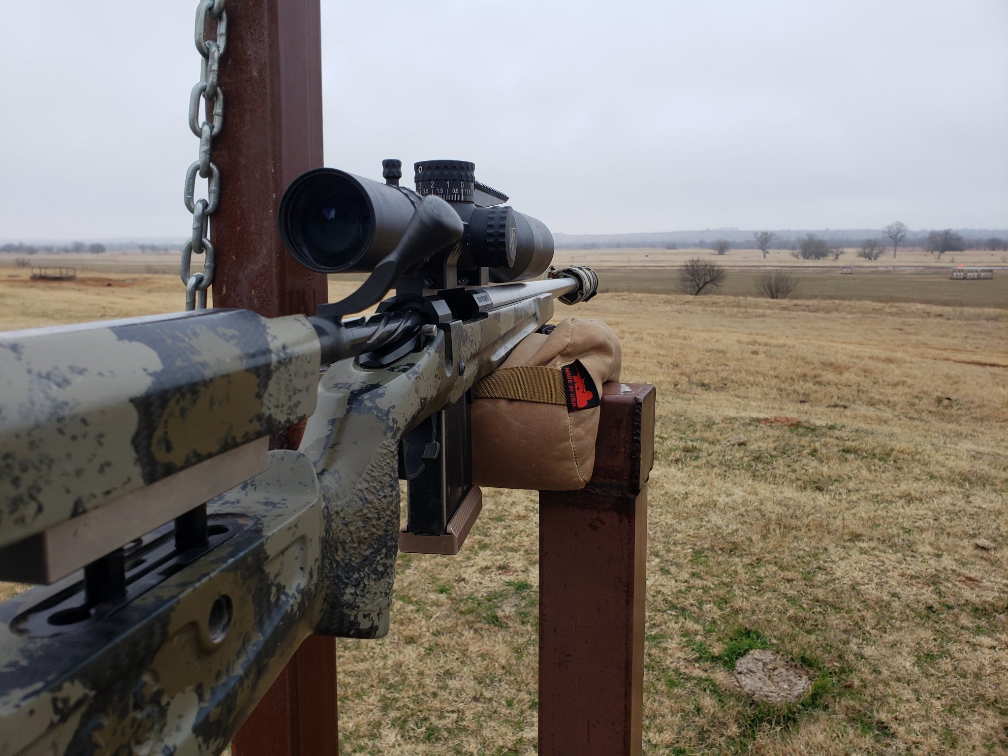

    I bought a tungsten car weight off Amazon and drilled for my manners.

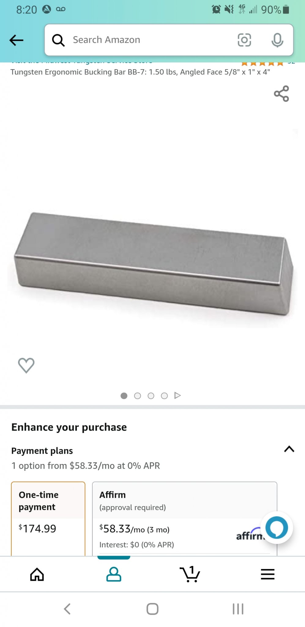

    Could you link to the the part? can't seem to find it on amazon. Thanks
    Here you go. It is a tungsten bucking bar. They have gone up a bit since I got mine but it still adds a good amount of weight in a small package. Be aware that drilling it is not fun.
    Ya I was gonna ask how you got holes drilled in it
    Drill press running slow and diamond tip drill bit cooling with cutting oil or water frequently.
