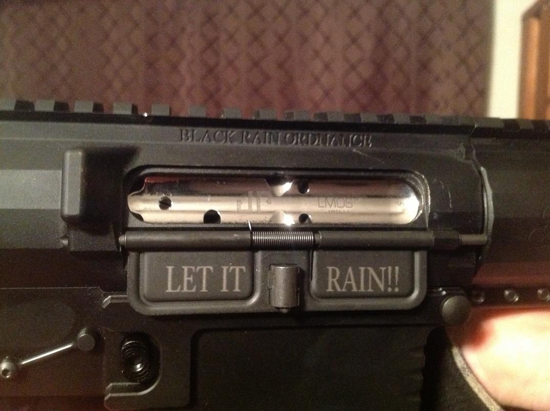

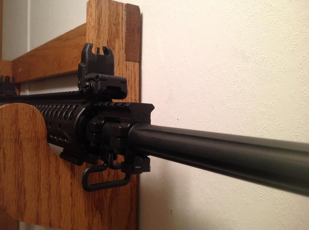

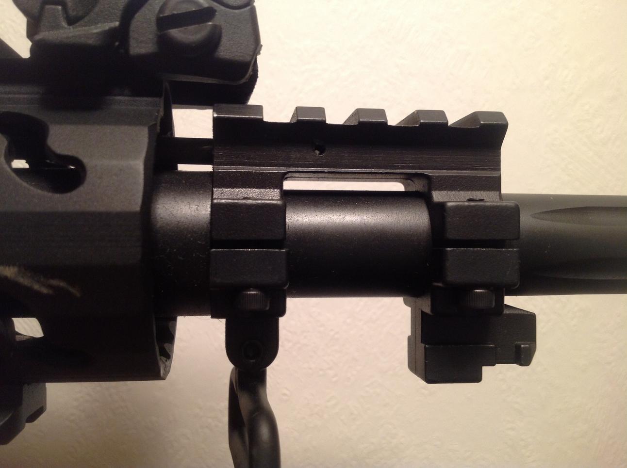

    I just got my Black Rain Ordinance 308 back today. It was its second trip back to them for warranty. It had a problem ejecting the spend round from the chamber. The first trip they replaced the Bolt and extractor arm. This trip back they replaced the whole BC and bolt. Apparently the bolt carrier had a defect. They had to spin it on a lathe to see the problem with the factory BC. The just shot case and the fresh bullet would jam up. So basically a stove pipe. So they replaced it with a JP low mass (LMOS) BC and enhanced JP bolt. I don't think it has a adjustable gas block. It is my understanding in order to get the benefits of this BC I need to have a adjustable block. Here are some pics. image.jpgimage.jpgimage.jpg

    Ref the JP LoMass BCG, if it feeds reliably then you probably don't need the adjustable gas block. If it doesn't eject cleanly then your bolt speed is probably to fast. On mine, i jad to dial down the gas AND add weight to get it to function reliably with a suppressor. Unsuppressed it worked without the extra weight as long as I had the gas dialed back.
    The BRO rifles/carbines I have seen have all been notoriously overgassed which caused problems with the standard weight BCG, so I would imagine that using the low mass setup from JP will only complicate the problems...BUT...you won't know until you get out a shoot the thing. If you experience issues, you can always get one of the less expensive adjustable blocks like the Kies that can be had for ~$45 or so, slap it on and then get the rifle running before you dump any more cash into the hole you already find yourself buried in. ;)
