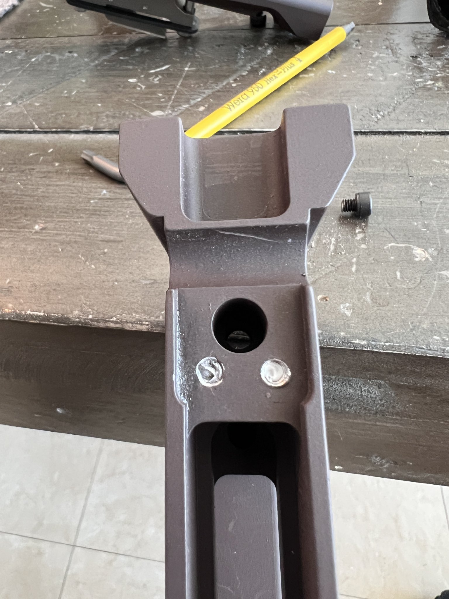

Don’t ask how. One broke going in. Other coming out but I’m not very happy.
Any very fast very good business for screw extraction services?
ADCO has some brutal turn around times for something I’ve already been waiting months to complete.

I will say, if you have access to the correct equipment, spot or centre drill, carbide drill, and easy-out, or retap it once drilled.
If you are really lucky, often when you drill it, you get a nice little coil you can pull out with pliers / grips. You MUST set it up and drill it dead nuts centre.

Iceng is correct. The only other item I would look at once they are out is the threads in the part. Something is going on there, either with the screws or the thread dims in the hole. Regardless I would take a serious look at chasing th threads with a quality tap. By quality I mean something other than hardware store Irwin brand crap. A spiral flute bottoming tap would be good.
Reactions: MarinePMI
I was wondering about the loctite too. If it was loctite I would still chase it to remove the residue, but that's just me. I want those threads as clean as possible before I ran another screw down a hole that I had to drill a screw out of.
100% be chasing that thread regardless, because it a broken bolt occured in it, it may habe been a 6mm bolt in a 1/4 unf hole. Fun times. Those suckers go in like 3 turns easily before they even start to resist.
Its on its way to d wilson. The extractor is really jammed in there and don’t want to trash my ATX or make this worse than it currently is. Got it back from a cerakote job and feel like the paint may have gummed up the threads.
