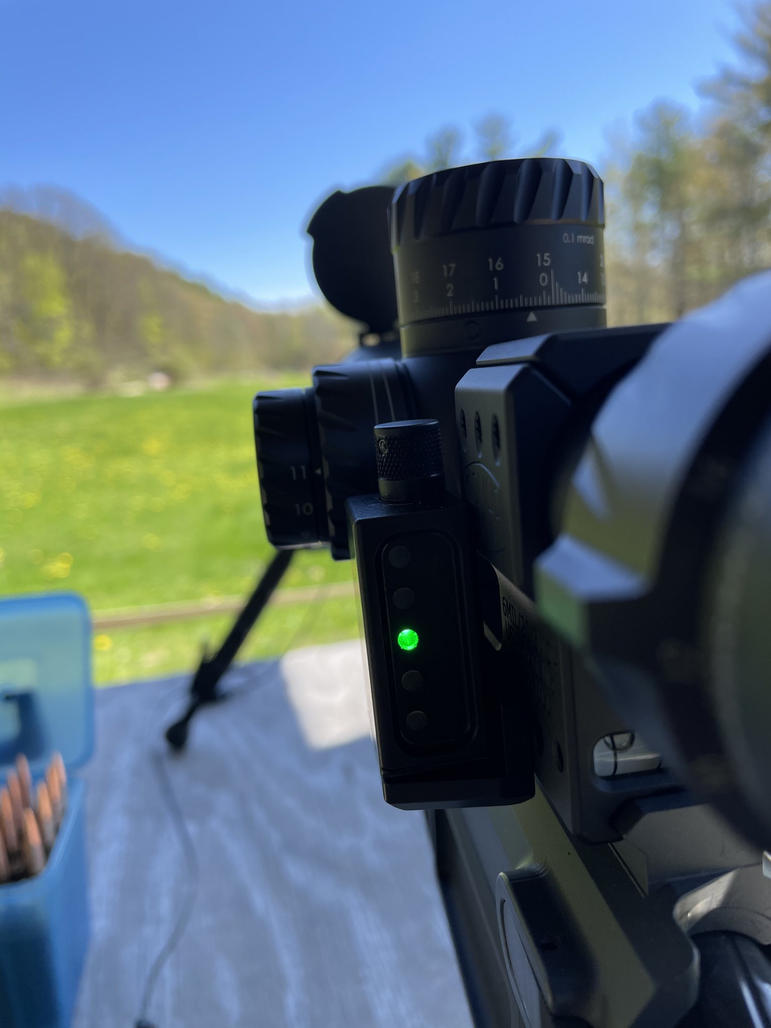

Did you ever try hanging the Sendit vertically?
That’s how I mount mine as I agree that horizontally it sticks out a good ways.

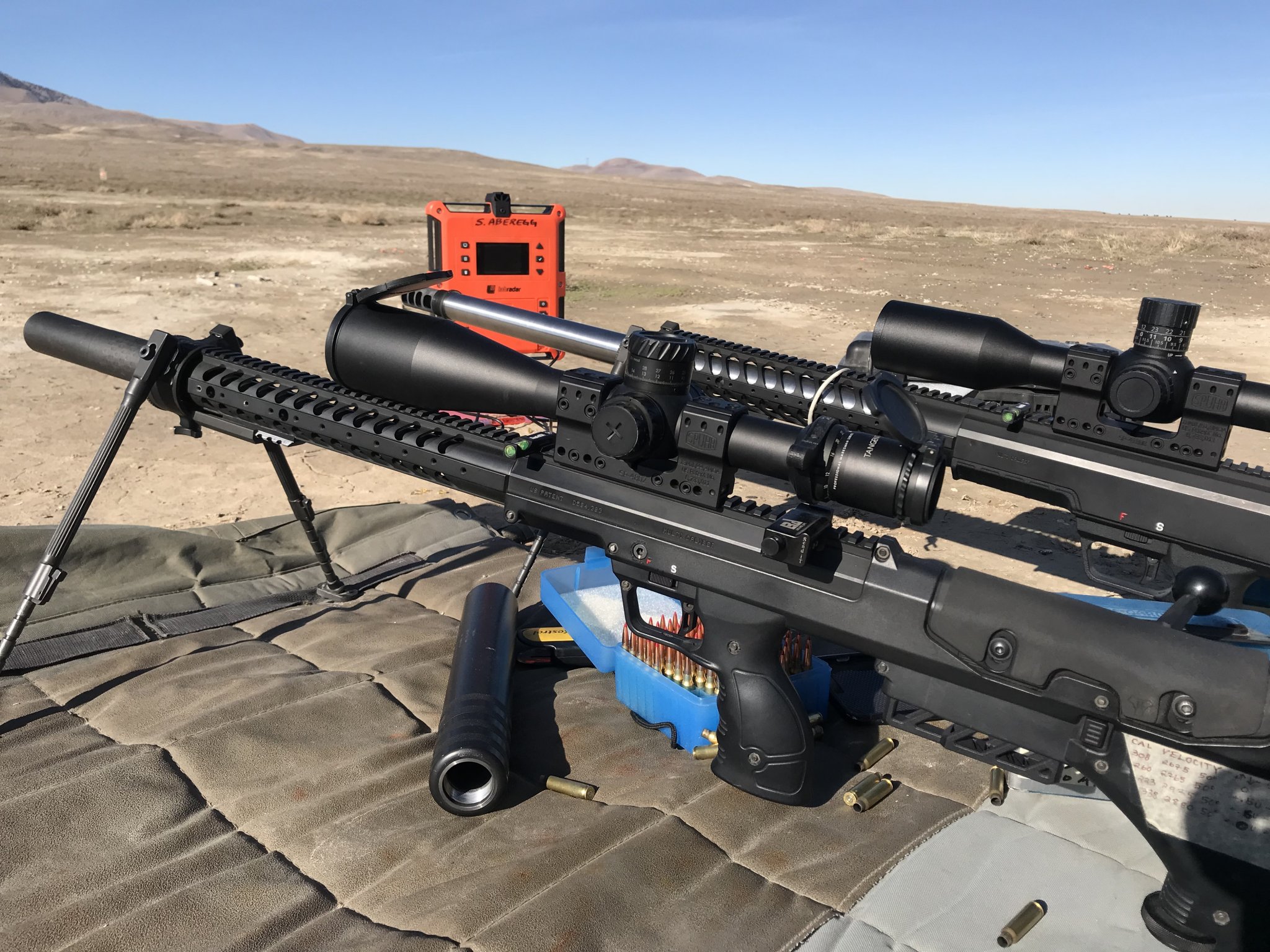

Did someone say vertical? Sendit vertical is the way to go! Notice the Spuhr bubble is off? Verified w 2 Sendits and a bubble level on top of scope turret.

Did someone say vertical? Sendit vertical is the way to go! Notice the Spuhr bubble is off? Verified w 2 Sendits and a bubble level on top of scope turret. View attachment 8025619
The turret caps are not a reliable measure of the crosshairs. If you check the crosshairs on a distant Plumb line, you square the scope, and then level the Spuhr out to correspond to the vertical crosshairs, as checked by a plumb line. After all, you had to zero that send it level. So you’ve just compensated in the way you set it up and the reference that you’re using, the top of the scope cap, could be off. If I were truly interested in perfect level, I would never do that. I would use a plumb line and make the levels correspond to the crosshairs as the ultimate reference with the plumb line
If I had the set up that you have pictured above, I would have first leveled the spur bubble and locked the bipod. I would have then rotated the scope in the mount until it was level on a plumb line, so that the Spuhr bubble corresponded to perfectly vertical crosshairs based on the plumb-line reference, and I would have ignored the top of the scope cap. Then I would’ve locked it down and checked it. Then I would’ve put on the send it, and re-leveled the send-it to correspond to the spur bubble AND the crosshairs on a plumb line. I think that you are building in errors based on assumptions. I would not do it that way if I were concerned with perfect level.

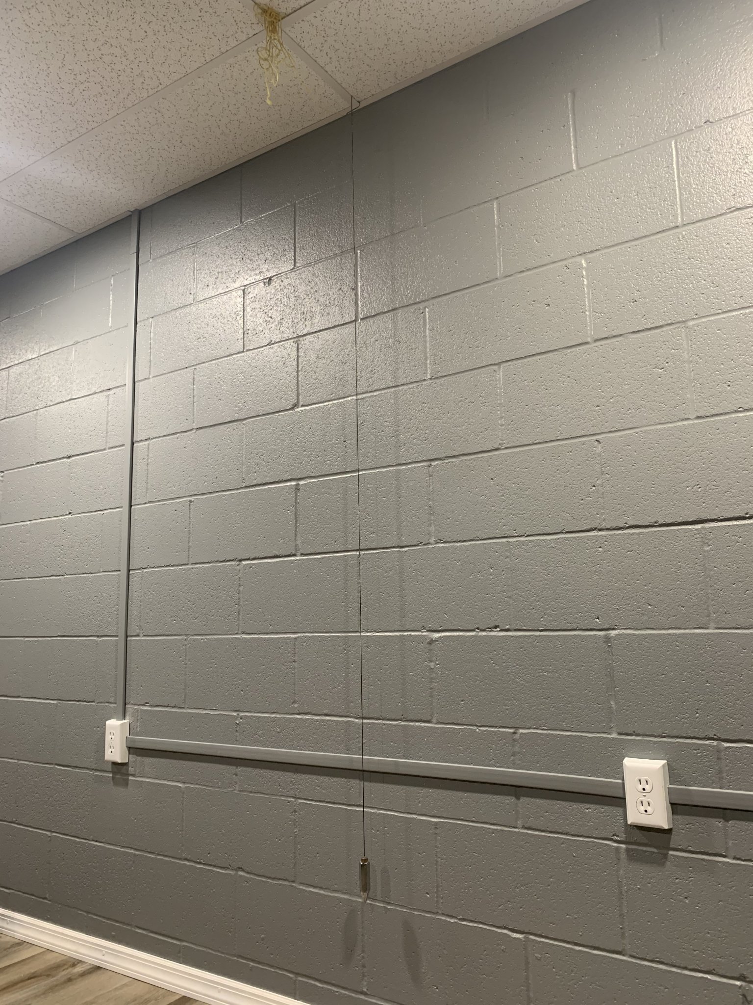

I used a plumb bob to snap and then draw a line on the shop wall.

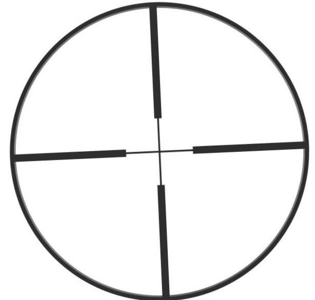

It's much more important that your reticle is plumb to gravity than the scope being level to the rail. I use the plumb line to set up my level so I can always make sure the rifle is level.
The erector and elevation/windage is parallel to the body of the scope regardless if the reticle is canted inside the scope.
This picture is canted but the elevation acts the same as when you scroll the this picture up or down.
Reactions: BCX
^complete horse shit.
Scrolling up moves both the crosshairs and the reference point. For this simple minded and incorrect analogy to be correct, you would need to hold the screen constant and move the erector parallel to the vertical crosshair. Which would move it north west and off plane in relation to the center of the screen

So...as in previous posts, I use a 4' level THIS ONE placed on the quality pic rail I have previously mounted properly with either blue loctite or some lacquer (nail polish) and level the rifle from left to right in my pattern makers vice THIS ONE.
Then I use quality rings and place the scope on the pic rail. Rings just loose enough to rotate the scope. I shine a flashlight into the scope from the objective end (the end closest to the bore). It will project an image of the reticle through the ocular lens. I tape that flashlight to the barrel shining back at me, basically.
At this point, you can do a couple of different things but all rely on the use of a true plumb (true vertical) line. The only truly reliable vertical is found with a plumb bob. What I did was use a plumb bob and marked a vertical line on the shop wall near where my pattern makers vice is. This saves me from having to rig up the plumb bob every time I want to set up a scope for me or someone else.
I shine that reticle at that plumb line, but just barely off it and rotate the scope until I have parallel lines, the vertical reticle line and the plumb line on my shop wall. If I try to shine it right on the plumb line, I can be off a little and not realize it. By shooting the line just off, I can easily eyeball parallel, or I can OCD that shit and use a scale (ruler).

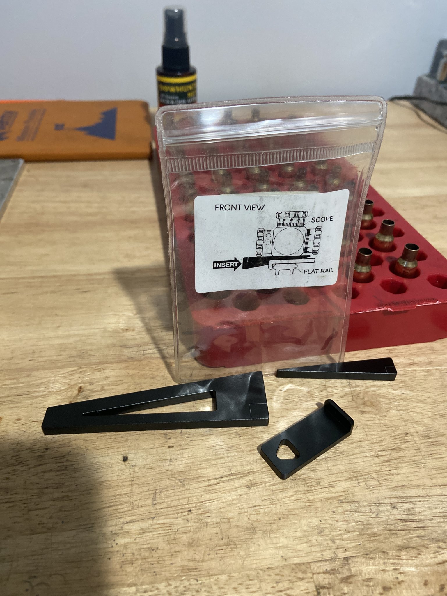

EDIT: I recently bought the ARISAKA wedges and those are the shit. My own OCD still makes me check shit with the plumb line. I think the wedges are the way to go if you for some reason have to mount out in the field. If you are real careful, I think you can get an excellent "parallel or level" scope mount with those wedges.
