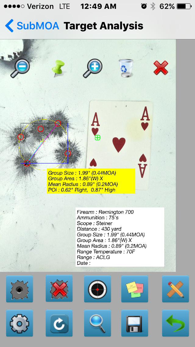

My trainer Factory Rem 700 20" sps .223. Has a tac sport pro same as my comp rifle. Here's 5 @ 430 using 75 bthp. Plenty good enough for positional practice
