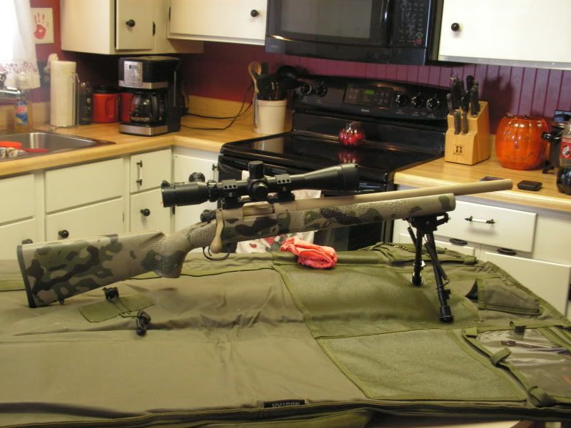

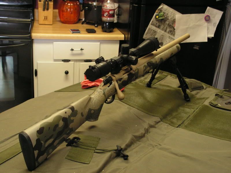

I have been wanting a long range stick for quite some time. I have not had the spare cash, or the spousal approval to do what I wanted, up until now.
I have been stockpiling parts for about three years. I had an old 700SPS 308 that had been occupying my closet. I ran across a new PSS takeoff barrel for $70.00, so, that went in the closet. About six months ago, a few of the guys at work did some swapping, and I wound up with an HS PSS stock for nothing...thats what really got the ball rolling.
I have a friend who is getting his smith business off the ground, and I volunteered to be his guinea pig in this project. I had him shorten the PSS barrel to 18", and put it on the SPS action.
I textured, multicam'd and bedded the stock. I am not 100% happy with the paintjob, but I think the next one will be acceptable. I also threaded the bolt handle, and installed a Callahan knob from Midway. Another guy at work shot the barreled action with KG Gunkote, Desert Tan. Again, not 100% happy with the color, but it will make a good base for a multicam job on the barrel and action as well.
Back in the summer, I had bought a dead four wheeler, and rebuilt the engine. I recently sold it for a pretty tidy profit, and used the proceeds to fund my optics. I found an IOR 2.5-10x SFP Illuminated on the Sample List. After much gnashing of teeth and lost sleep, I picked that up. SWFA also had a Ken Farrell Zero-G 0MOA base for the right price. I put the scope in a set of SWFAs Super Sniper rings, and for the money they are quite nice. All in all, SWFA went above and beyond the call, and they have made a customer for life.

What would I change? The Farrell base is tall. Very tall. Even with low rings, its still a tall combination. I dont want to ditch the base, so I think I will just use a cheekrest, and deal with it.
Thought some of yall might enjoy seeing how a broke, 30-something small town cop builds a rifle, while paying bills, kid's dance and doctors, and life in general. No credit cards were used, everything is paid for. Total bill for this rifle, as it sits, is just a hair over $1300.
