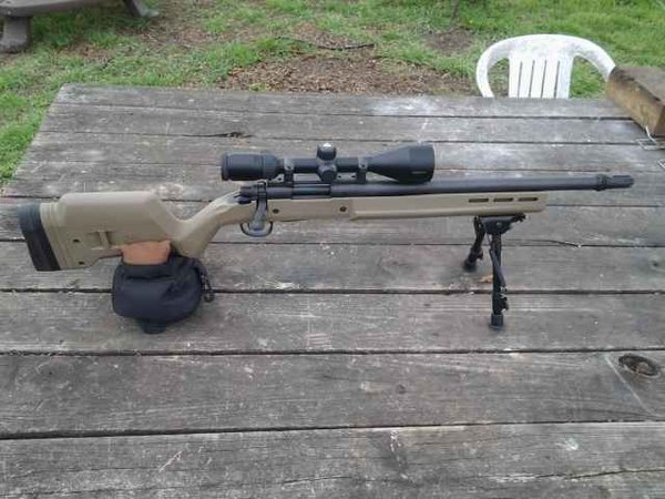

    The rem 16.5 heavy barrel has good clearance 300 blk i can meashure diameter monday if you want
