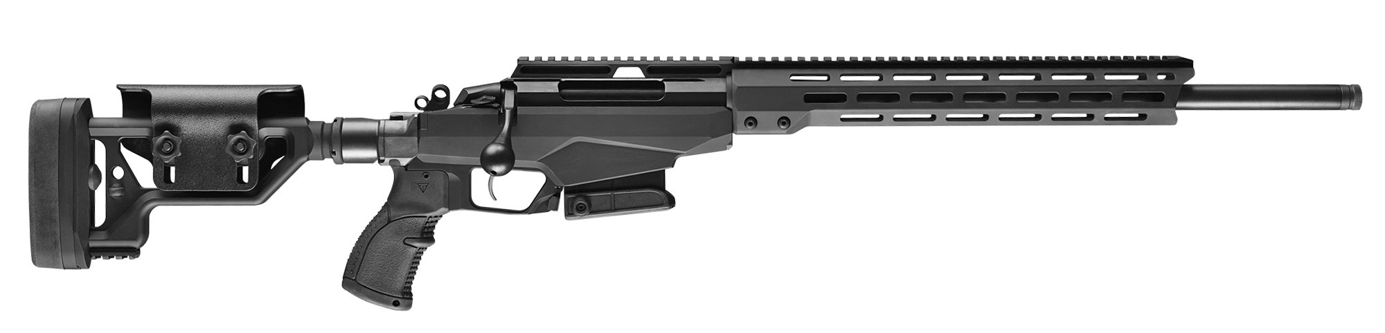

- Tikka makes a number of models that would fall within your price range, and you get what is likely the second most aftermarket options.
Both of the above would fall into your price range and would be great rifles that you'd hold onto for quite some time.
Looks like Europtic has a Tikka CTR in .308 for just over the $1k mark. I don't have any personal experience with Tikka but everyone here has positive comments about them.

I would take a serious look at a Tikka T3X.
It may be the best out-of-the-box rifle for your job right now. They are reliable, consistent and accurate enough. Easy to maintain. Plenty of other agencies running them so precedence is established.
Get the 20" Tikka. If you plan on mounting a suppressor, get the 16". DO NOT get the 16" if you will not run suppressed. DO NOT plan on putting a muzzle brake on the rifle. If you do, run a blast shield over it or purchase a Troy Claymore style brake.
It comes with a fully adjustable stock and I would guess that the Tikka series are currently the second most supported rifles with the second most aftermarket parts available behind R700 pattern guns.
