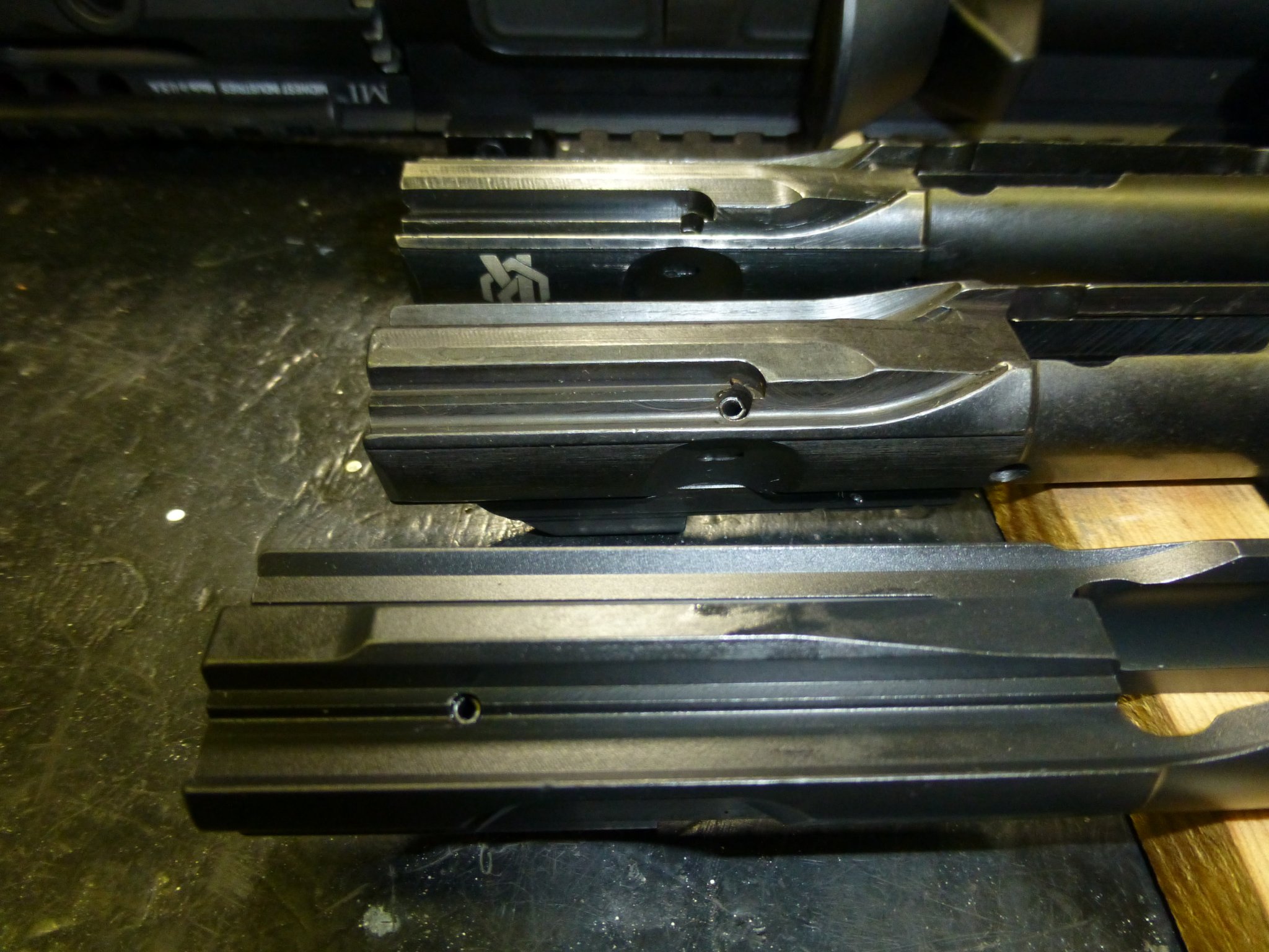

Also ... how long is the "ramp" on your bolt ? In other words, is the ramp length not allowing the hammer to re cock fully ?
Pic from the internet... to show ramp lengths. Kudos to whomever's pic that is
