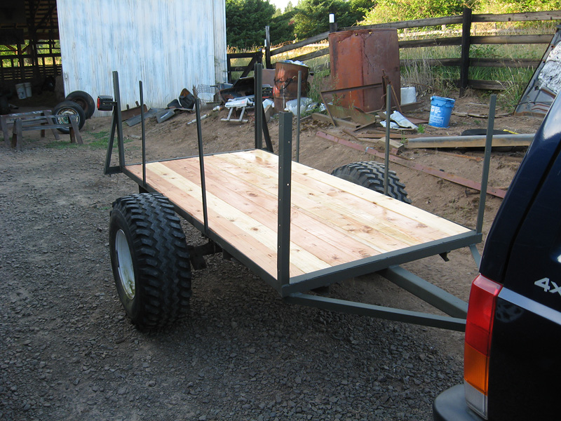

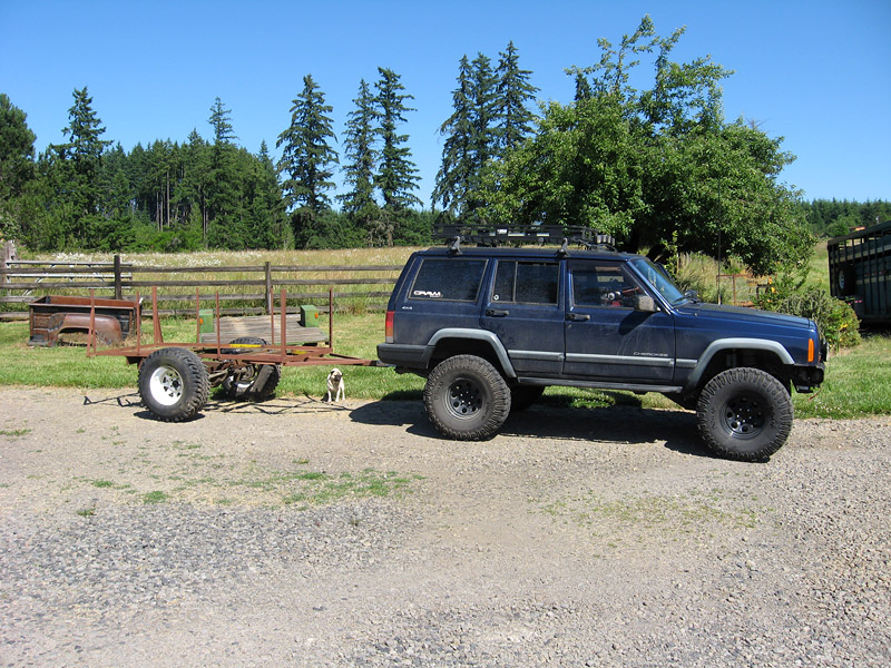

Finally found a use for a Dana 35. Put it under my little trailer.
When shit hits the fan and I head to the hills to let society thin itself out this little trailer should go anywhere the Jeep can drag it with the needed supplies to kick back and watch the world unfold.
I have a pair of matching Trxus tires going on it with the same soft 8 wheels plus a spare that will be mounted up for either the Jeep or trailer. Still trying to decide paint color and such.
The Jeep is your basic Cherokee with 4.56 gears, lockers front and rear, Rubicon Express suspension, Bilstein resevoir shocks, 1 ton steering setup, HID lighting, etc. etc.

Did you salvage the trailer and modify it, or fab it yourself with a vehicle axle?

Its an old work trailer that has been sitting around for like 10 years. I just cut off a few things and made a little better. Swapped out the axle for a spare axle to match the tire/wheel/bolt patter on my Jeep. Basically just making it a little more stout. I've got less than $50 into everything right now. Existing trailer, Dana 35 axles are free everywhere, old tires from the Jeep, just a couple grinding discs and a couple cans of paint so far. Just gonna deck it with something basic and probably paint the whole thing OD.

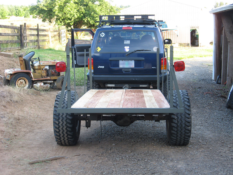

The axle under the trailer is a Dana 35 from a cherokee. I tossed around finding an 8.25 to throw under it so that I would have spare parts to fit the rig in an emergency but didn't want to spend the time/money finding one when the D35 was free. If I build another one utilizing what I learn from this project it will have a matching axle. For now if it gets real bad the D35 should bolt right under my rig, just not sure if the driveshaft would be long enough. I do have extra shafts for the front that I want to find an ammo can or something for so I can keep them in there. They are complete shafts with the hubs and everything. 3 bolts and they come right out.

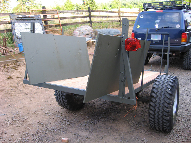

Well, spent all day today workin on it and made some progress. Doesn't look like much but I did a lot of cutting, welding, changing, etc. today.
Got the whole thing cleaned up, more primer, then lots of olive drab. 2x6's were coated with Thompson's water seal on all sides before putting them on. Layed it on pretty heavy and let it all soak in. Its the stuff with UV protection and such.
Couldn't decide what to do with the tail lights so just threw some mounts up high for now to keep me out of tickets. I have some ideas using different lights but these will work for now. Also threw another coat of water seal on the deck after on the trailer.
The deck has no screws/bolts holding it down. I boxed the front of the boards in with flat steel. After all the boards were in I did the same in the rear using several small stitch welds. If I need to replace a board I just have to grind a few welds to get the boards out. I also added a channel upright on the back for a removable gate. Basically a piece of plywood that will slide into place. I am going to finish wiring the lights in the morning then take it to the hardware store for some plywood/paint and finish the sides. Going to use a 2x4 along the bottom and then plywood up.

Is that all for the sides? Do you have any plans for the construction?

Took the trailer to home depot today to get more supplies. It pulls nicely. Aside from going up big hills I don't even feel it back there.
Picked up some plywood and 2x6's for the sides. Gonna be a 2x6 on the bottom and then 24" of plywood above that, all around. Just got done cutting them all to fit. Also welded on a couple more little brackets to help support things as well as a safety chain for a more permanent setup.
Tomorrow I am going to try and paint all the boards with the OD paint I had home depot mix up. Once they are all painted will start mounting them, hopefully this project is done by mid week or so. Would be finished tomorrow but that dang work thing starts again.

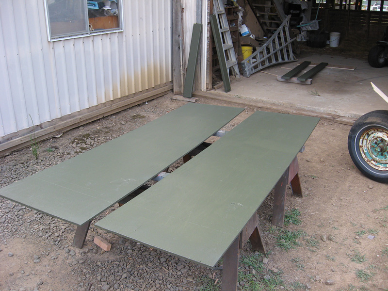

Not much of an update but got the sides all painted. It's just BEHR flat exterior paint from Home Depot. They didn't have a color called olive drab so I took the lid from a can of Krylon camo and matched it the closest I could find, going a little darker when in doubt. Turns out the color "Wild Rice" right off their shelf is what I wanted. 3 heavy coats on all sides of all the boards.
Still kind of wet in the pics.
