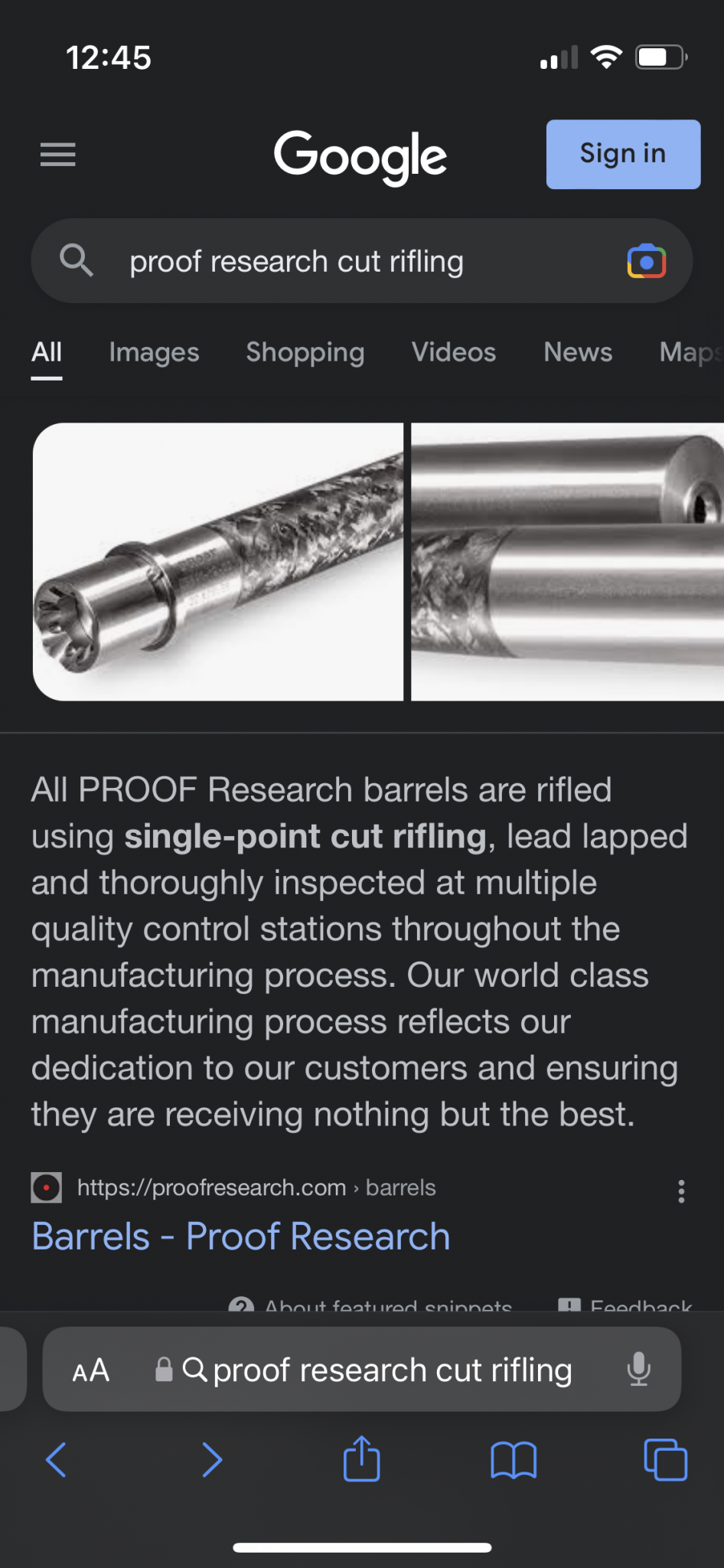

Ok thanks. Are the proof research barrels
All cut rifled?
All cut rifled?
Ok, if you’re gonna blast people for not being helpful (which did make me chuckle), you better be prepared to pull your weight on the self-directed research. Just my two cents.
Yea , literally after I asked you that question , I googled it and found out for myself. So yea basically just initiating small talk

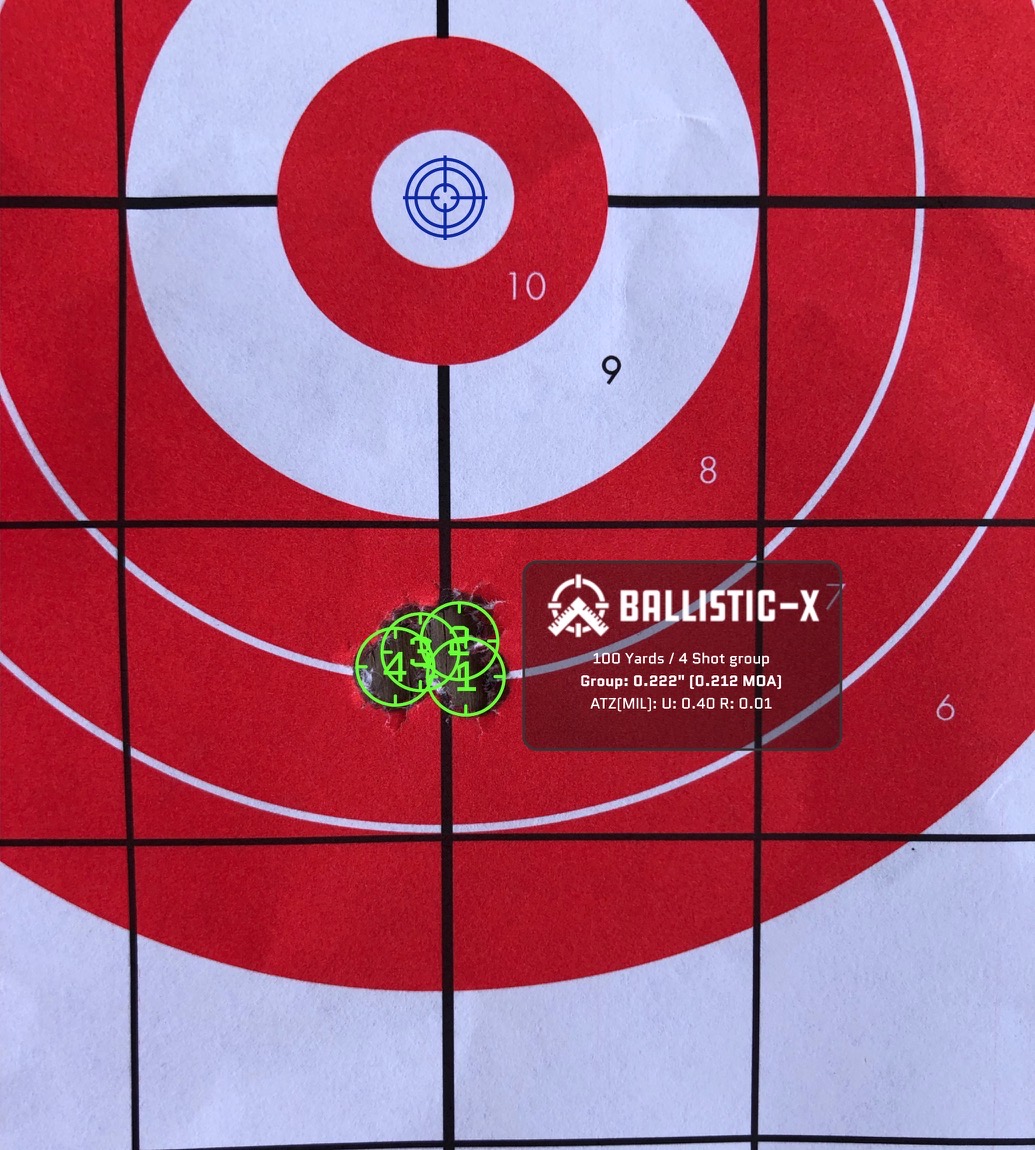

I'm into my 2nd Proof pre-fit for Bighorn and both have been beyond my expectations. So much so I have a 3rd one already ordered from Owen at @Front Range Precision sitting in back of reloading closet. Buddy @Mike Casselton showed me how to swap barrels....actually he did it all, but I'll do the next one...so stupidly simple. I picked mine up when they were sub $500 to my door which still may be the case.....so there's my worthless .015 cents.
I'm not much of a paper puncher/load dev guy as my shooting pals will attest I like to hear 'pew.....tingggggggg' a lot. When I took my 2nd Proof out to pop the cherry I bOaR ciTeD off a target at 100 and just swung out to 800 pronto to let a small pressure test batch go and then started running my exact same batch of Lapua brass from other barrel with bullet at hard jam. Used combat offset/Kentucky windage of about .5mils each rest of day b/c I'm that lazy when I want to shoot steel.
At the end of the day I had 4 bullets left and my buddy Mike said good grief stop being stupid throw some on paper and fix zero stop why don't ya. Needed to tweak windage/elevation a smidge anyway, but this is what an unbroken in Proof with 50 rounds, still yet to speed up completely shot with a smoking hot barrel which MIke and I have been known to do.....on a weekly basis. This is an exceptional group for me I'm the last guy out of our group for shooting best paper groups. Probably best group I've ever shot....hence why I keep pic on phone to prove to myself it was probably a fluke given my usual paper performance. I had a buddy measure it with his app and I think he was quite generous with the edges of the group so don't know that's quite measured that small, but it's still well within my 'i'll take it' zone. I'm sold on Proof. End of campfire songs.
Ballistic-X-Export-2022-10-30 16:13:23.334205.JPEG
