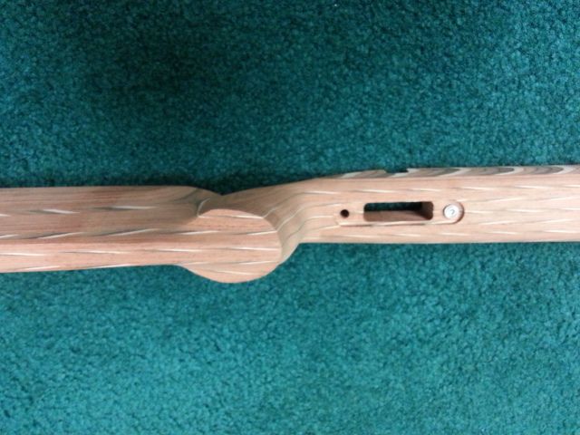

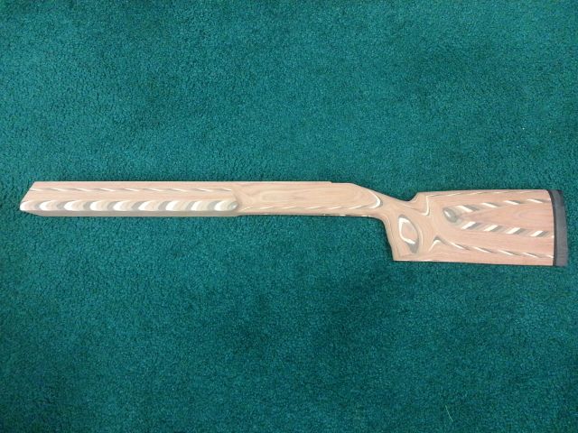

Quick update. Got the Shehane Tracker MBR back from Bill Shehane, fully inletted. Next step, Pure Tung Oil finish before I send it to Greg Tannel for chambering / pillar bedding / barrel crown and thread. (Gun will wear a VAIS brake - allowed in IBS comps.)

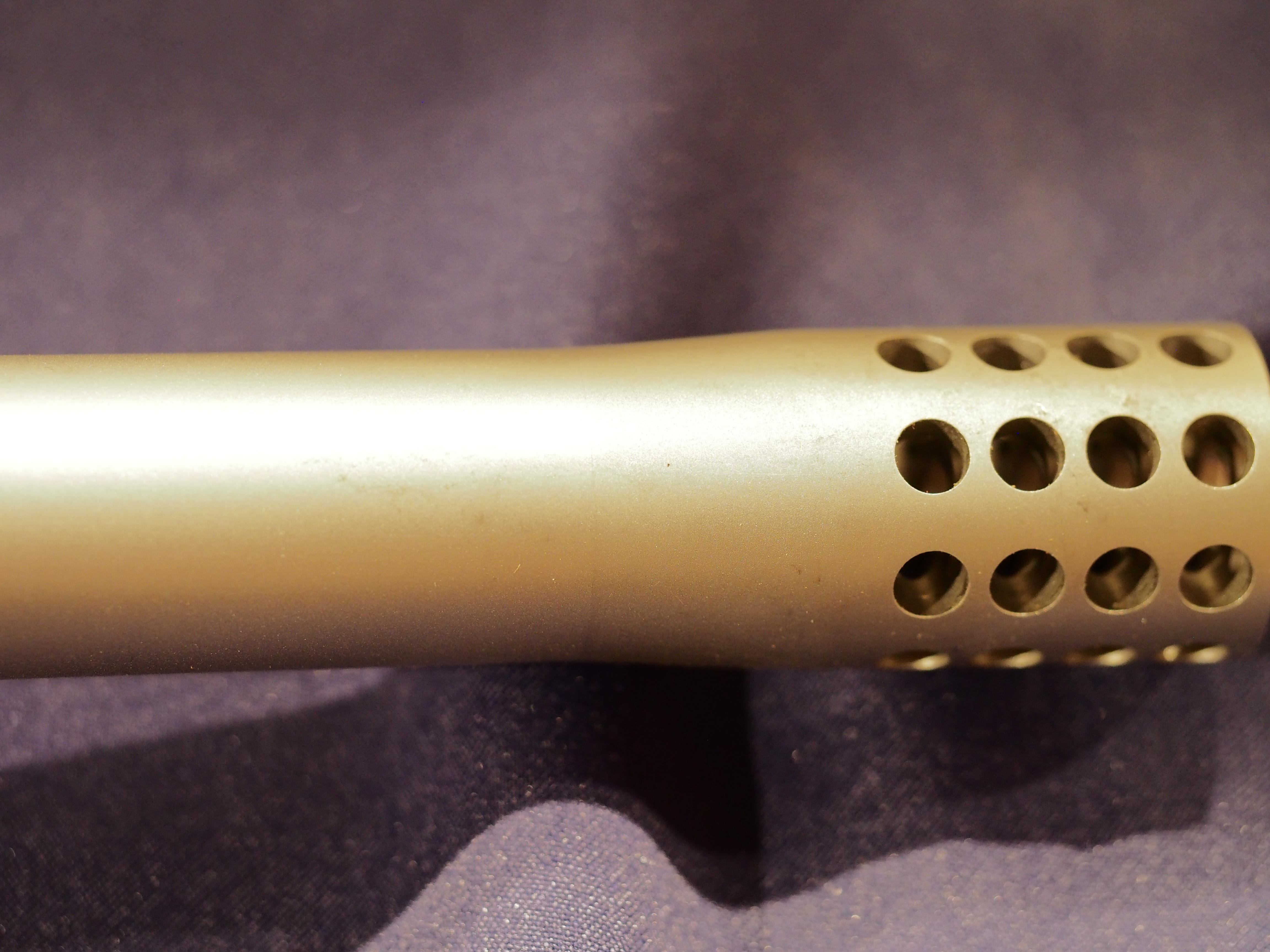

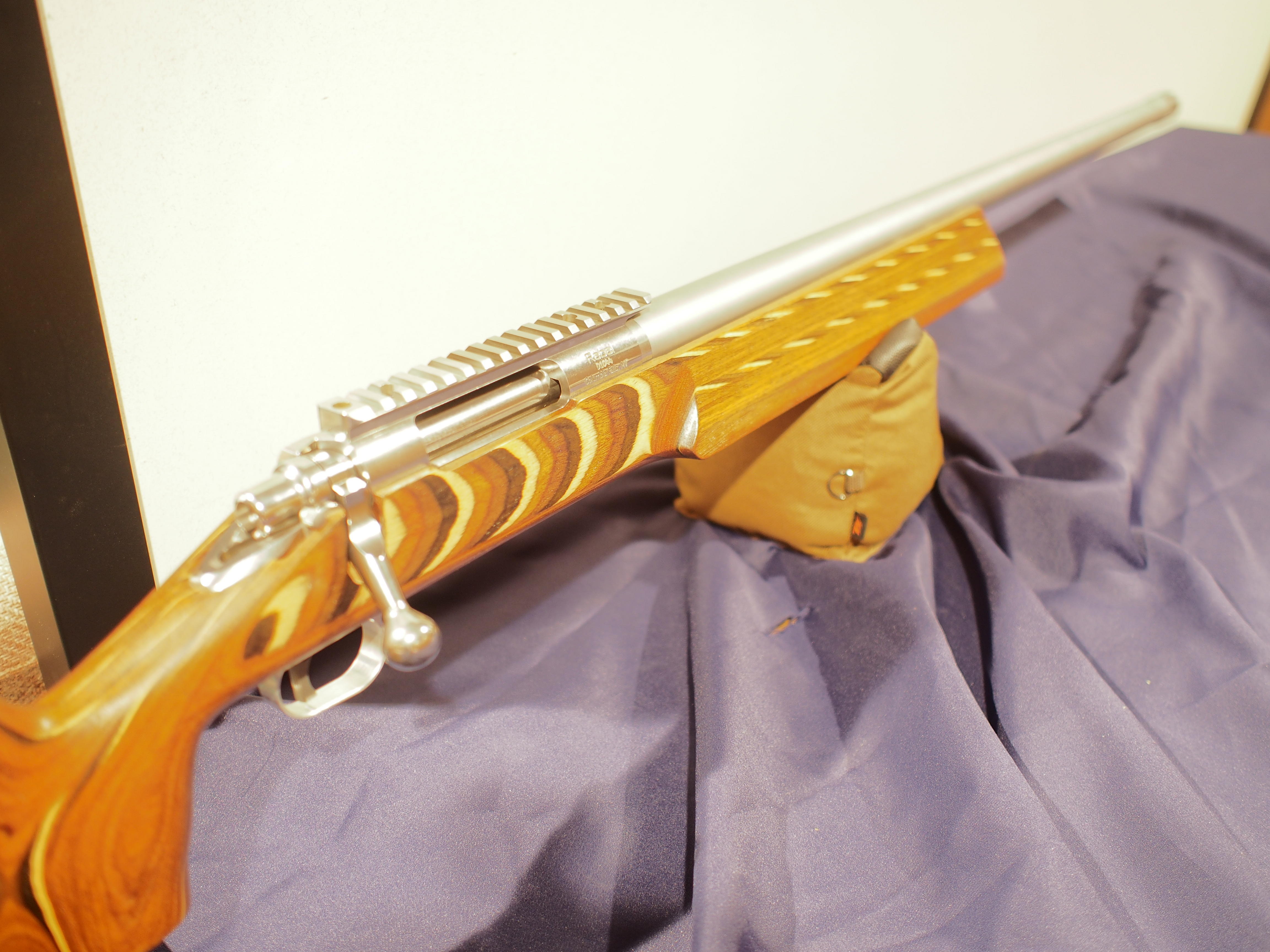

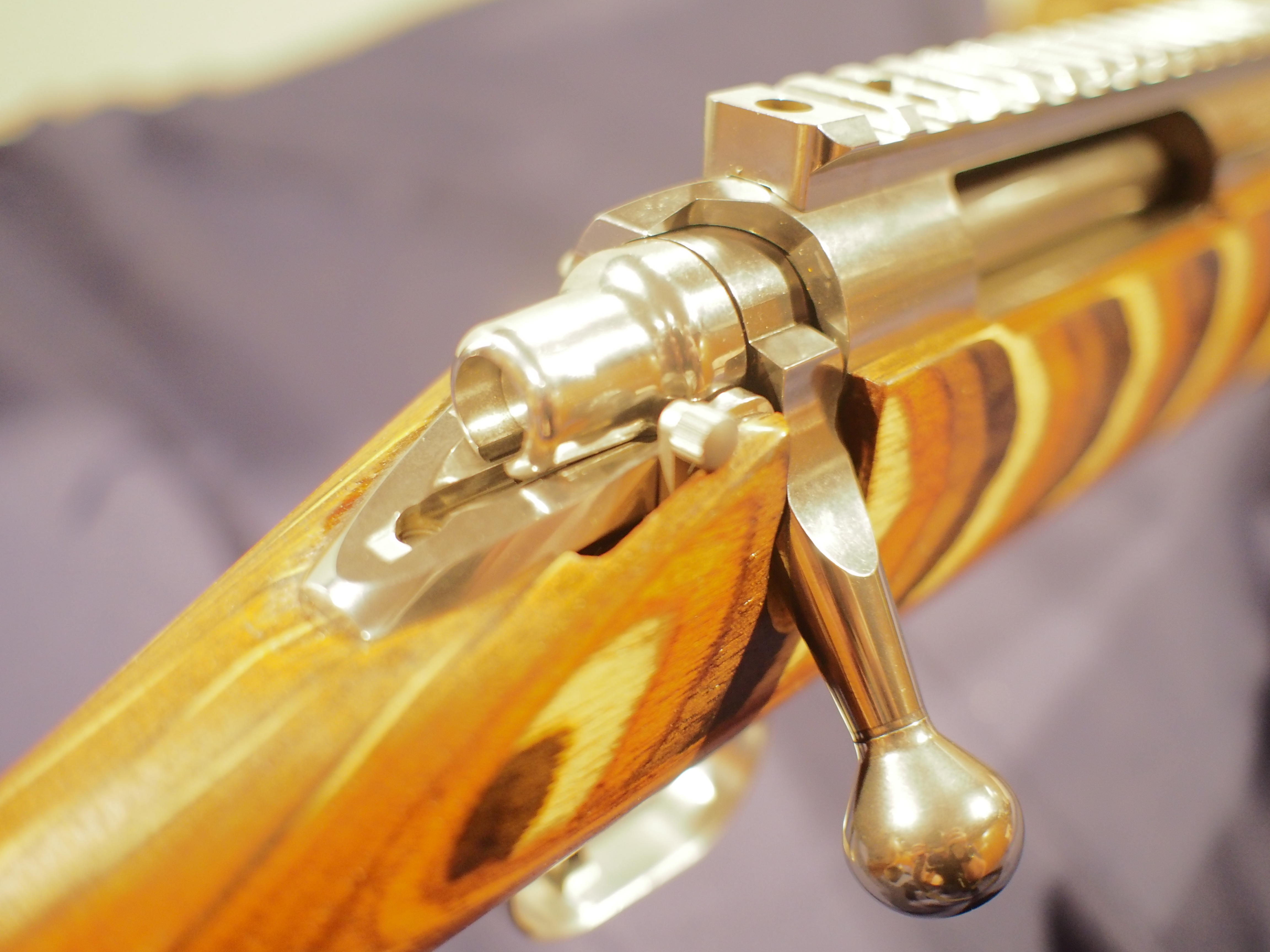

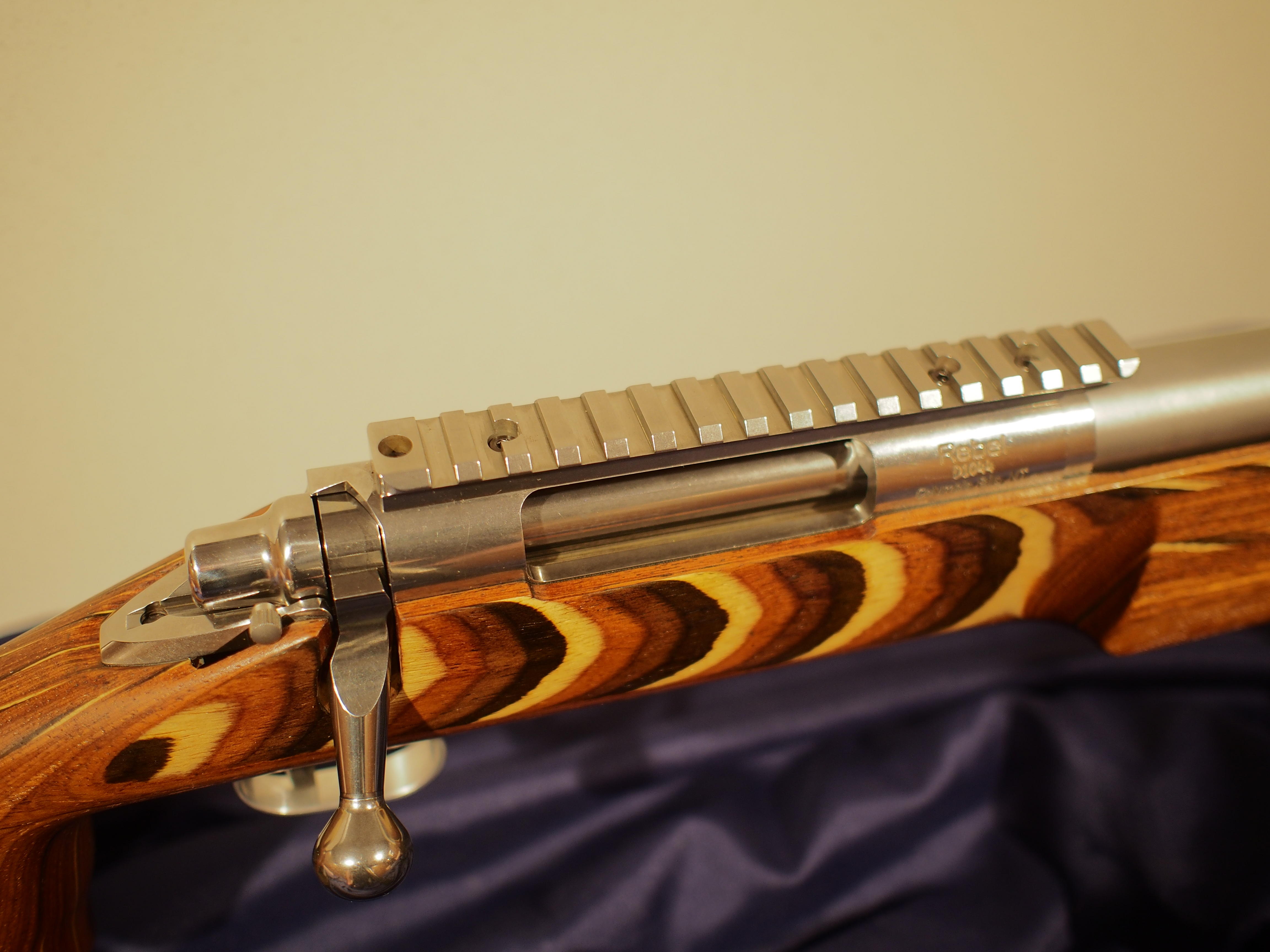

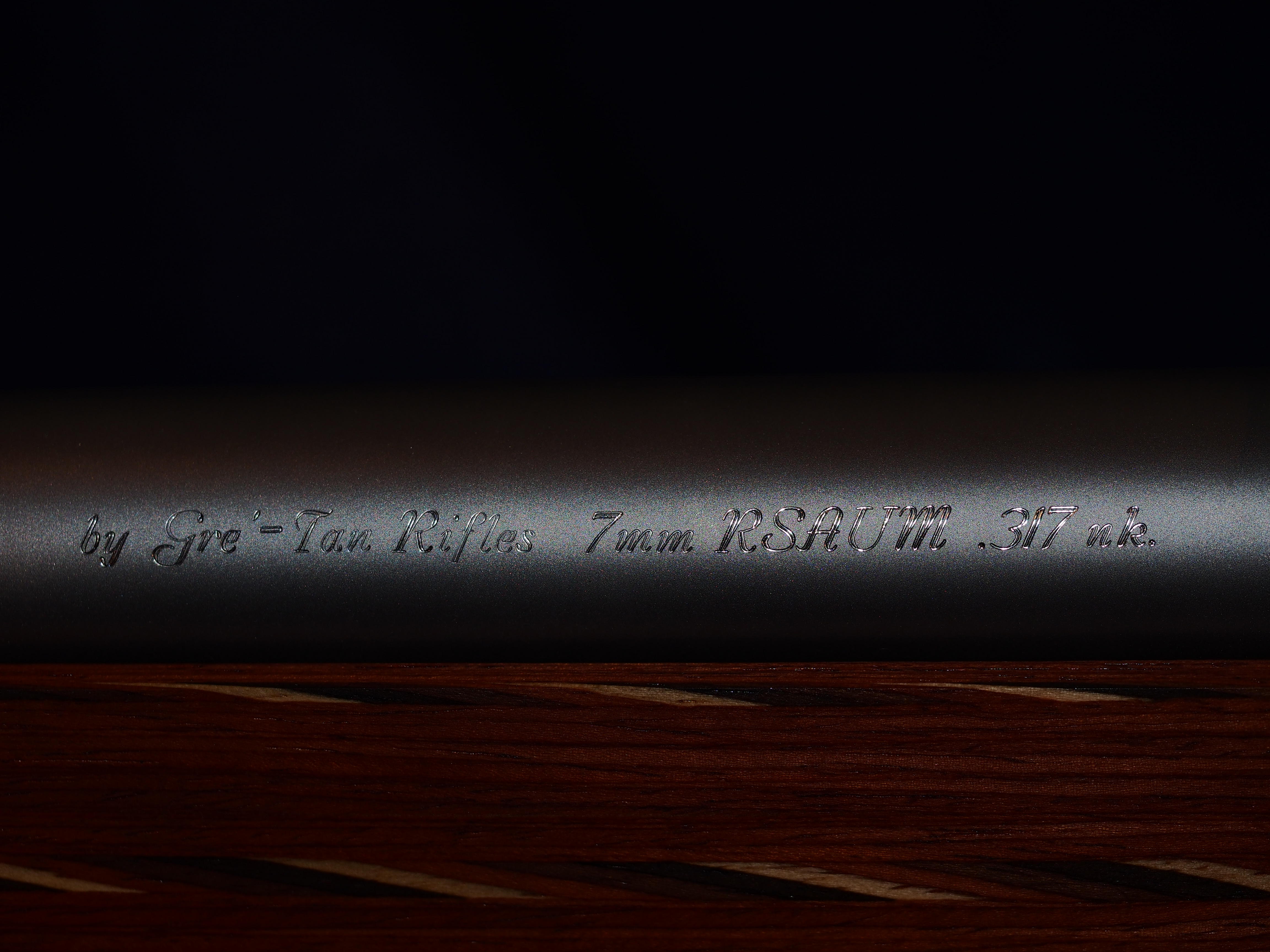

Well, the completed gun is now in my possession. This was a long road, and I have yet to shoot the gun, but I thought I'd post some (crappy) pictures of a nice gun.
