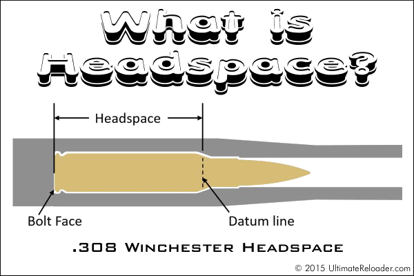

To have a proper fitting chamber you need to control how deep or shallow it is screwed into the action. Screw it in too far (short) and the ammo physically wont fit, dont screw it in far enough (long) and it can result in poor accuracy, brass growth, possibly dangerous if bad enough.
7050463
So for proper headspacing you need to screw the barrel into the action the proper amount.

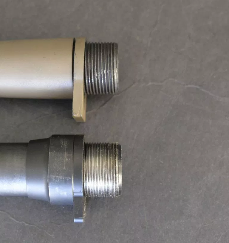

A shouldered barrel will measure the distance from the bolt face and cut the barrels shoulder material to the correct location so that it can simply be torqued on and you are good to go.
A barrel nut version forgoes cutting that shoulder exactly right and instead allows you to use a barrel nut (jam nut essentially) to hold the barrl in the correct location. To know how far to screw it in you use a headsapce go gauge (depth control spacer essentially), you insert it into the chamber and screw the barrel until you hit that gauge. Once you do that you know the barrel is correctly located and you tighten down the barrel nut to lock it in its location.
Pics from https://rifleshooter.com/2016/03/remington-700-versus-savage-10110-comparative-design-notes/
This shows a shouldered barrel up top and a barrel nut version down below. Both use a recoil lug to interface between the barreled action and the stock.
7050461

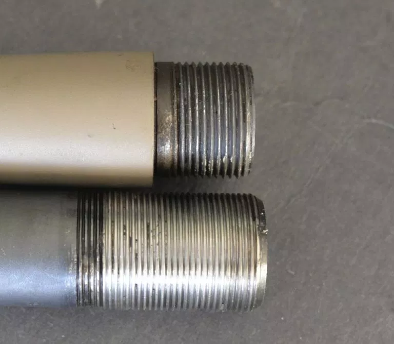

Here it is without the recoil lug and barrel nut.
7050466
For a stock remington or other low end action the actions vary enough that you cant just cut a shouldered barrel, you need precise measurements so that when the barrrel is screwed in it stops in the perfect location. For some actions like the mausingfield (im pretty sure) you mentioned, or plenty of other high dollar actions that are manufactured consistently enough so that you can have that cut shoulder correctly sight unseen.
