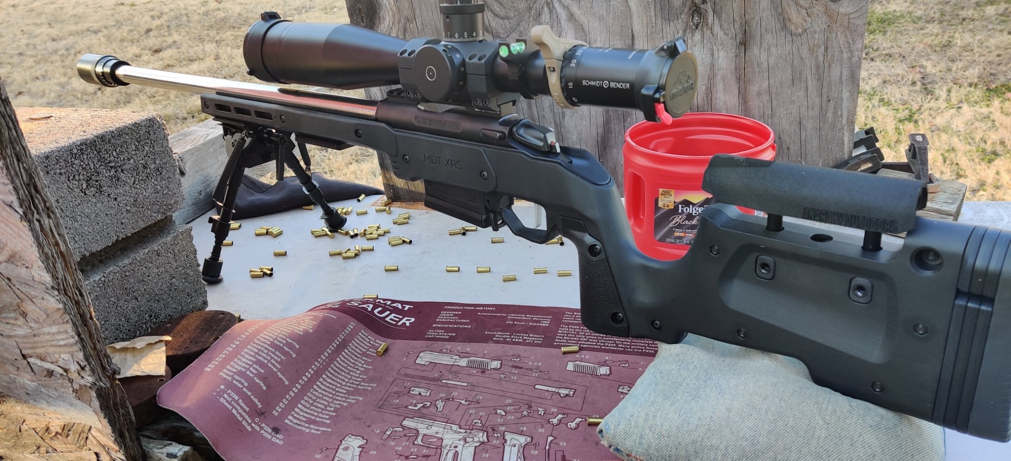

    I am enjoying my Bergara B14R more than any rifle I own and I have a couple of Premier Bergara's. I would keep my B14R as a loaner for matches or backup. I was initially looking into the Vudoo when I found the Bergara. Now that I have gotten back into the Hyde from Years away ( Shooting as well ) I see the RemX being discussed as well as a couple of people I shoot with. This is a build I don't mind it taking me a complete year or longer to do as I would buy an action quick and have it in the safe ready to go. Thanks in advance.
    1. Is there a Reason other than pre built to choose Vudoo over RemX?
    2. Is it possible for me to build a RemX with a pre fit barrel and such at my house shop?
    I believe I have all the tools needed accept Go, No Go Gauges.
    3. Is there a preferred company with better actions on the RemX Platform?

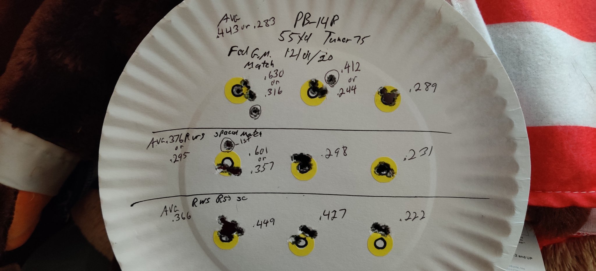

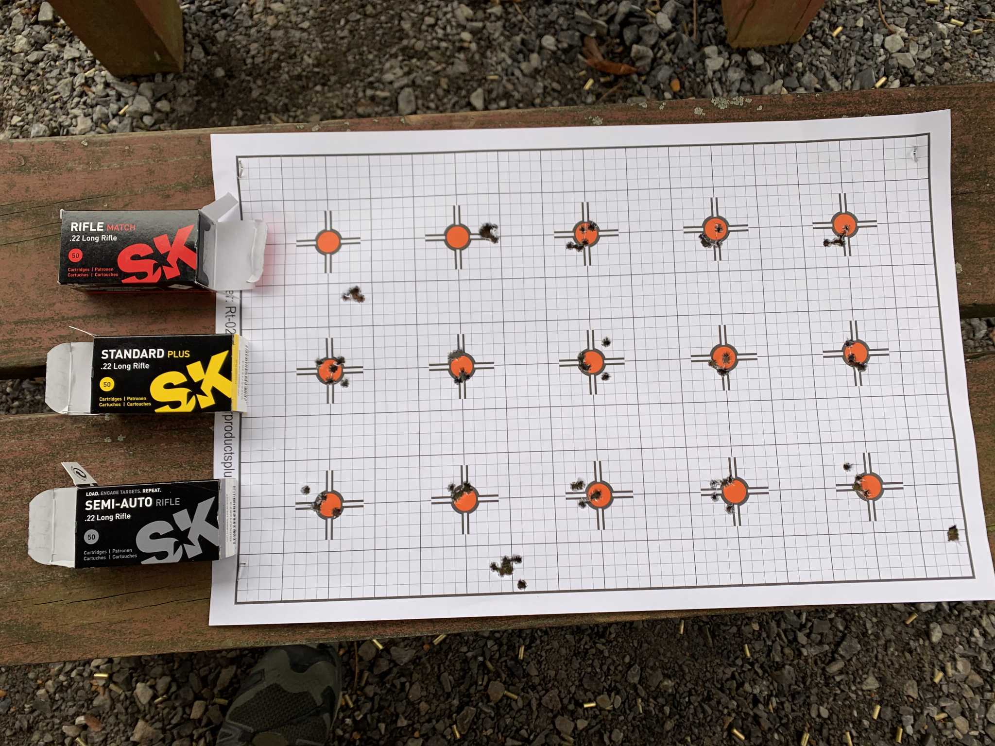

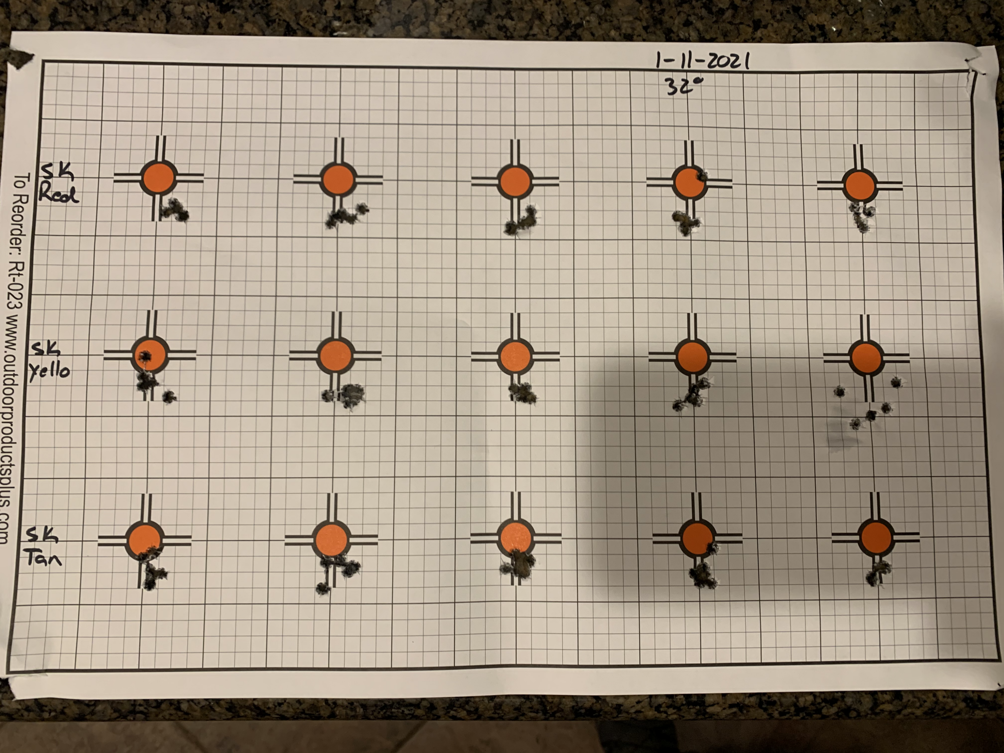

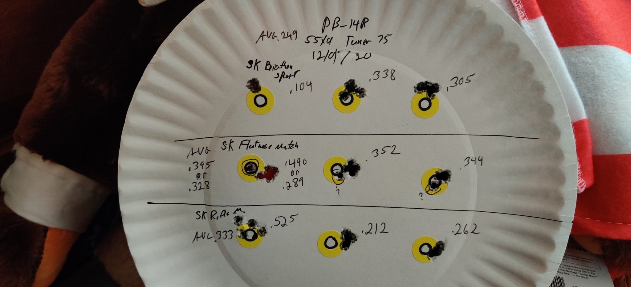

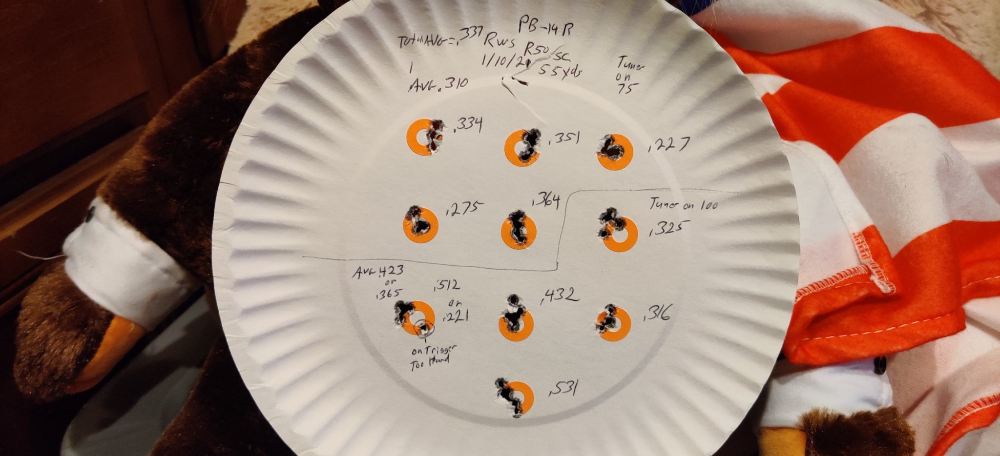

    If you are really happy with your B-14R you could do like I did and send it to Mark Penrod for a rebarrel. My PB-14R "as I call it" is the most consistent rifle I have. It is also on par with smooth feeding like my Anschutz's are. This B-14R is has perfect feeding and ejection. If you have questions just ask. It really didn't shine until I put the tuner on.
    I shot this target yesterday. Brought it out and started shooting from a cold bore. No first round flyers.
