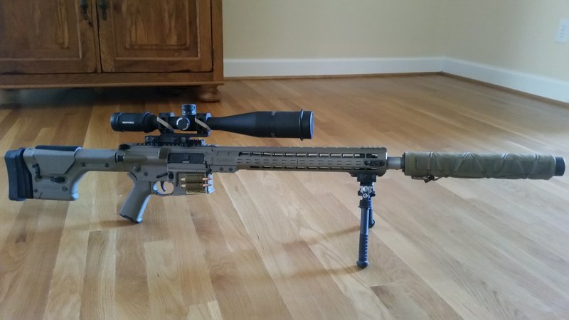

I disagree. I run a Superlative under my 15" Armalite Competition KeyMod handguard just fine. I am running a 20" barrel with a 12" long can (7" past the muzzle) on it, but you can barely see the gas block under the handguard. At $199, it's a very reasonable piece of gear.
