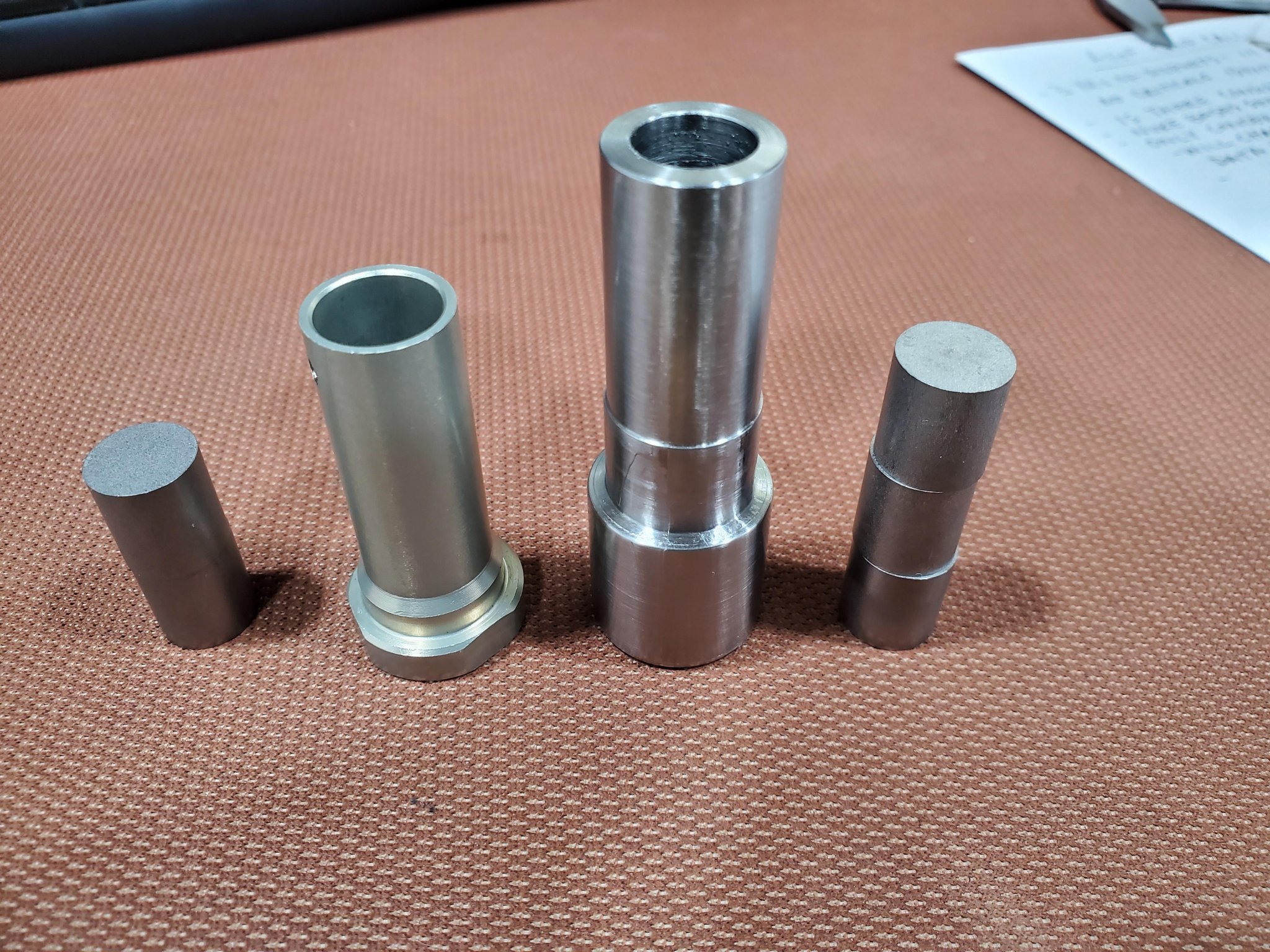

I hear you, popped some primers with my 45 Raptor carbine build - the light weight of the standard LR308 carbine buffer and spring can't adequately control BCG cycling at the motivation of a 300 grain load. To resolve that, I was working on my own "Heavy Buffer" on the lathe last night. Making it to fit the extended A5 carbine buffer tube (Vltor, BCM, or Magpul UBR). With three tungsten weights inside it should come it at around 10 oz - more than enough to tame the recoil of the 45 Raptor.
Thats a great idea! Nice looking machining as well.

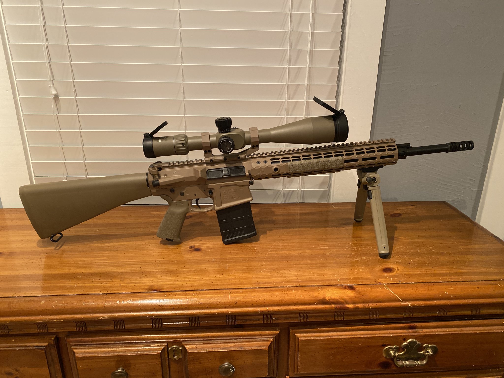

Here's mine I built a while back. She's a shooter! Spend your money on a good BCG, Barrel, and Trigger. That's my 2 cents.
Oh, and get a good adjustable gas block.
Wow nice rifle. What optic are you running on it and what gas block did you get?
That is a very cheap Monstrum 6-24. I may upgrade the optic eventually but for now it certainly does fine for me. I’m sure the rifle is more talented than I am. The gas block is the Aero adjustable block. It only took a few rounds to dial in proper cycling. Other than the A2 style stock and Magpul grip and bipod, the rifle is entirely Aero.
