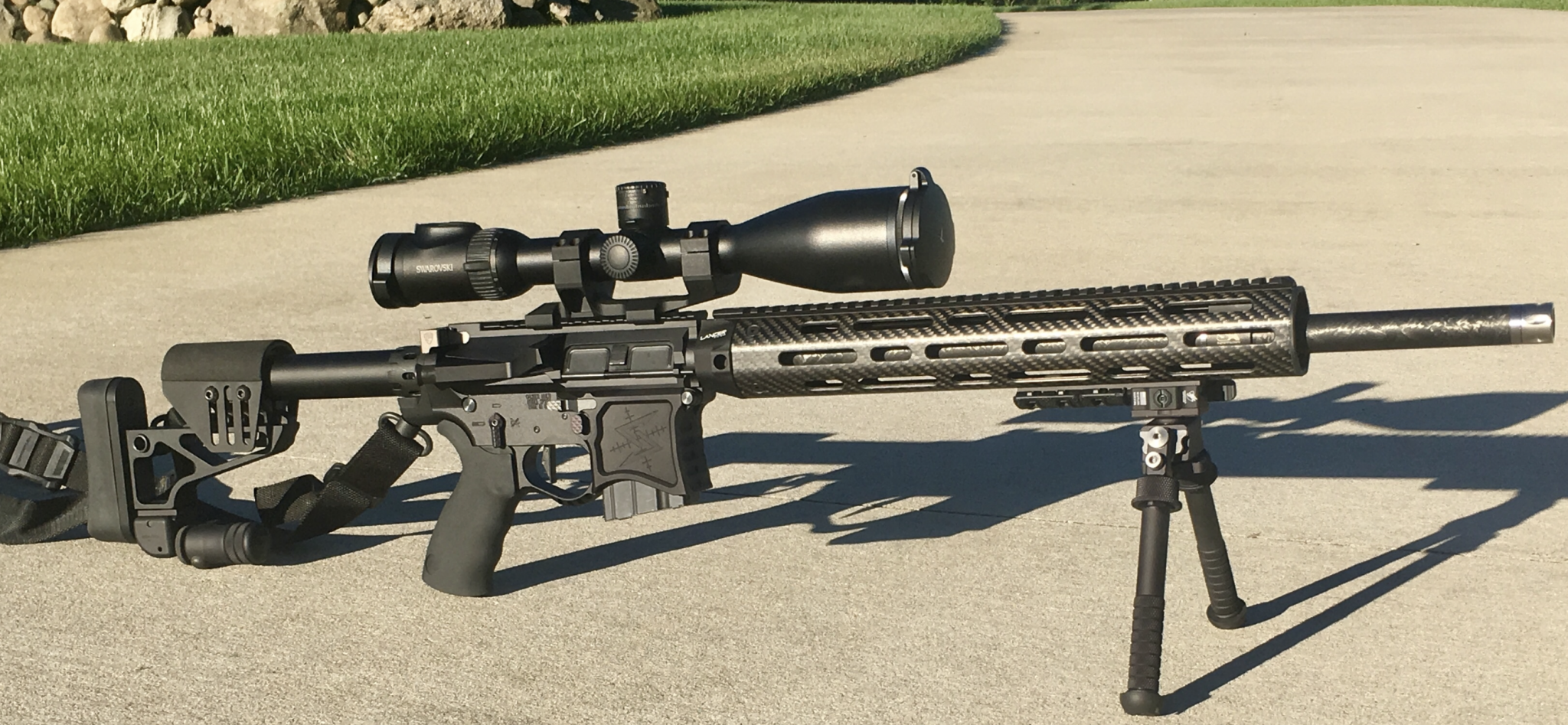

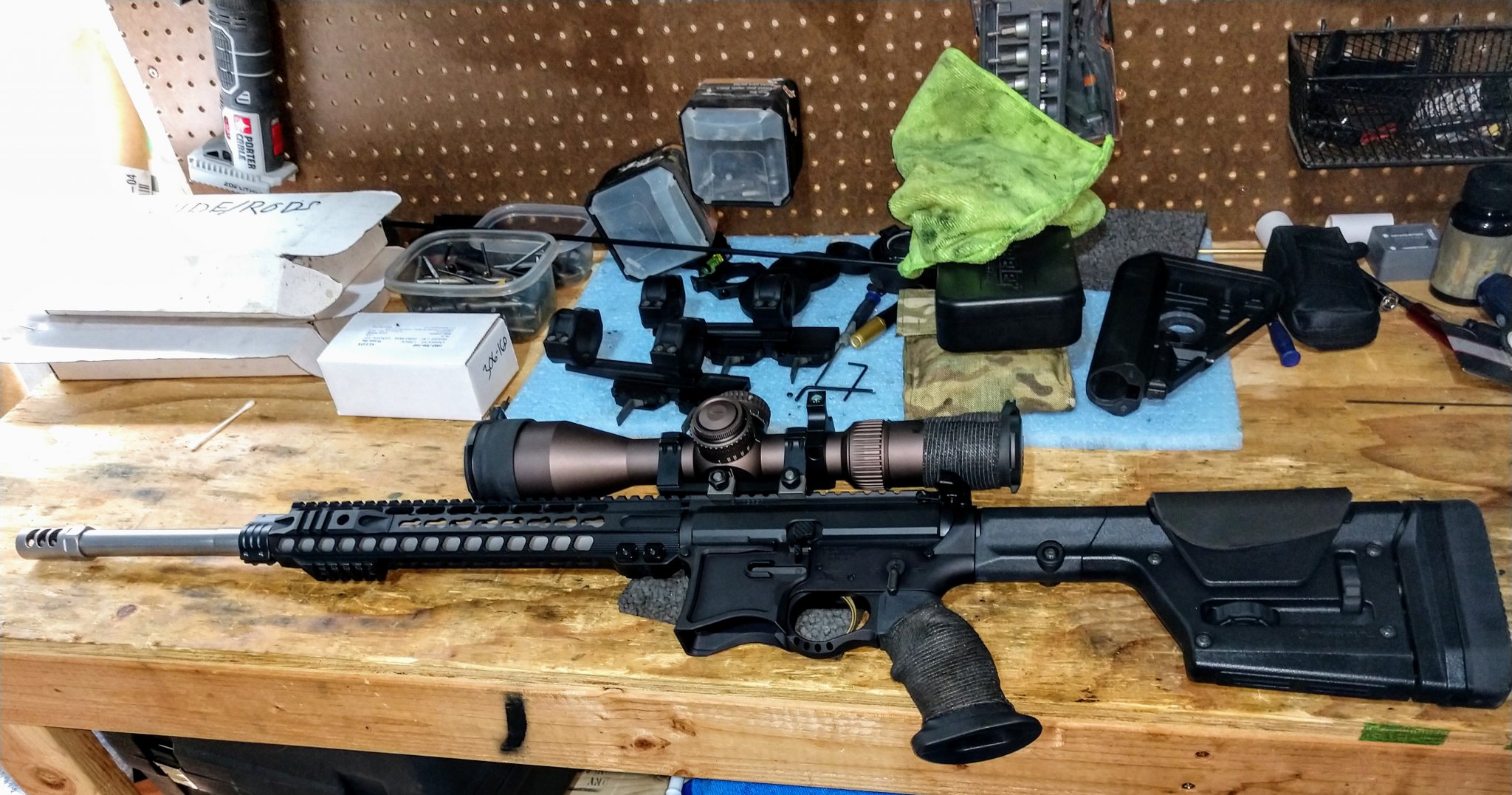

How’s the balance with that G2 razor? That much weight up top makes me nervous. At the peacemaker DMR match, a guy had one on his rifle. He had to set it down on a table mid stage to transition to pistol. Big heavy scope like that and setting down on the clock did not go well together. Entire rifle toppled off bench, round in chamber. Luckily it stayed pointed in the right direction and didn’t go off but that was still a match DQ.
It balances really well but this gun is for benchrest and shooting from the prone recreationally, if I were to use it for competition I'd probably throw on the AMG.

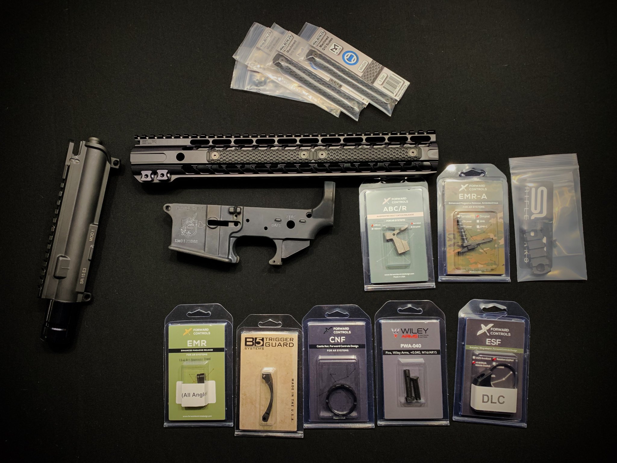

I was wondering how these receivers would handle a very heavy barrel...
I emailed CLE this morning to get their opinion on the receivers. If they recommend a stouter billet set, that gives me a reason to do a little parts trading with another of my rifles.
I’ll pull the handguard, barrel and trigger out of this one, throw the CLE barrel and a different handguard on these seekins receivers, and throw the hsnm trigger (or tt diamond, whichever I decide on) in it, and swap optics.
I’ll then throw the proof 6.5 Grendel barrel on the KAC receivers along with the z8i from above, transfer the SDE trigger over, and set that up as my deer/ yote rig. Either way, all of the parts below along with the XLR stock I just ordered will be going to Blown Deadline Customs for a black/gray/OD multicam cerakote job.
