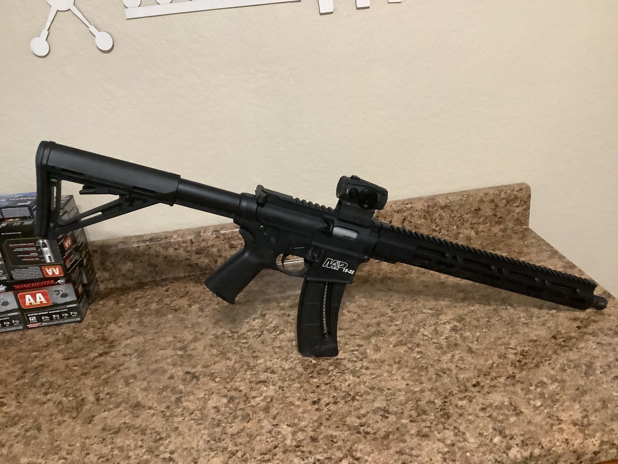

Here is one that I built but it has a dedicated upper with a 10" Clint Beyer barrel. Could have almost bought 5 15-22's for what I have in this.

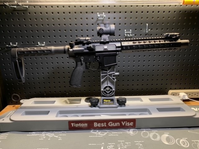

All in all, I am pretty happy. Here’s what I ended up with.
10” Keystone Barrel, thermal fitted to a BCM upper
CMMG Bolt/Magazine combo
12” Coda Evolution handguard
Gemtech GM22 can
NightForce 2.5-20x overkill scope
And it shows promise grouping.
Thanks again to those who offered help.
