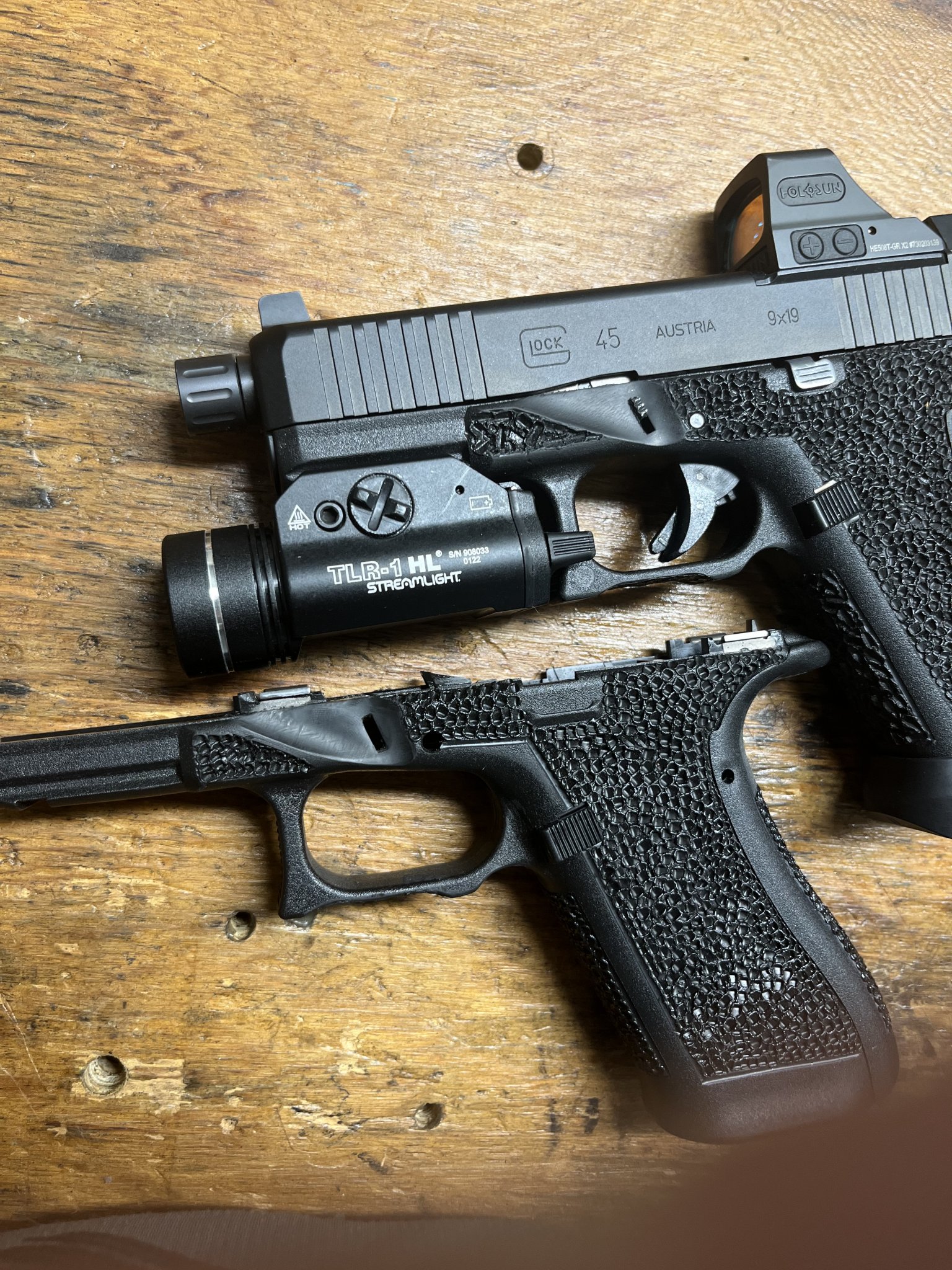

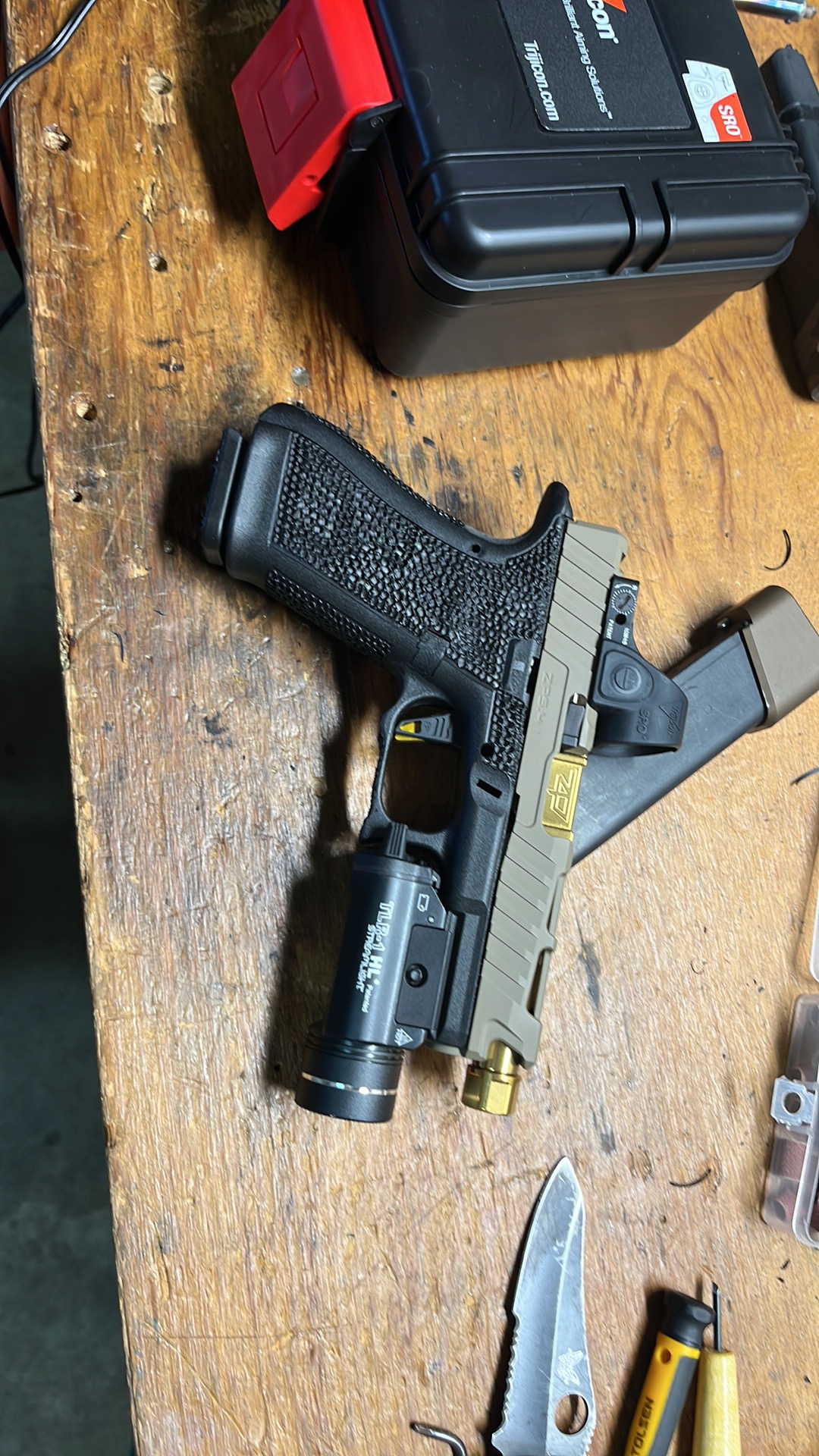

    Having been down this road multiple times…. A stock G34 or g17 or a G45 my new favorite ❤️ with an optic and a magwell will do you just fine.
    I would recommend keeping it stock inside.
    Get a ranger proof trigger shoe for it
    And it’ll go bang everytime
    You start putting comps on. lightening rods and springs and triggers and you start having ammo and light strike issues
    Just my 2 cents.
