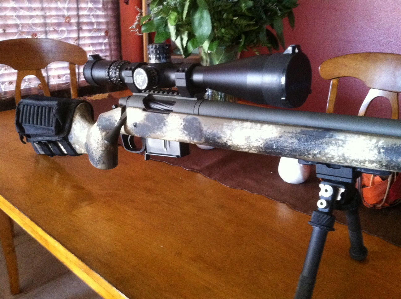

To me personally I like the weight of a little heavier barrel espically in the bigger calibers. I have been hiking on mule deer hunts is some pretty extreme stuff and thats where a good pack comes in. I like to stay around a sendero contour or standard palma contour in kreiger barrels which is like a .820 or so at the muzzle. Here is my coyote rig in a Manners T2 with mini chasis. It has a kreiger standard palma at 24 inches chambered in a .243. Prolly around the 12 lb mark I would think.
